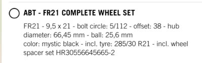

Also I red that 295 maybe not bad, I have spacers on my current wheels it’s 15mm spacers all around, will add photos, my current wheel bolts are 42mm length.
Will it be safe to use 295 won’t it going to rub arches or 285 better to go?

I had 295s on the audi 21 x 9.5 wheels, 15mm spacers on the back and they rubbed going over bumps etc

Thanks, so better I stick to 285 then
