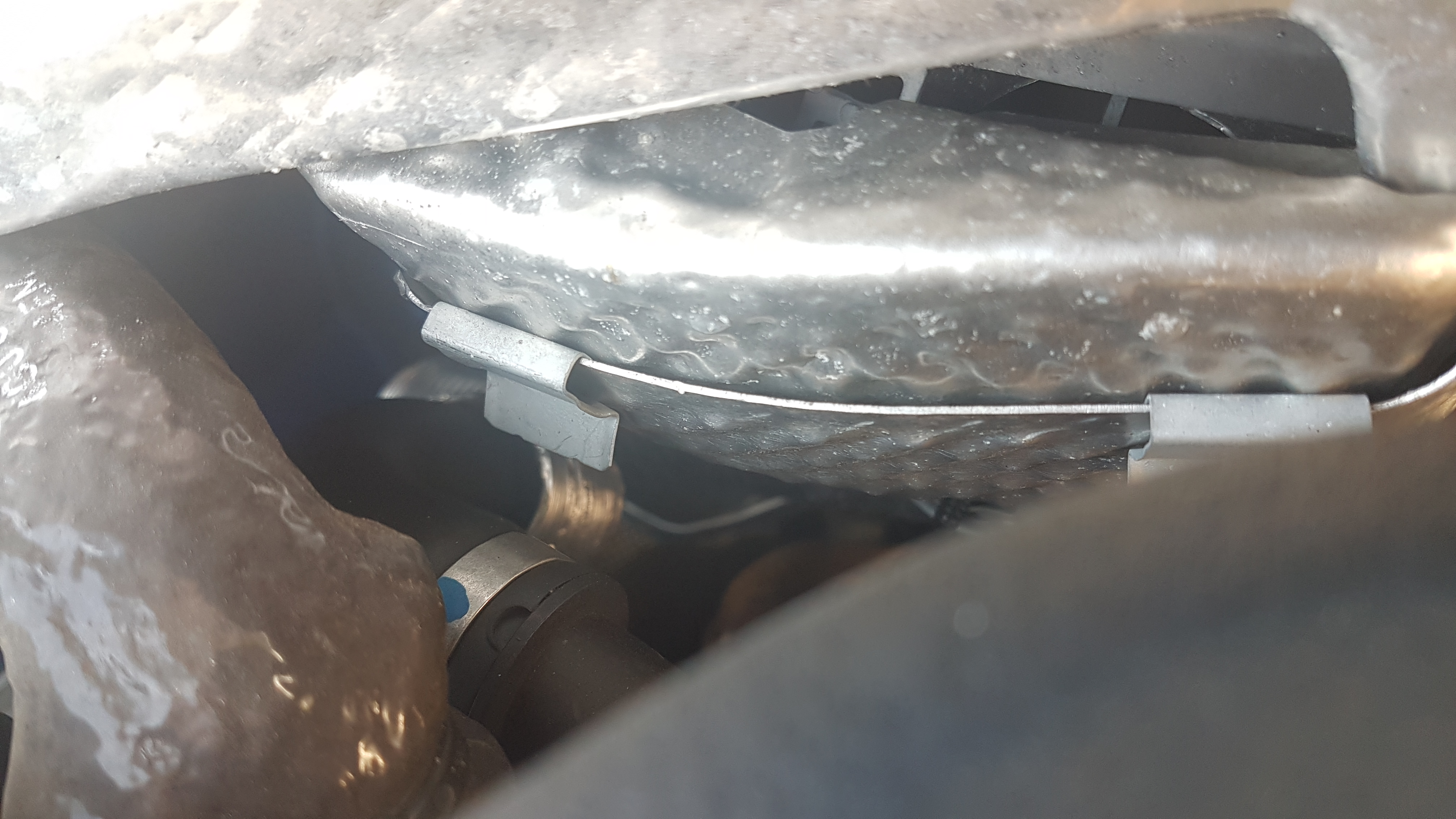

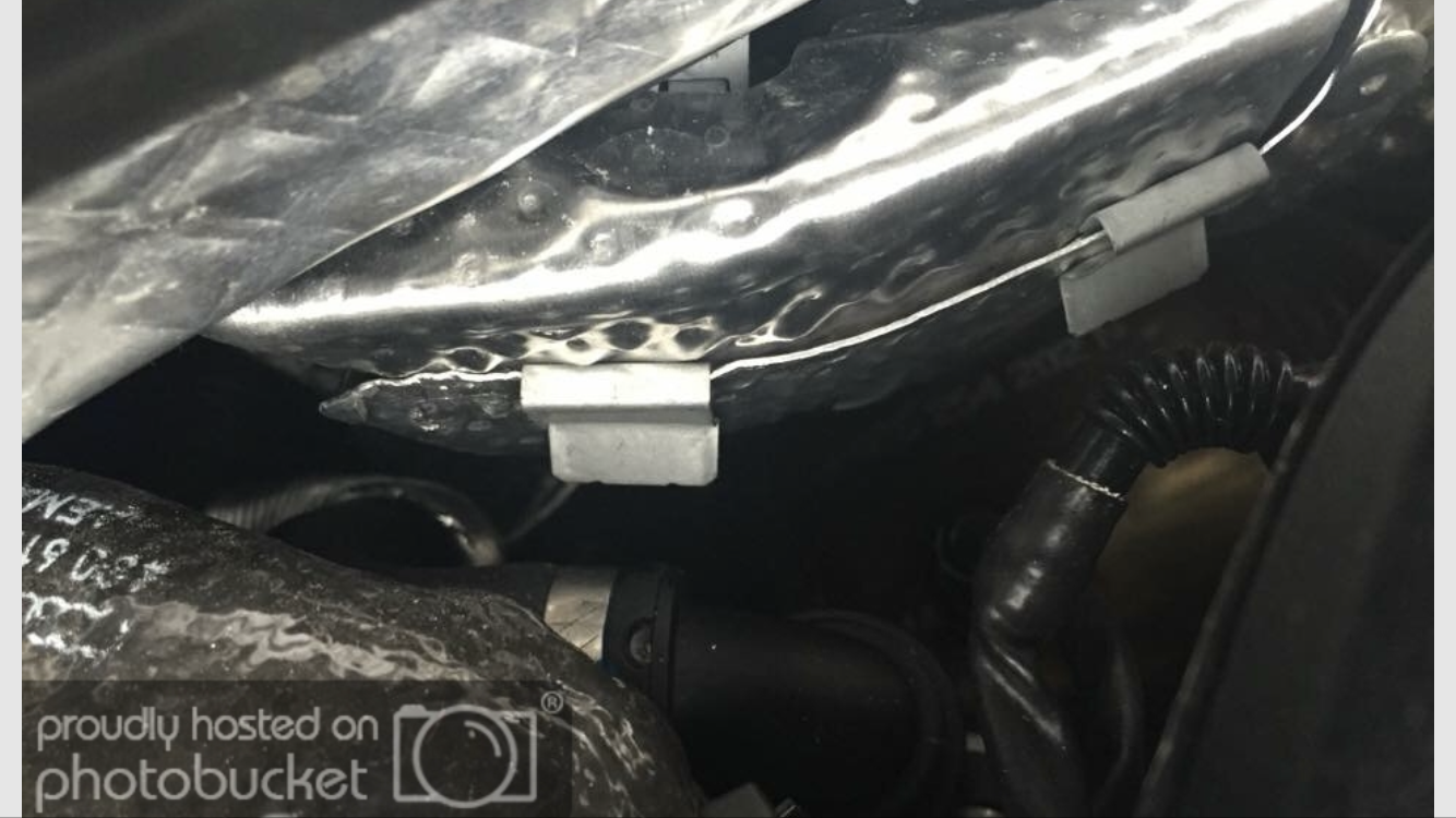

It’s still on page 1 using a phone. But here it is anyway. I’ve just screen shot them.

Thanks but what I ideally need is arrows to what I’m supposed to be looking for as the photos just show pipes and jubilee type clips, im confused if it’s those or something else hencing wanting a diagram on a photo! I know I’m high maintenance! Thanks
Re: Potential issue with coolant hose rupture (Facelift RS6)
Post by MikeFish » Tue Jan 29, 2019 5:43 pm
In the top photo there are 2 bits of metal attached to what looks like a metal wire running across the photo. Make sure the one on the left isn't touching the coolant hose in front of it.

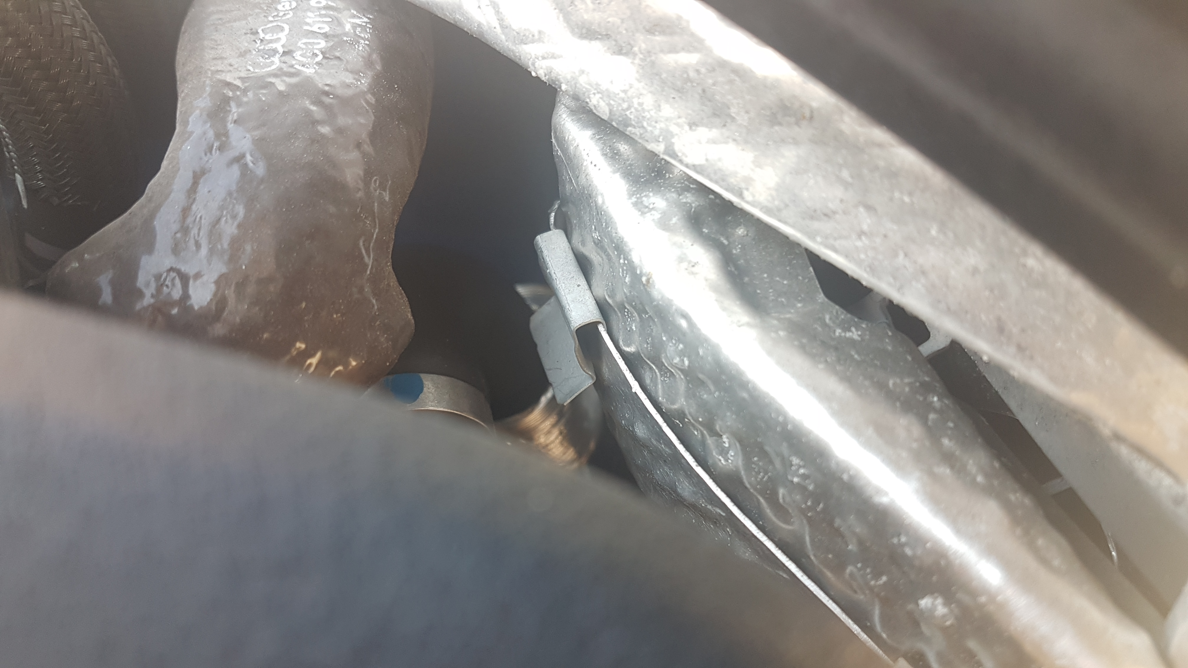

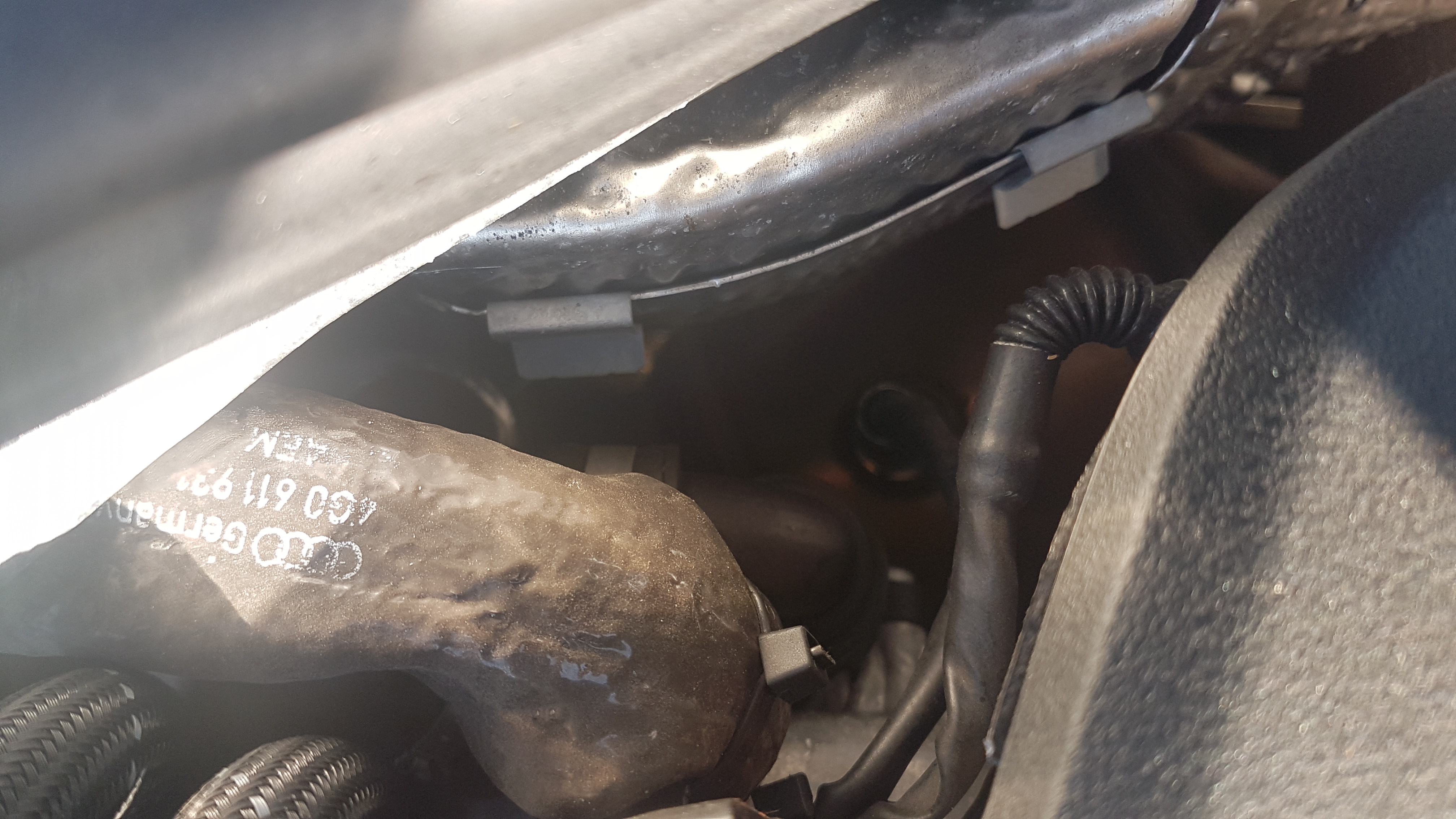

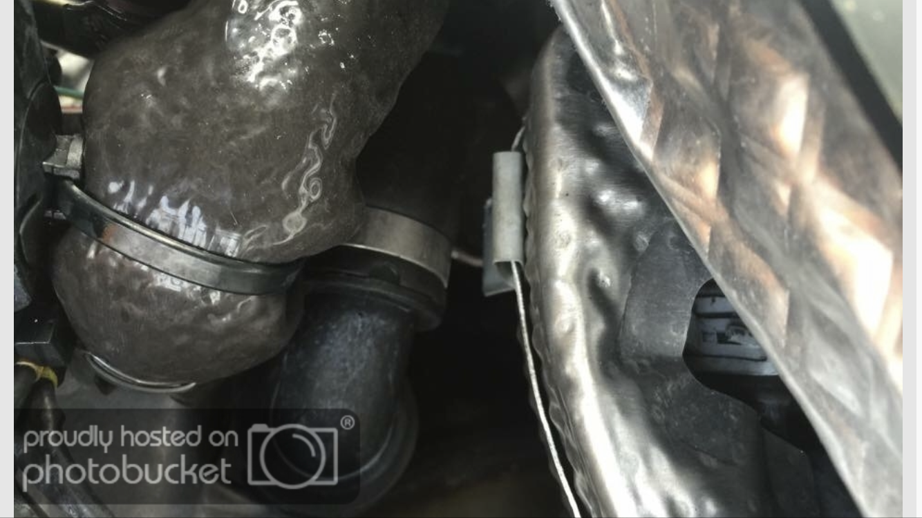

I checked mine which seemed fine.
[attachment=0]2019-02-02 11.31.25.jpg[/attachment

I just checked mine on my 2017 Performance and found it to be rather close around the 5-6mm. No markings on the hoses which is good news but I’m so glad I read up on this as it definitely looked close enough that it could have rubbed.
