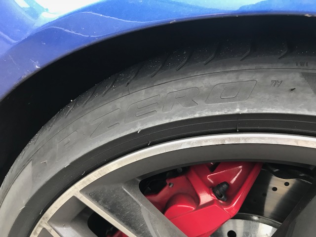

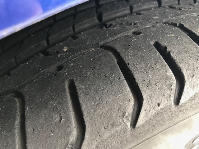

interesting about the camber - I have no idea who did it but I have a local firm that have all the latest equipment including force balancing machines so, like I did with the 4, I'll take the 6 there after reading up on that geo thread.

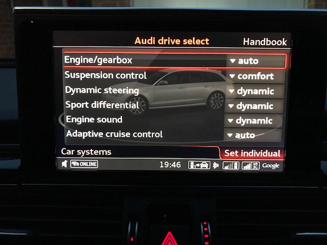

Last night I went out again to have another look at some different config setups. (I have DRC on the car)
With everything in dynamic it was again lurching all over the place and shutting throttle down, as before, but this time I got the feeling that the car was 'hopping' as the tyres were gripping, then losing it and hopping to adhere again, not sliding. Even under no throttle is was doing it a bit so I did a few more attempts on auto suspension setup and it was better, much less hopping and the car was a bit more settled with the ecu pulling less throttle.
...so then I put the suspension in comfort and had another go. Result? no hop at all, smooth sliding and handling like I would expect.. You can feel the car settle down and the diffs control the yaw. There was a bit ow nose dip and tail dip in and out of the corner, but laterally, fairly level.
The balance was neutral I felt, slightly more understeer than the 4, but then there is a lot more power to deal with, but the car was acceptable.
So I think the geo & tyre setup may be the cause.
6 has P zero, and from memory the 4 had Dunlop SP sport on..
Checked the m this morning and the car is eating these P zero.
below shots of tyre, wear and the best setup I could find.

Auto is the best setting for suspension in everyday use. Let the car decide what is required. And get a geo pronto.
Re: Handling question - issues with an RS6 having come from a B8 RS4...
Post by MikeFish » Fri Sep 14, 2018 5:41 pm
I don't like auto. I want to know what the suspension is doing when I going into a bend. I find auto too unpredictable.
Markp
Posts: 1119
Post by Markp » Fri Sep 14, 2018 6:07 pm
I always used it in my 6. Works better in my current 4 though. Feels like it is in dynamic most of the time but slips to comfort when you are going slow. Dynamic was too hard in the 6 for the roads around me.
