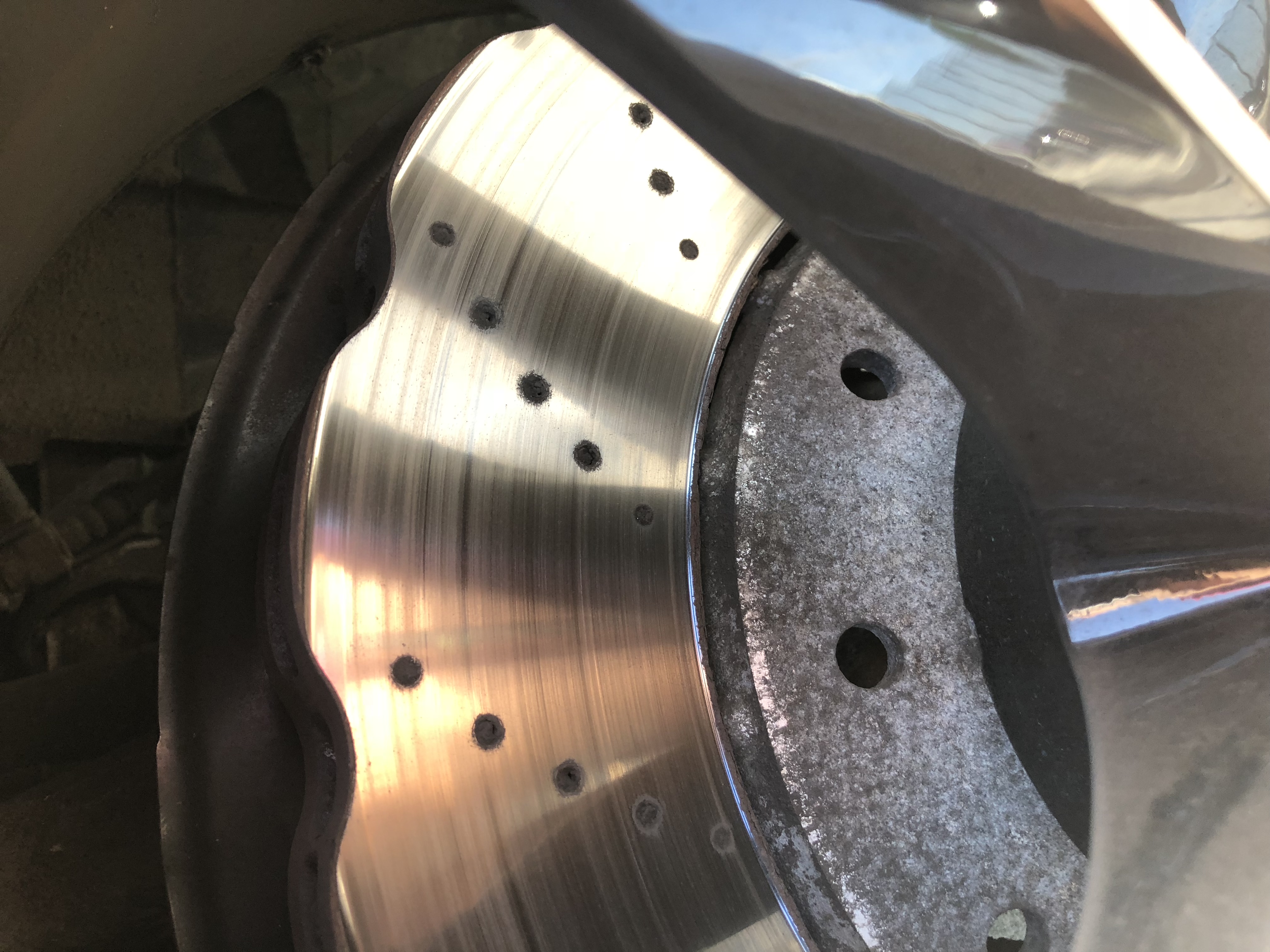

Now today i’ve finally had a chance to see my brake discs up close and noticed there is a lip on them, a decent lip too and more than i’d expect on an AUC car, I have done about 1800 miles since I got it, not enough to cause a lip that big IMO.

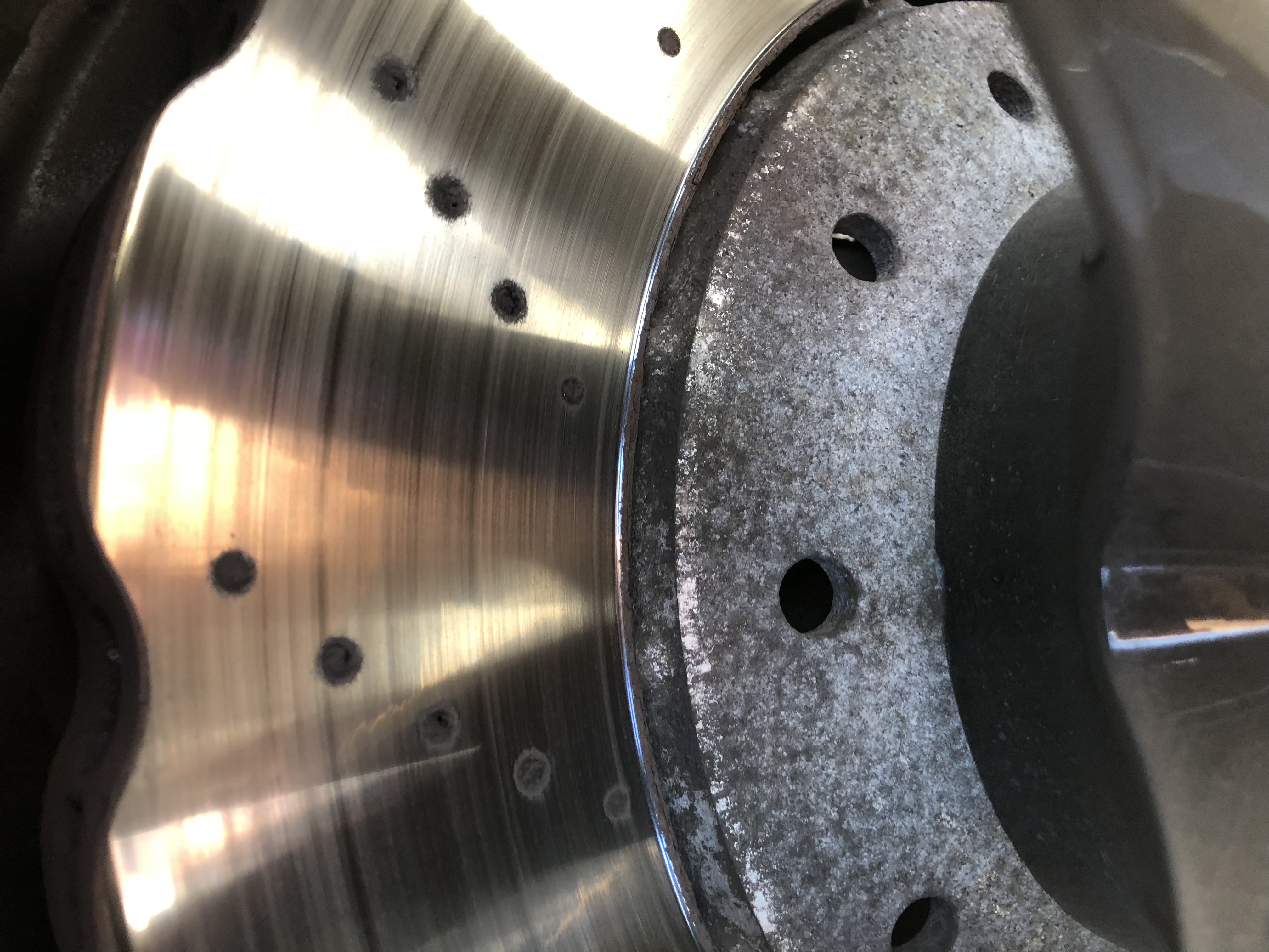

The supplying dealer is nearly 3 hours away from home so I wouldn’t be going back there and go to my local dealer in Birmingham instead. Attached a photo of my what brake disc looks like this morning, the round imprints are nearly smooth too.
Re: Brake disc & pad question when buying AUC
Doesn't look too bad. They normally have about 2mm of wear on them so anything less than that is OK. And the holes always fill with dust and rust.

On my RS4 with similar wavy discs, I was starting to get squeals and after measuring the discs, they were still within spec. I was on my 2nd set of pads (fairly new) and the squeals are becoming less common now. I think it might be down to the pads rubbing on that inside lip edge which appears with wear - you can see on your pictures, that this is happening too.
