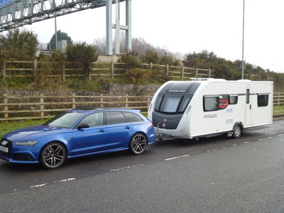

I towed with my RS6 but had the factory spec tow bar and air suspension. Also had an E63 AMG which was not type approved to tow despite the general E class being able to. Merc would not install a tow bar hence why I went for a new RS6.
It was a lovely car to tow with -
moto - if you get overtaken by a caravan you are going too slowly.

cant get the pic attachment to work.
