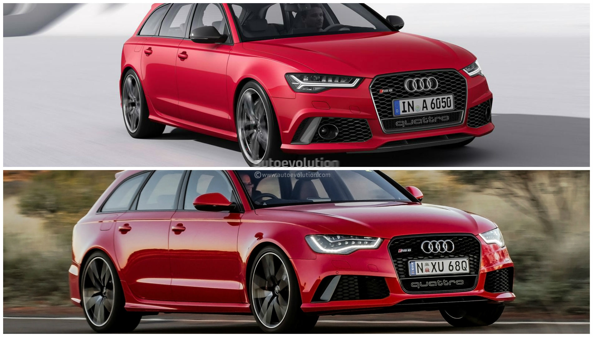

Top one is facelift and bottom is pre facelift.

Great. Last question then. What if it is not a facelift but had the led light upgrade as an option ?

I'm quite sure the light upgrade also requires a front bumper and grill upgrade too. I also think the facelift comes with Alcantara on the door cards and a sat nav map option between the two dials on the dashboard. however someone with more knowledge may correct me on that.

Scott’s picture of the non-fl (bottom picture)has the led upgrade. Standard headlights were Bi-zen. Fl cars all had matrix as standard. Alcantara door cards were my16 update. It would be better to just post a picture of the cars you are looking at for us to identify them for you.slowfastmonkey wrote: ↑Wed May 09, 2018 3:57 pmGreat. Last question then. What if it is not a facelift but had the led light upgrade as an option ?

Also look at the bott9m of the grille. The pre facelift cars have much rounder bottom corners and the facelift is much squarer. The shape of the DRLs is a dead giveaway though..
