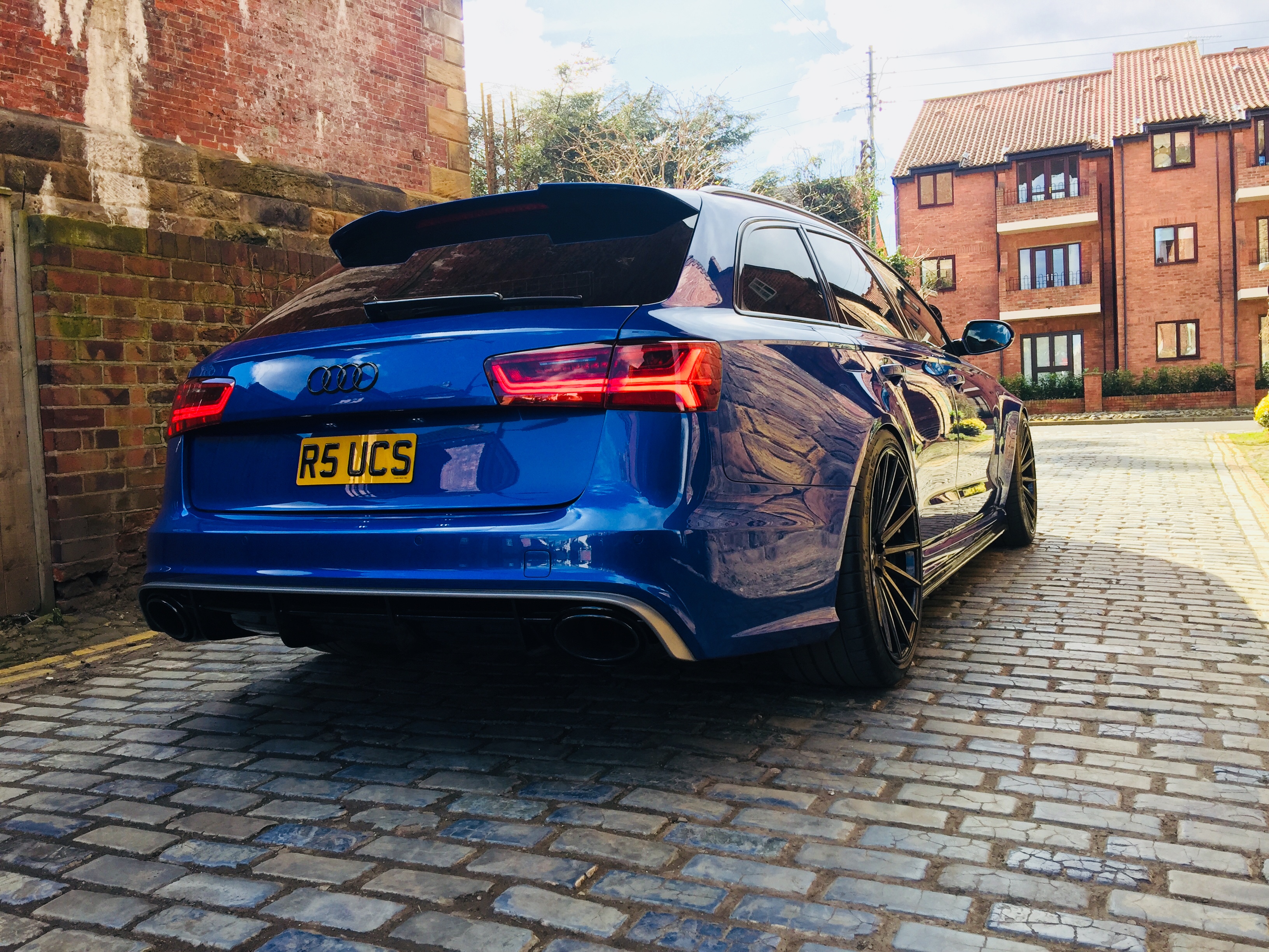

I’ll see your Vossens, and raise you a set of custom forged rims!
http://www.bcforgedwheels.co.uk/media-gallery/
I’ve enquired about 20’s - £3.2k for the monoblock designs, or £4k for 2-piece
