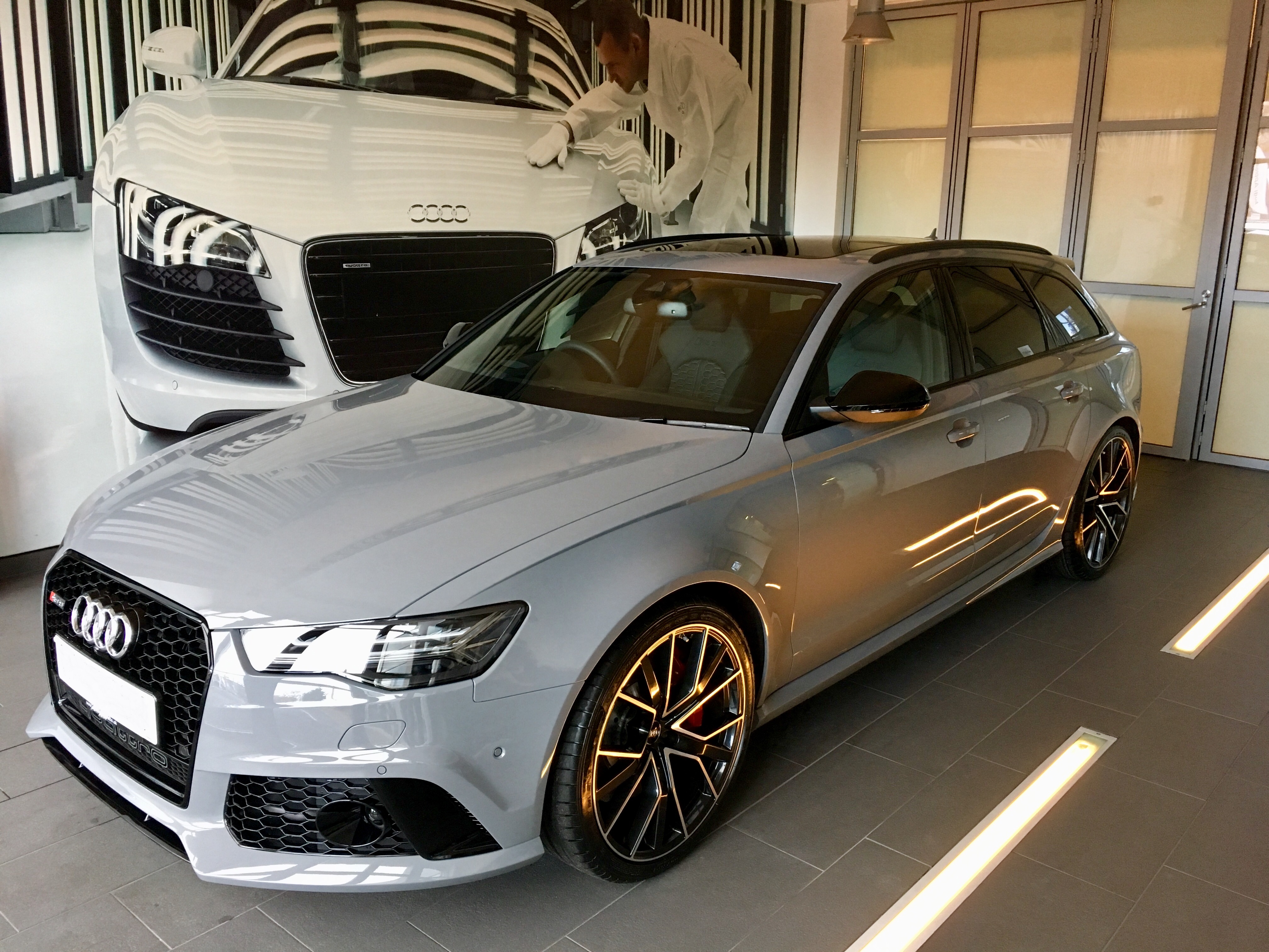

Post by Moonmonkey831 » Wed Nov 22, 2017 1:53 pm
oh and here she is when I picked her up on Saturday :-)
Gorgeous, congrats! Nardo with black pack and black wheels. FTW. :thumb:

Lovely choice of car. Looks great.

Thanks all for the positive comments, I really like the colour combo, not seen one in the flesh before so am happy with the result and certainly feels more of a head turner than my RS4 was.

Great colour combo !
