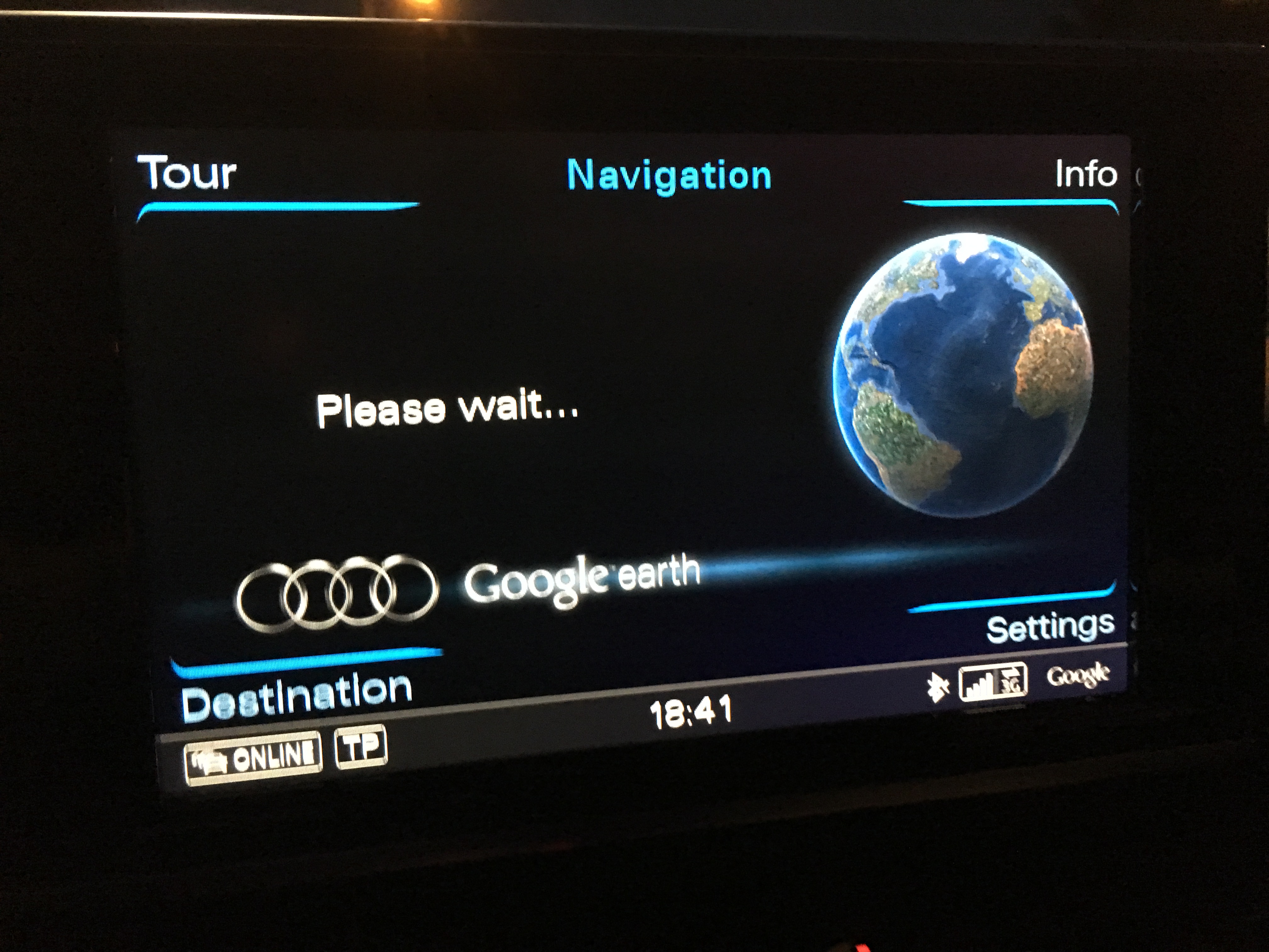

Google maps for the nav was working perfectly. Now the download hangs as the picture below. SIM is full of data allowance and all other online services working fine. Audi did recently refresh subs to online traffic and my only guess is this has ballsed up something.
MMI Google maps download hanging

Just got Audi UK on the online chat. Google Maps not downloading is impacting all Audi customers - they are working to fix. Advice is to check back in a couple of days.

So I installed the sim and the screen just stays like this.. Image

Yep, the what you should expect given current issue with Audi Connect and Google Maps feed. I see your google sign in the bottom right hand corner illuminated so should work fine when Audi sort the issue.

So, another call to Audi UK today given some folks on here not having issues which discounts previous advice it was a system wide outage. :roll: So new AUDI stance is there is no system wide issue and what was mentioned yesterday was "odd". Anyway, been advised to visit the dealer again and revert if MMI firmware is not up to date - can anyone advise on below (pre face lift) please? I've tried googling all morning and it's a minefield and simply don't have the time to book in at the dealer moment.
Media Version HN+R_EU_AU_PO783
Nav .DB vers. 8R0060884BT ECE 6.19.3 (expecting maps to be old as car - 2014)
Only two variables since it stopped working have been a rear brake change at the dealer (can't see them flashing anything then) and a renewal of the online traffic licence. Oddly on an MMI restart it flashes a current google earth map and then goes into pending download screen.....very weird, like it's got nowhere to write down the data.

Ask a different person get a different answer..... google earth overlay confirmed as down by US Audi Connect help line. Appears it's impacting older vehicles. I rang the Audi help line and got the automated message so acknowledge issue and they are working to resolve.

Mine is working now. Image
