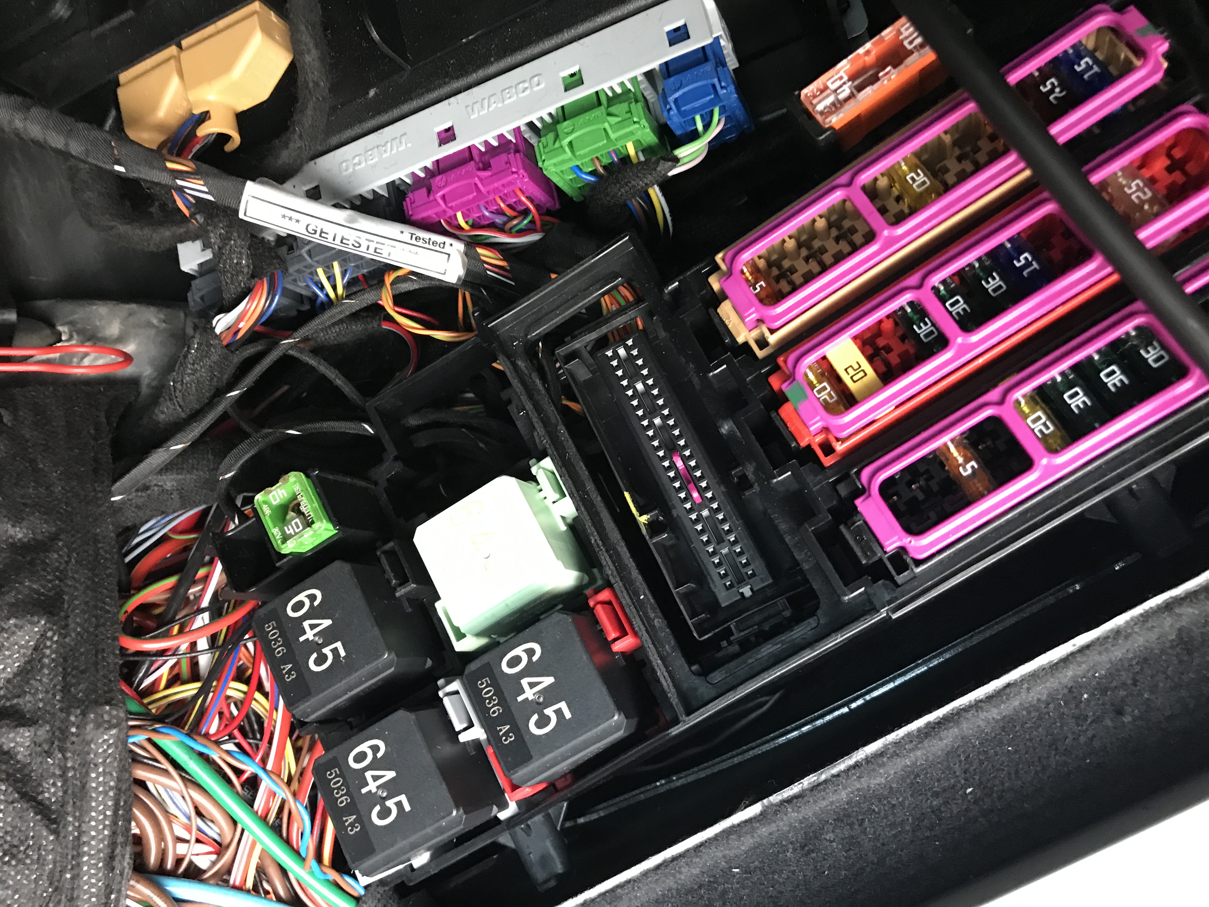

How do I remove the canbus then? It's all very tight
dasquade
Posts: 269
Joined: Wed Apr 06, 2016 11:36 pm
Re: CETE ACTIVE VALVE CONTROL
Post by dasquade » Tue Aug 22, 2017 10:31 pm
There are 2 or 3 clips on the side (buttom side on picture/side trunk) that you can loosen, or was it the other side. Anyway, after you loosen the 'block' that holds the canbus and fuses, you can tilt it to you and slide the canbus out of the block. Opening the canbus plug itself was a mather of a hard pull on it (took me also awhile but was confirmed by other). Good luck.

No instructions in English but I got the idea. Managed to get it fitted in late. Will test out tomorrow.
Support from the manufacturer is good.
