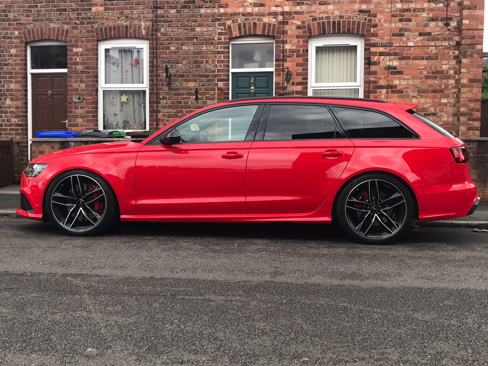

Mine is lowered on 20MM H&R and I don't have spacers. It is pretty low at the front and I don't have any scrubbing issues.

Thanks mate! Looks good on those wheels, suppose they are probably a more aggressive offset than the standard wheels anyway hence no spacers needed.
Will see how I get on with mine and if it scrubs I'll have to lose the spacers

Wheels are 1" wider than stock with same offset hence aggressive look, spacers would be too much on mine. Good luck with fitting of yours

So yeah 10mm spacers need to go... Im amazed how low the 20mm H&R springs have sat the front end of my car. There is no gap at all now, I'm worried it may even rub without spacers if I'm turning hard and hit a bump.
Will test without spacers next... shame as it looks amazing now. The stance is awesome but can't put up with the rubbing

I thought my 40mm springs with 12mm spacers on the oem 20s were a tight fit but I haven't bent the wing. It is so close that if I sit in the car and turn the steering wheel side to side I can hear it rubbing the arch.

See what I mean?
Re: Any pics of cars lowered with H&R 20mm springs?
That part where it touches on yours is where I bent it out, it's only a slight bend out but that was in one 30 minute test drive, albeit quite a bump in the road I wasn't expecting whilst turning. It made a horrible noise!
Mine doesn't touch like yours when stationary though. Does yours hit the arch badly under hard cornering?
I think I saw pictures of yours with the PE wheels and no spacers also, is that right? Do they still catch or are they ok?

Yes that sounds like mine. With the PE wheels and the 285 tyres I can't run any spacers at the front at all. I don't notice it rubbing but there is no paint on the inside of the wheel arch so it must be rubbing slightly. But that is with 40mm springs.
