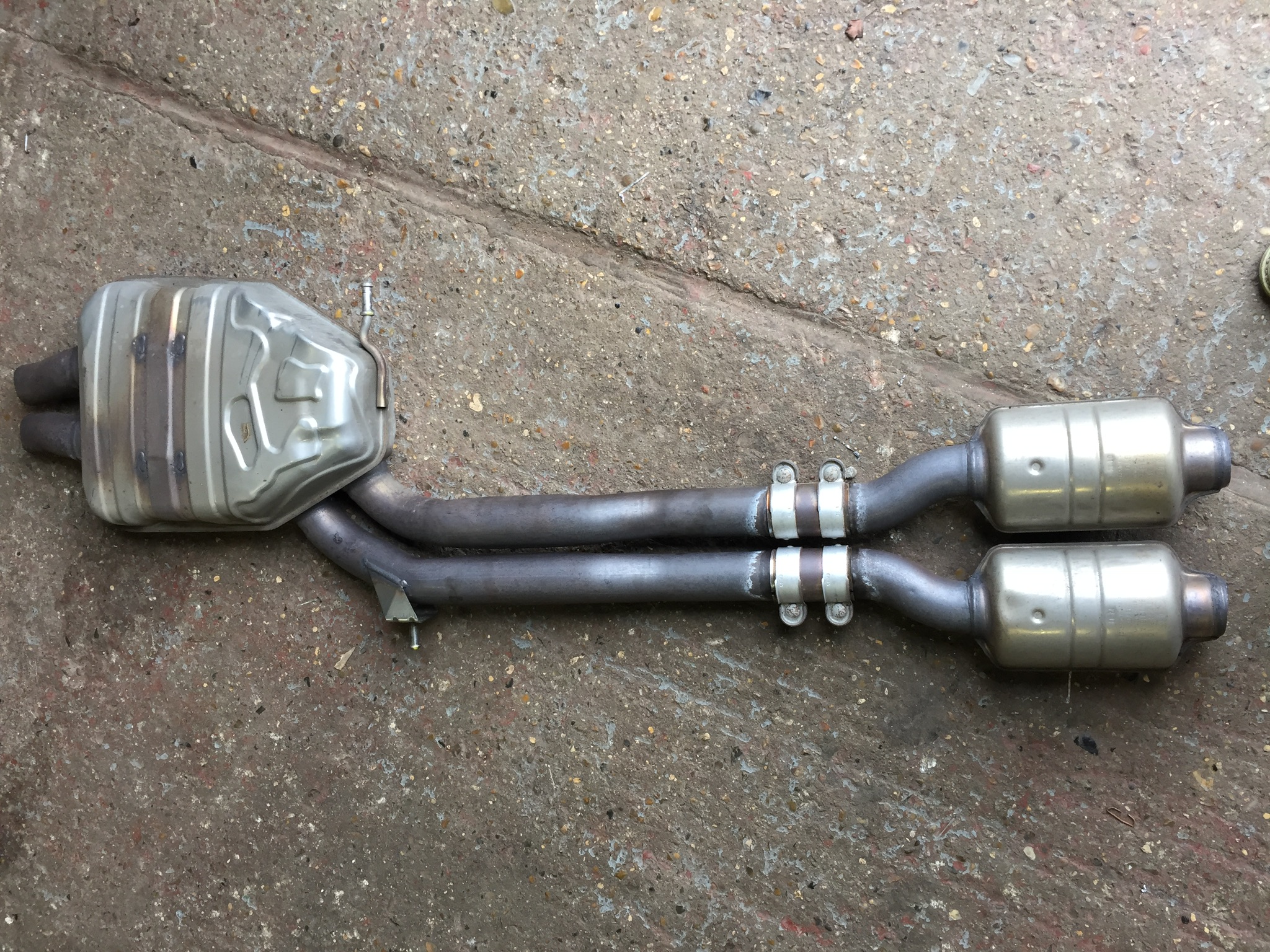

The cats are in the downpipes and cannot be seen from under the car. I wouldn't recommend removing these unless you have a remap done.
If it is just for noise then you can remove the front silencers (some people think these are cats but they are not), one in each branch. And also remove the centre silencer which is the box that both branches go into (but remain apart inside the box).
How easy to instate depends on how they are removed. If you tell the exhaust fabricator doing the work that you want them reinstated later then he should be able to put flanges on to help. Or just pick up a standard exhaust off here or ebay (they occaisonaly come up when people replace them for aftermarket). You could keep an eye open for one over the next year.

As Mike said. Front silencers and centre box Demand did mine £340 I wouldn't even bother about re fitting the sections as you can get a full cat back system for £200 and there are loads about QST alone have at least 10 sat around. Mines on PCP

If you can find a cheap non-sport exhaust you might be better off buying that and modyfing that instead as once the silencers are removed I think the 2 are the same. Then you can save your Sport exhaust for when you return the car.

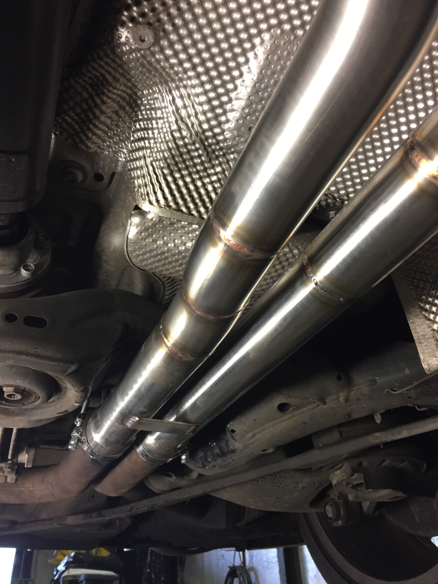

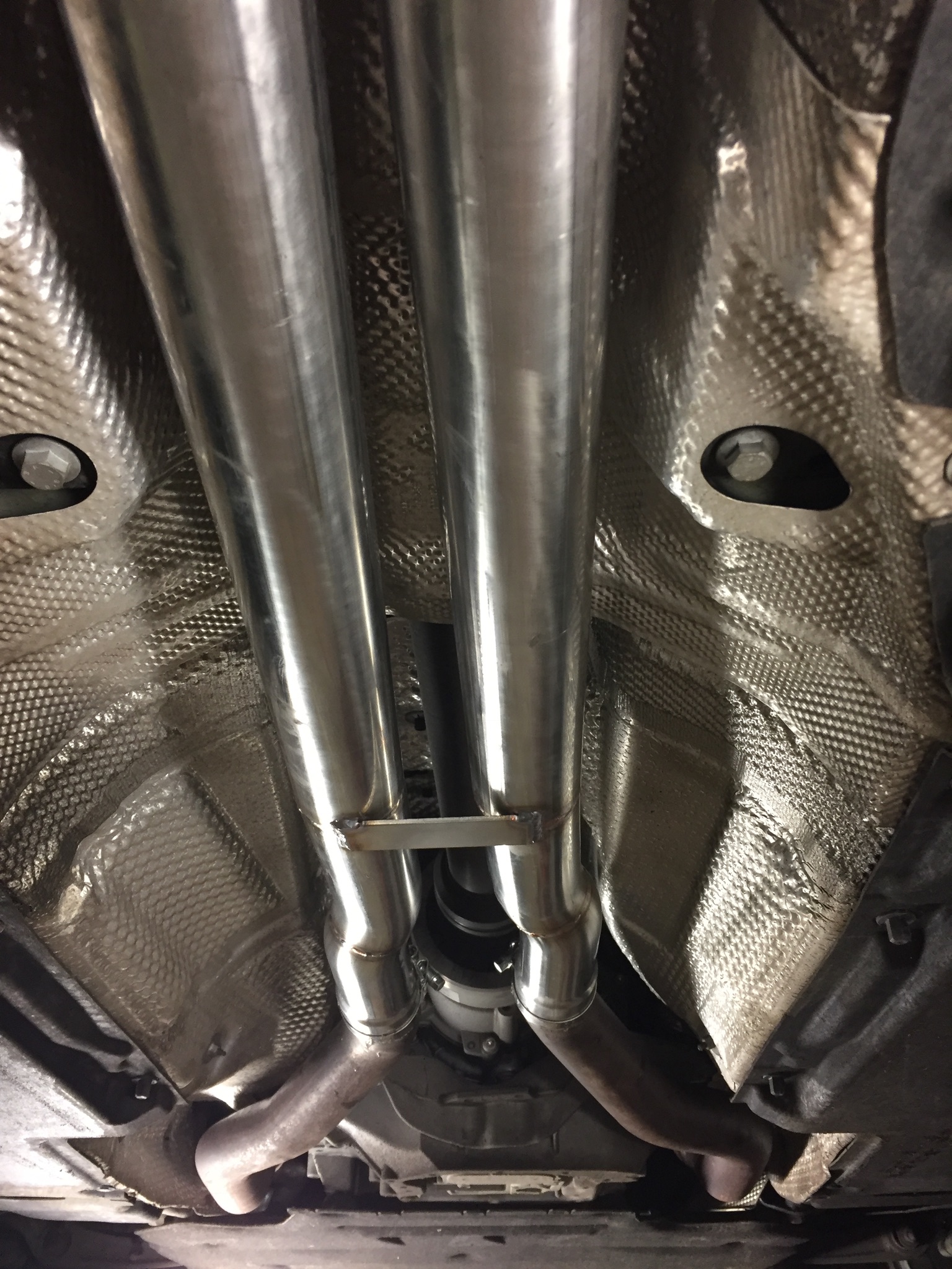

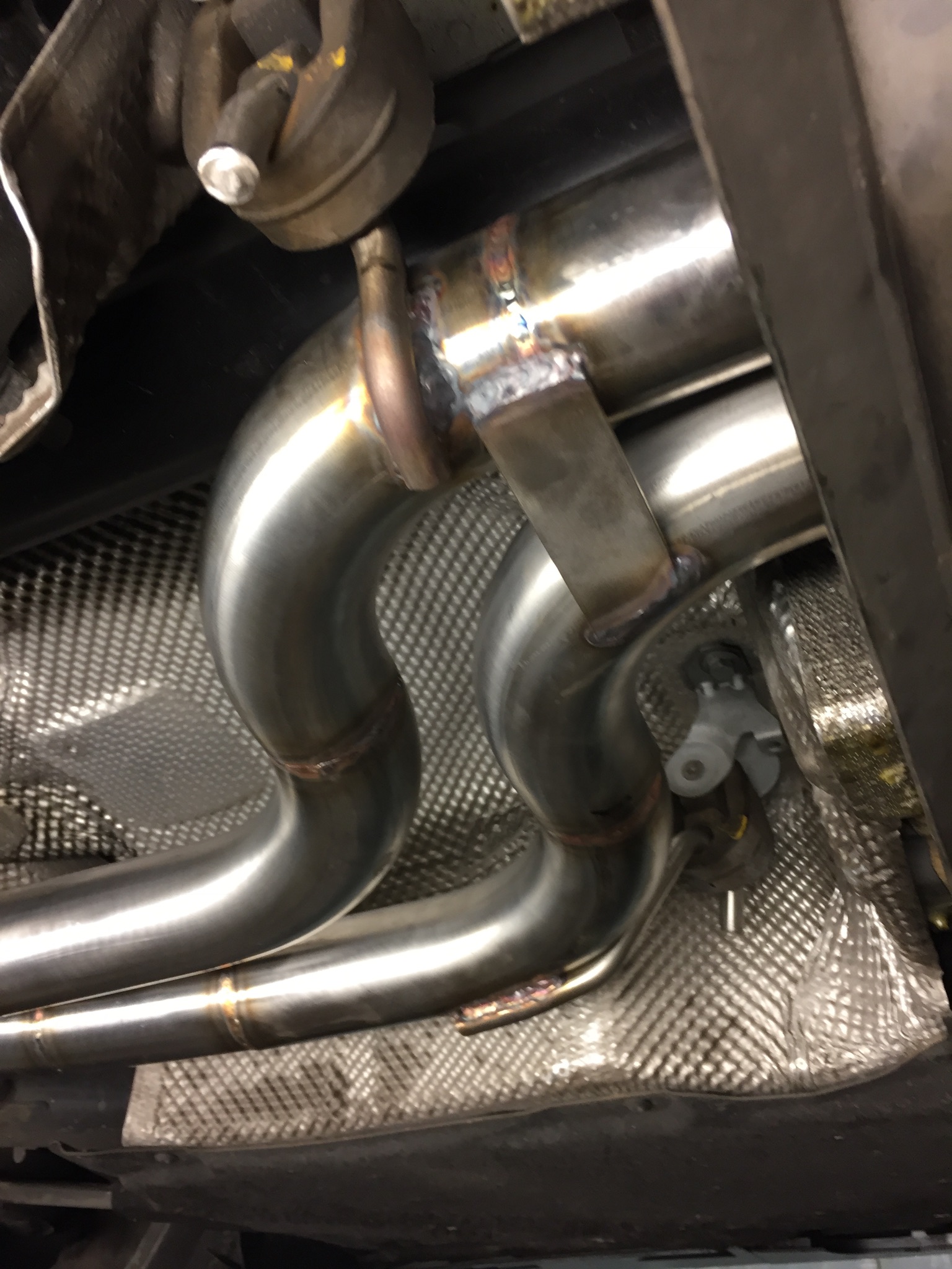

Mark has given his price above already. I paid £300 plus VAt so pretty much the same as above. But it depends on how they do it. Mine was done as 2 seperate removals i.e. cut out front bit and cut out centre bit seperately and put flanges on one of the section to make changing back easier (but oddly just welded the other bit out).

Post by skirs6 » Tue Feb 21, 2017 10:11 pm

Post by Bit_evl » Wed Feb 22, 2017 10:21 pm
They did a nice job didn't they.
