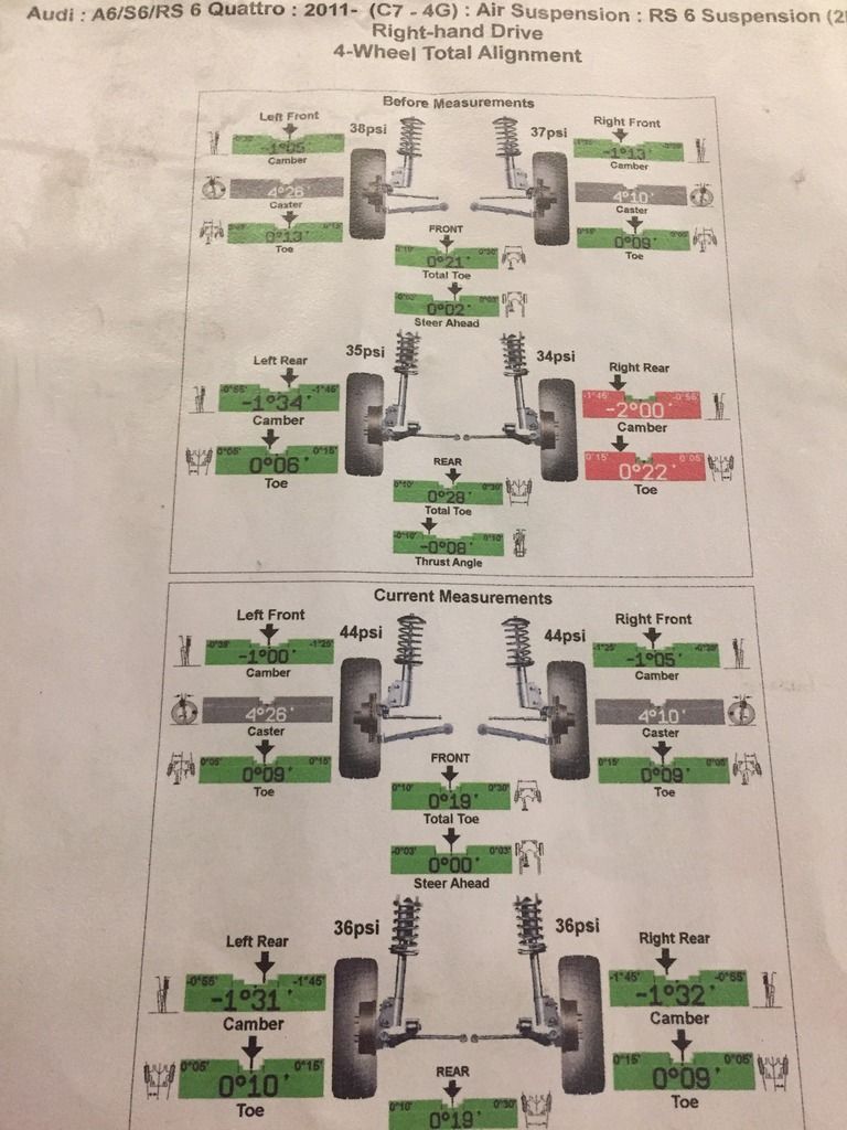

Thought i would get the alignment checked as the car didnt feel quite right.
found my local hunter alignment specialist and they found this. Im not totally up to speed on figures for alignment but this seems like it would cause a problem :biggrin2:
Anyway seems sorted now all apart from having to hold the wheel to the right ever so slightly to keep it straight - drove straight before might need to go back for a tweak.
