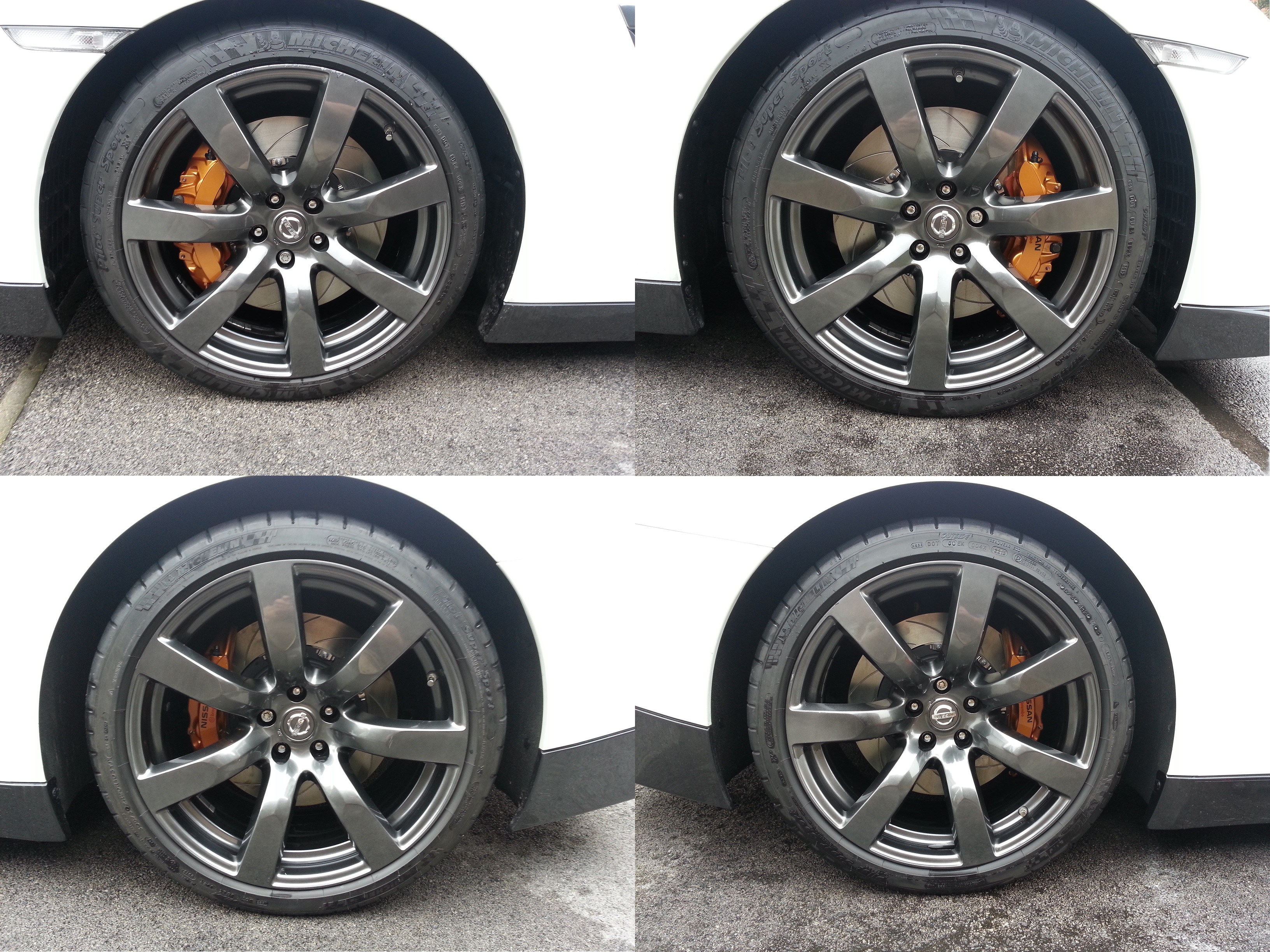

Took me 4 days doing a corner a day (~3hrs per day) but I finally fitted the AP Racing discs and EBC Orange pads (I like them). Bedded them in today and looking forward to Snetterton next week to see how they perform compared to the DBA fronts and stock rears that I've just taken off.

Total cost was about £1600 for discs and pads. The experience was priceless (Didn't realise the rears have a brake drum and shoes for the hand brake)

They look good, are they a usual upgrade for gtr owners?

I think it's one of the first GT-Rs with AP all round. Fitted the stock bells and seemed like good value for money.

I went for the 400mm alcons and 380 rears, massive improvement over stock. Ap's look good Phil

Fell out with Alcon many years ago after being let down on promises. I think the Alcon setup is more expensive too.

Yeh it's not a cheap upgrade but worthwhile.
