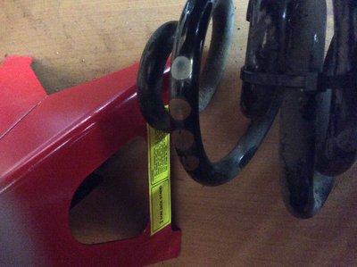

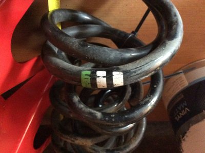

Paint codes are
2-white/1x green striped
3x brown1 x silver dots
Pics
Thanks Mav8
Paint codes are
Pics
Thanks Mav8

Re: B7 OEM std springs -free
The springs you have are:
Front springs are 0JJ (Front Axle Weight Range 9), 2MC (SS)
8E0 411 105 EH coil spring
1 paint mark (Green)
2 paint marks (White)
Rear springs are 0YM Rear Axle Weight Range 11, 2MC (SS)
8E0 511 115 FN coil spring
1 paint mark (Grey)
3 paint marks (Brown)
Interestingly my Avant had the same rear springs but came with stiffer front springs:
Front springs:
0JK Front Axle Weight Range 10, 2MC (SS)
8E0 411 105 EJ coil spring
3 paint marks (White)
As my car has no sunroof I can only assume this was because my car left the factory with the heavier fully electric recaro comfort seats.
So the front springs will work on a saloon if it has no sunroof and bucket seats (never wing-backs) but the rear will sit too high as SS for the that car is weight range 10 at the rear.
Unless there is a big sub-woofer/couple of dead hookers in the boot...... then it will sit nicely.
