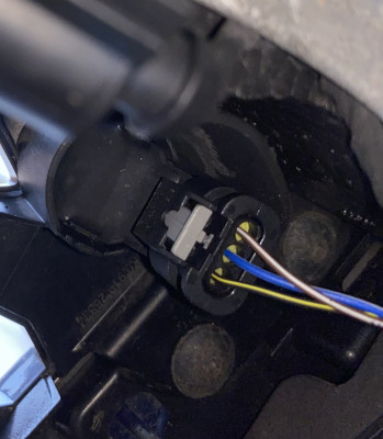

How does the grey tab work to release the plug from the parking sensor?

Ha, got it!
Grey tab seem pulls straight out and then squeezing it towards the plug while gently levering with a long screwdriver worked.
