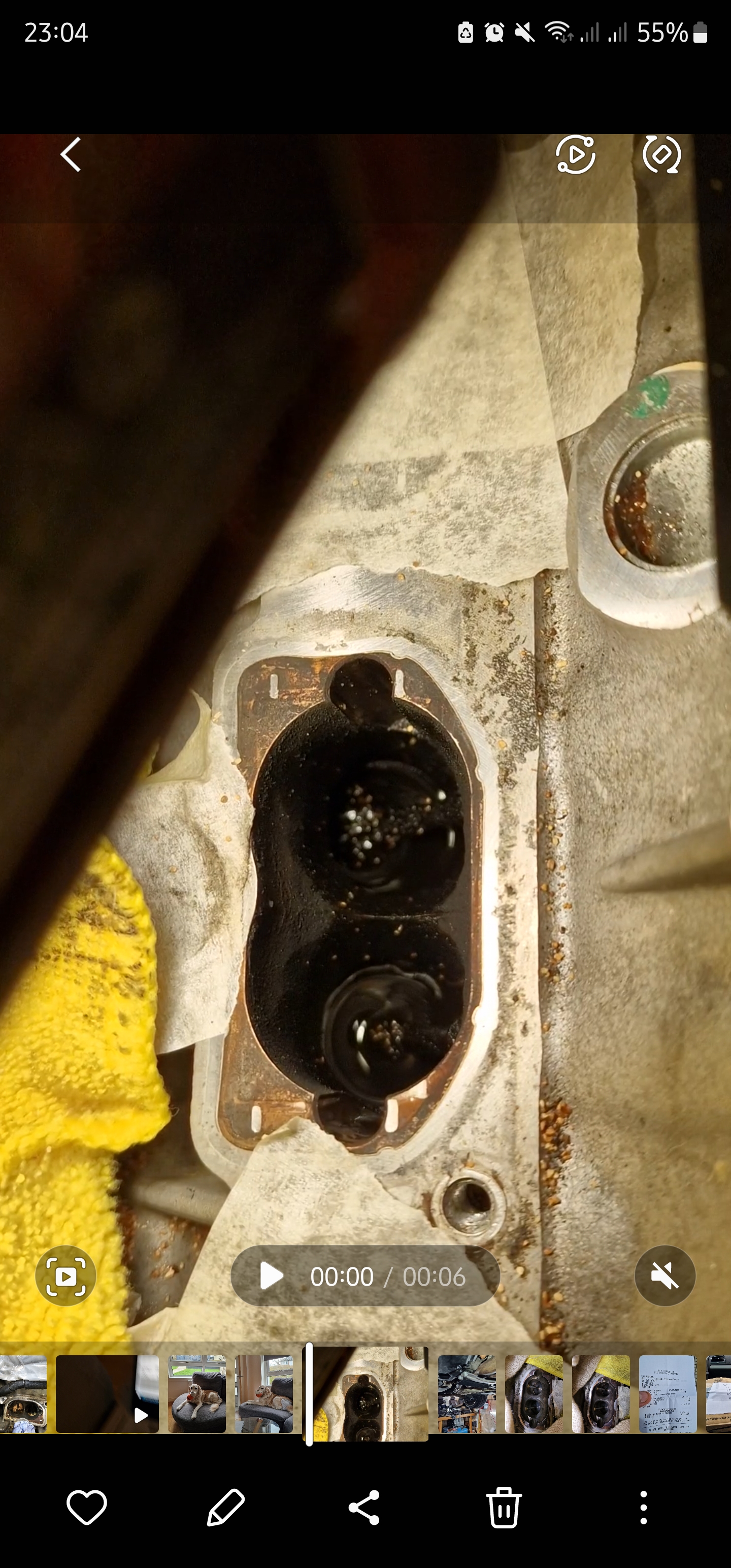

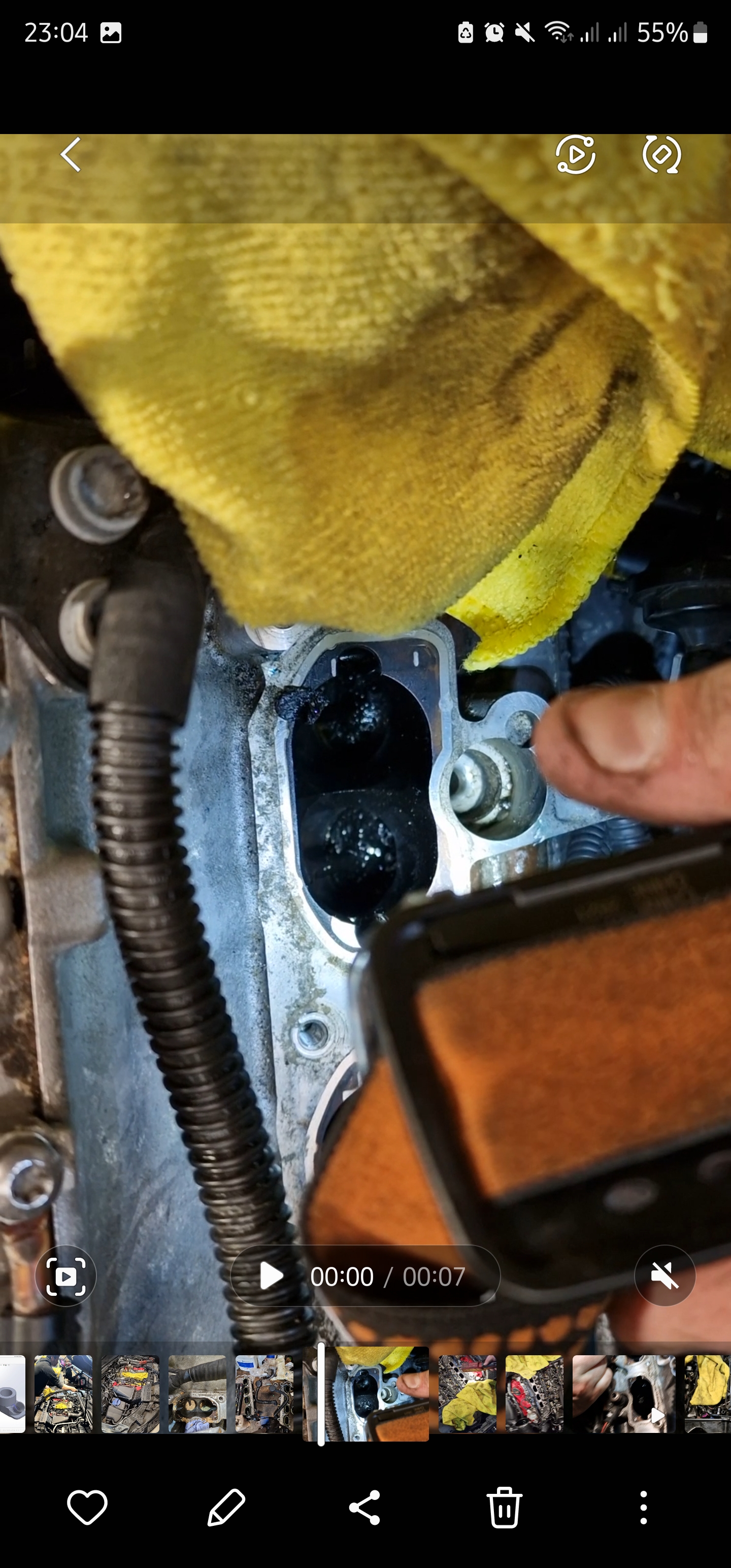

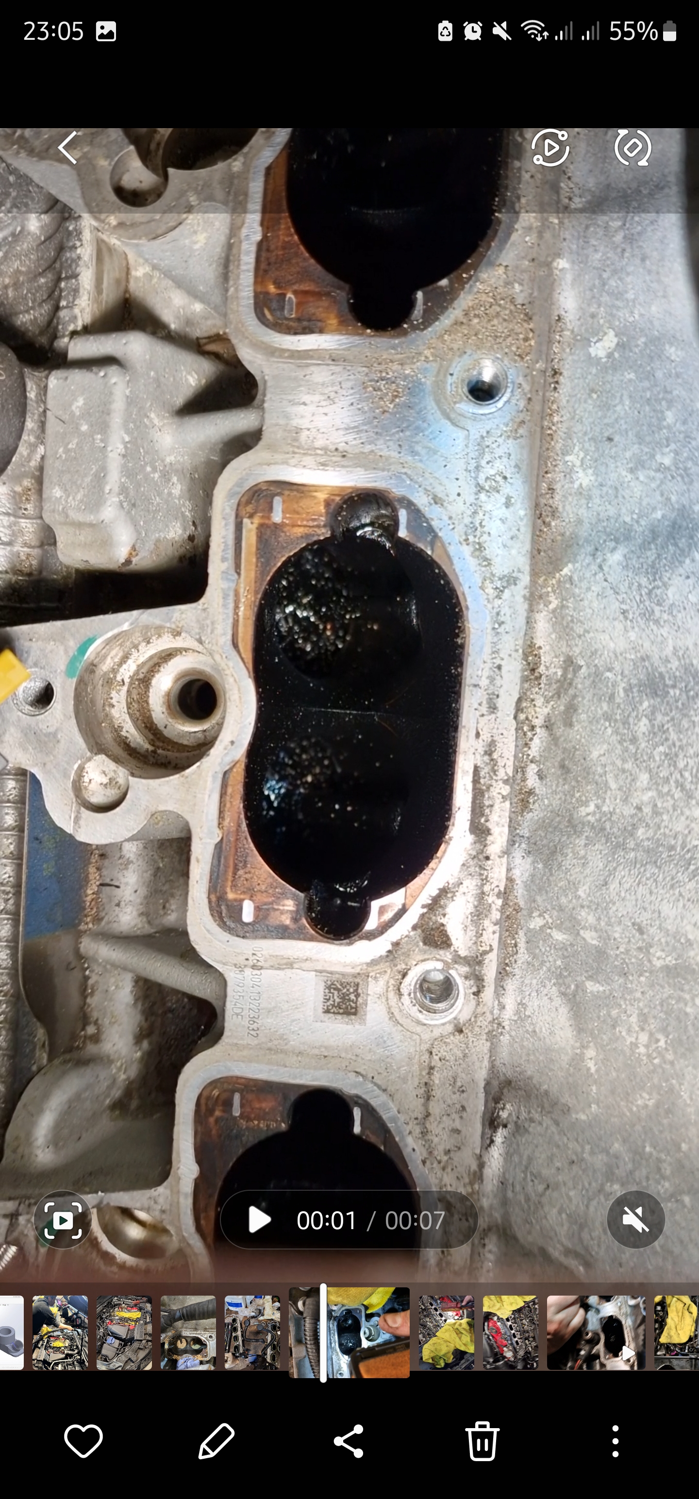

Thought I'd share some before and after pics etc - 72k 2013 RS4. No running issues etc. before doing this. Fairly sure it's never been carbon cleaned. Full Audi history (not that that has made any difference to the carbon build up).

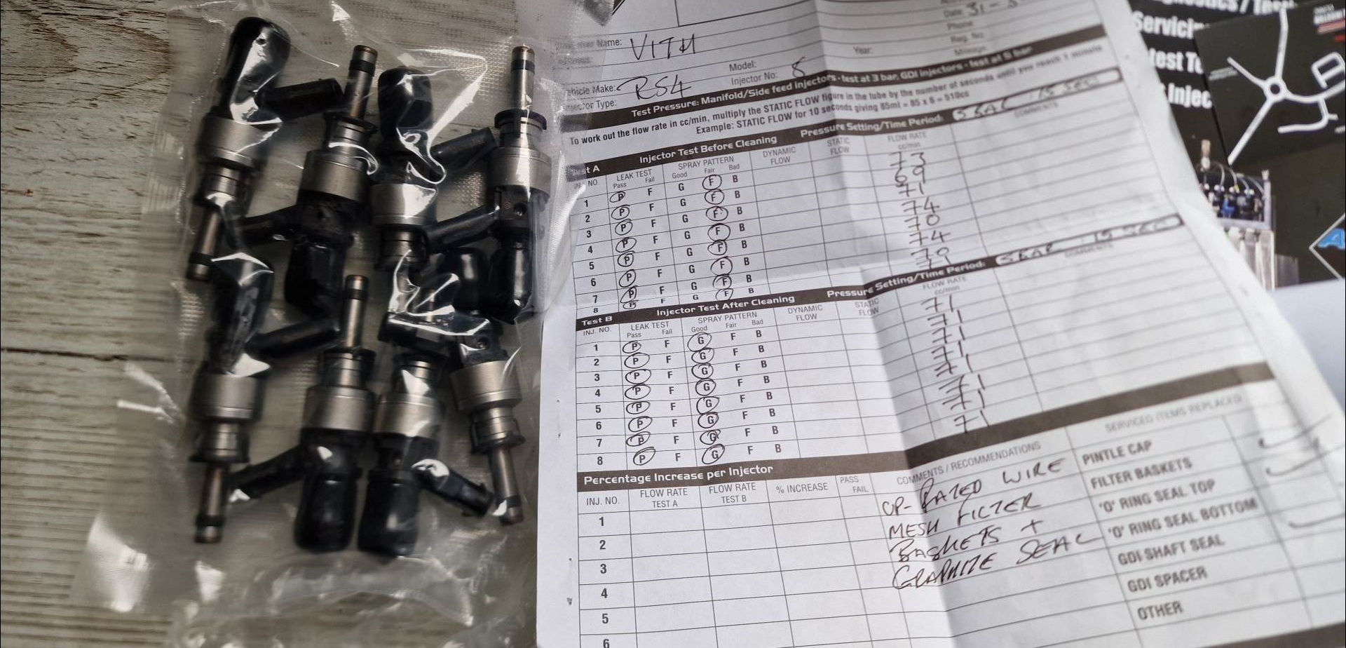

R-Tech Performance in Nuneaton cleaned the injectors - flow tested and balanced them (decent and quick turnaround - they did miss replacing one wee clip but no big deal). Sent them down on the Monday and they were back by Saturday. As per the attached, a few were running more than the others. The injector tips looked pretty dirty/carbon'd up too.

interesting thanks for the pics.

I've actually not noticed a major difference - it might just be psychological but it does feel very slightly quicker/smoother. Would be quite interested to see what it gets on a dyno - I'd hope near the stock levels. Not done my usual commute yet but apparently I should notice an improvement with the injectors all flowing equally now.
Yeah did it myself with a wee bit of help from a few mates.
I got some crushed walnut shells off of ebay - ended up with 2 x 10kg which was more than enough. Company called Key Abrasives. The gun I used wasn't the best - https://www.machinemart.co.uk/p/sb3-gritblast-gun/ - I'd recommend getting one with a longer nozzle like the one used by the RS5 chap.
You'll need a decent air compressor and Shop vac. and an attachment like the 034 motorsport one - or a mate with a 3D printer. I bought one off ebay and it was pish - my mate kindly made something a wee bit better. https://www.034motorsport.com/audi-and- ... -tool.html
Also handy to have a good set of picks and this wee kit. The walnut blasting (maybe because of the nozzle not being long) wasn't really getting the carbon off of the top of the valves. Needed to get them manually.

Screwfix do a nice plastic hammer!! Also surprised by this but managed 32mpg coming off the motorway this morning to work...30.7mpg door to door with a few residential roads either way. Best I'd managed before was high 20s. Didn't expect that sort of a difference!
