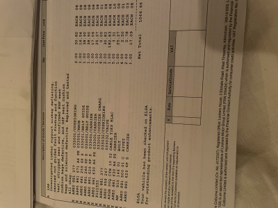

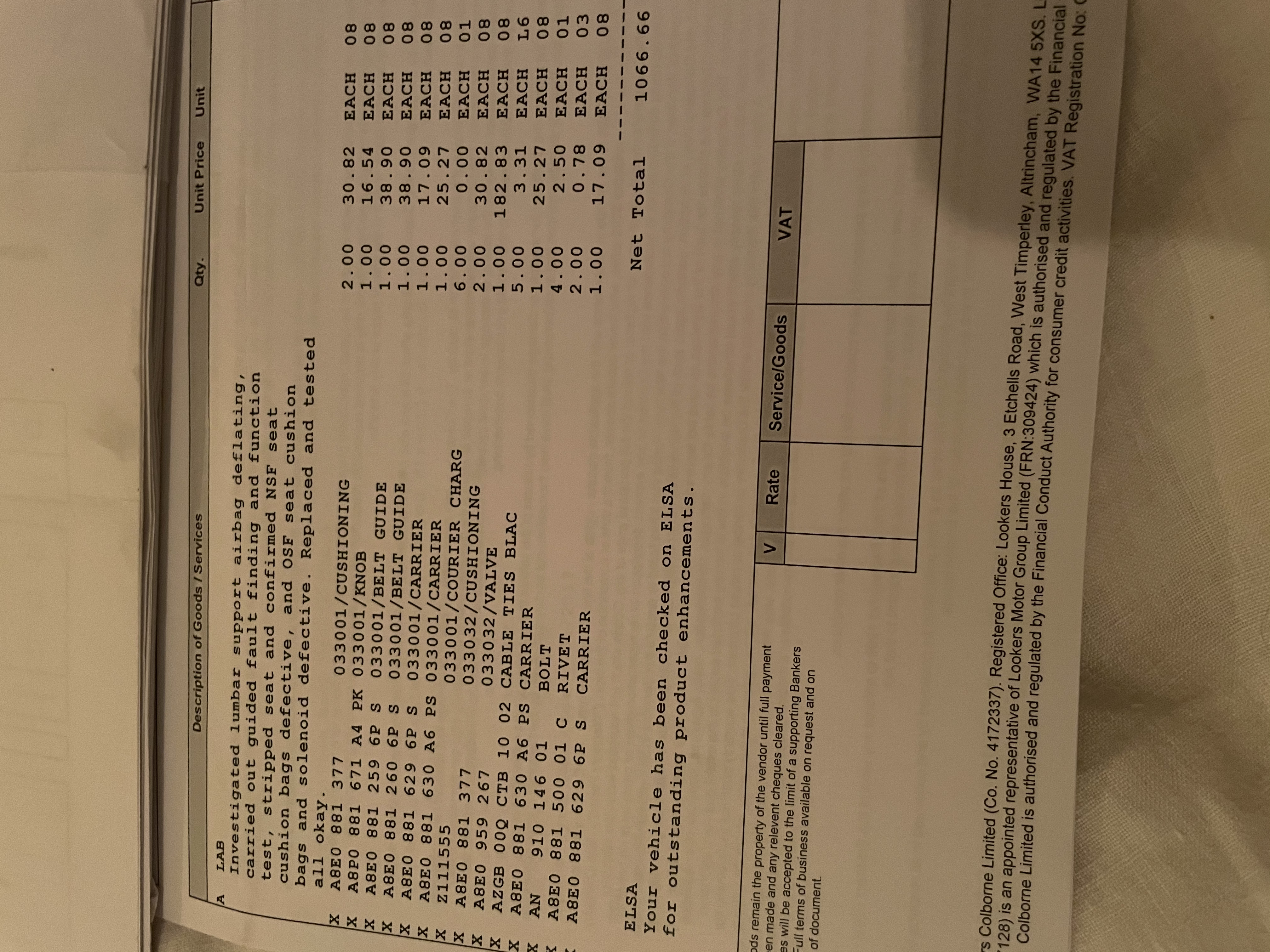

114uyc
Posts: 170
Joined: Tue Feb 02, 2016 4:12 pm
Re: Bucket Seats - Electric Bolsters won't stay in position
Post by 114uyc » Tue Feb 02, 2021 10:48 pm
I had two (upper bolsters) replaced and one valve.
Attached is a photo of the invoice showing parts used
