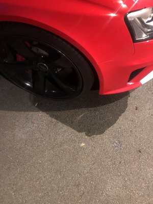

Sporadically I will find a puddle under the car in the morning, which is definitely washer fluid. I can only assume it is coming from the head light washer assembly due to is position and ‘leak’ path.
The car has been back to Audi twice now for this, where they have replaced the washer assembly once, and the second time had the whole front bumper off looking for a leak (which they couldn’t find).
Audi’s suggestion is that during operation, fluid is running down from the headlights and back into the door where the washer comes out, then collecting on a shelf / ledge that is behind the bumper, this then drains out when it’s parked up.
Does anyone else notice / experience this? I’ve only noticed if from the RH washer, and would expect to see the same from the LH side if Audi’s theory was true...

That theory sounds a bit farfetched to me, unless the headlight washer was not extending fully during operation and flooding the aperture area, rather than the headlight lens. Its worth checking that they both function correctly first.

So in the 4yrs i’ve Owned the car mine has been back every February (usually 1 or 2 weeks after the annual service) to have the drivers side headlight washer jet assemberly replaced under warranty.
Each time they’ve replaced the full kit.
Does exactly the same thing you have identified - draining the bottle over a period of one or two days.
If you carefully pull the front washer flap forward, you’ll see the nozzle leaking which drips into the bumper then runs round until it drips onto the floor.
I don’t know what causes it, nor why it keeps reappearing but interesting I am not the only one!!

Thanks Sammyb349, looks like we might be in the same situation, as I am told by Audi that this is the 2nd drivers side washer that’s been installed under warranty... the first being done by the previous owner, the second by myself. How very bizarre. It’s like it is some sort of seepage that only comes through the drivers side! Does your Audi garage suggest any root cause?

No - had master tech dismantle the entire assembly and replace everything this time. My personal assessment is the part is made badly and and they leak eventually. As long as they give up within the two year warranty I am fine (other than the hassle)

So I’ve had another look at this and it is exactly as Sammyb says the left hand jet nozzle of the right hand washer is constantly weeping fluid. I have a boroscope, which I have put inside the flap and the leak path is onto a shelf beneath the washer jet when it is stowed away, which then exits throuh the undertray forward of the front wheel...
