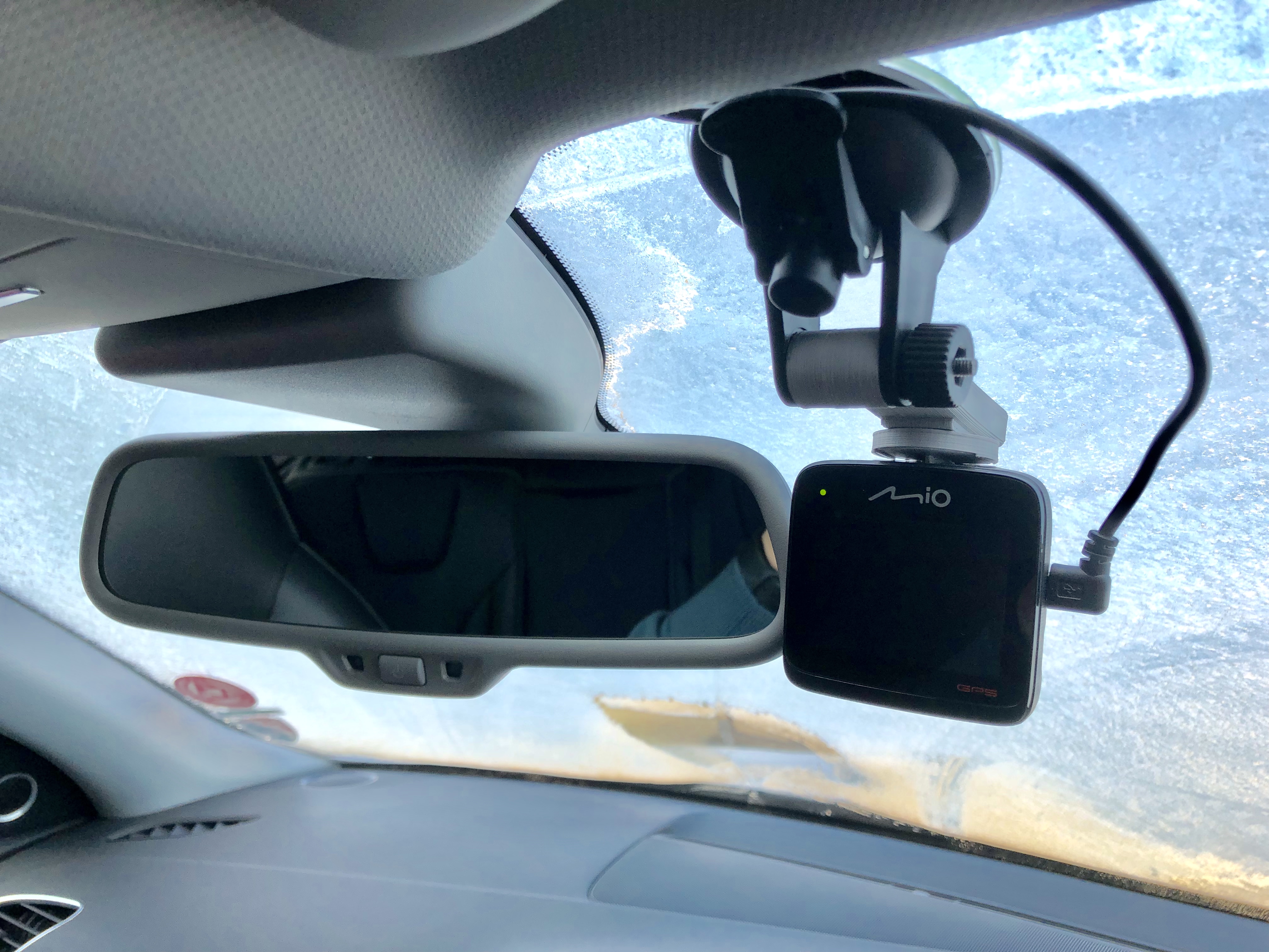

I have my dashcam (it is a Mio model) hard wired into the console light using this:
https://www.amazon.co.uk/gp/product/B00 ... UTF8&psc=1
You might need a different adapter if you were to go down this route. Halfords would not / could not fit this and I suspect Audi would decline too. An Automotive electrician might. I did it myself
