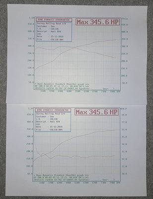

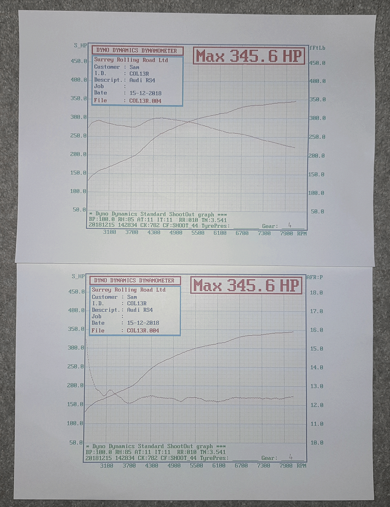

I was expecting lower figures, just not THAT low!!! The new engine was super tight when running it in and after that period, it never quite had the zing my original engine had at the top end, say 5000+rpm. The dyno graph curve kinda supports that, even if you ignore the numbers. AFR figures were spot on too.
Graph for anyone interested, click image to enlarge:
Surrey Rolling Road - Dyno result
Yes, the test is just like what we would do for the B7's. How we go about it, is just slightly different now as the ECU technology has changed. But the engines are very similar hence what works for one generation, should be ok for another within reason.
I'm doing all this data collecting, so that I have a suspected 'unhealthy' baseline. Once done. I shall do some Vacuum tests, pull the inlet manifold for inspection and check PCV for operation/oil build up. The engine ancillaries’ are all original and got swapped over to the new engine; so my manifold/flaps could have some coking - as that's done 34k miles now. At this stage my thinking is to also send off the injectors for flow analysis and whilst there, replace the injector filter baskets with metal versions. Potentially those are a weak point and can fail on performance Audi/VAG models. Finally re-test and see where we're at :P
