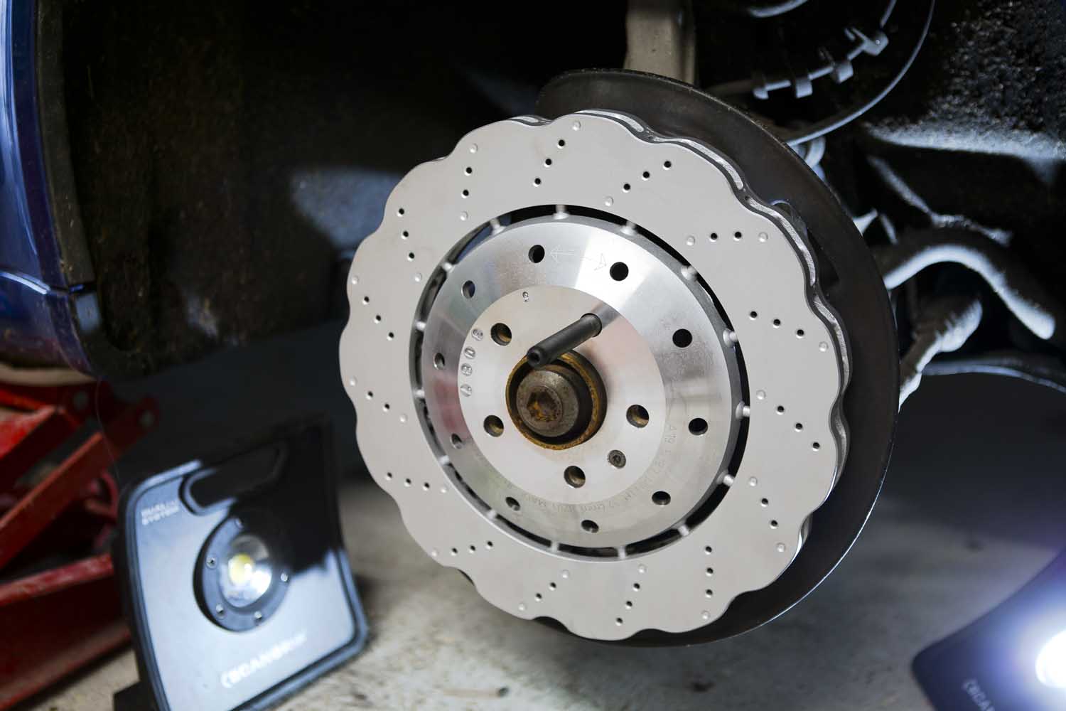

I don't suppose you have pics of the fronts you fitted? To see where the dimples are? Wouldn't want unnecessary drilling haha. That would be awkward. But maybe the cleaning will unmask them anyway. Cheers Sam.

I believe your line of thinking about maintaining structure is most likely, perhaps due to the scalloped nature of the disc design?
Yes, got a picture below of the front discs, rears are similar too - click it to enlarge
