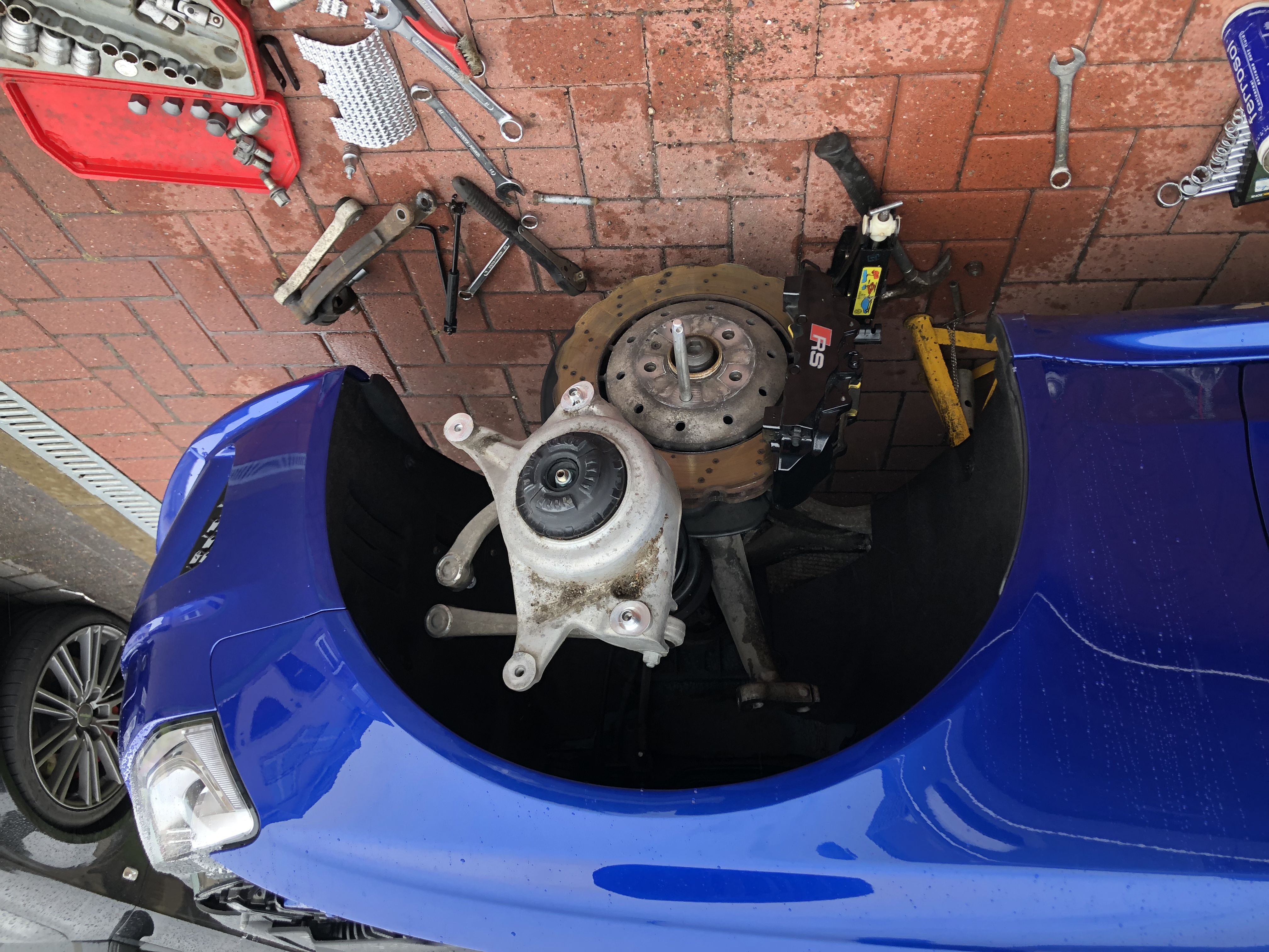

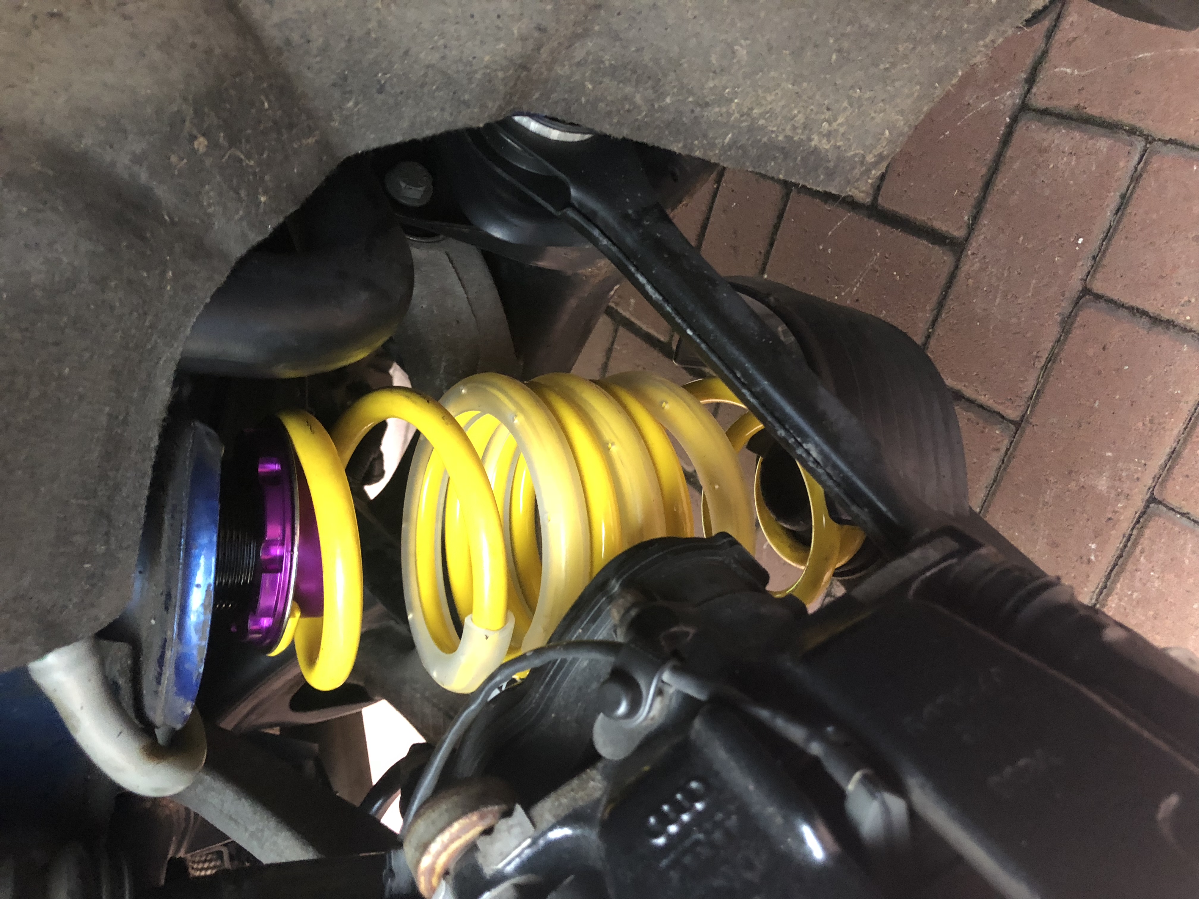

The KW’s need no coding to make them work, that’s the point.
As is typical of Audi, they are better on aftermarket progressive wound springs. Mine is way better on the KW HAS spring kit. Ride height tweaks AND DRC, IMO the best setup.

Post by MK2Golf24v » Fri Oct 12, 2018 9:18 pm
My driveway...... :wink:

MK2Golf24v wrote:My driveway...... :wink:
Excellent. I'd cream in trying to do that myself haha. So aftermarket springs with stock DRC? I dunno man. I just can't be arsed fixing DRC every time it fails haha. Sepang though Image
