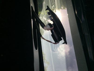

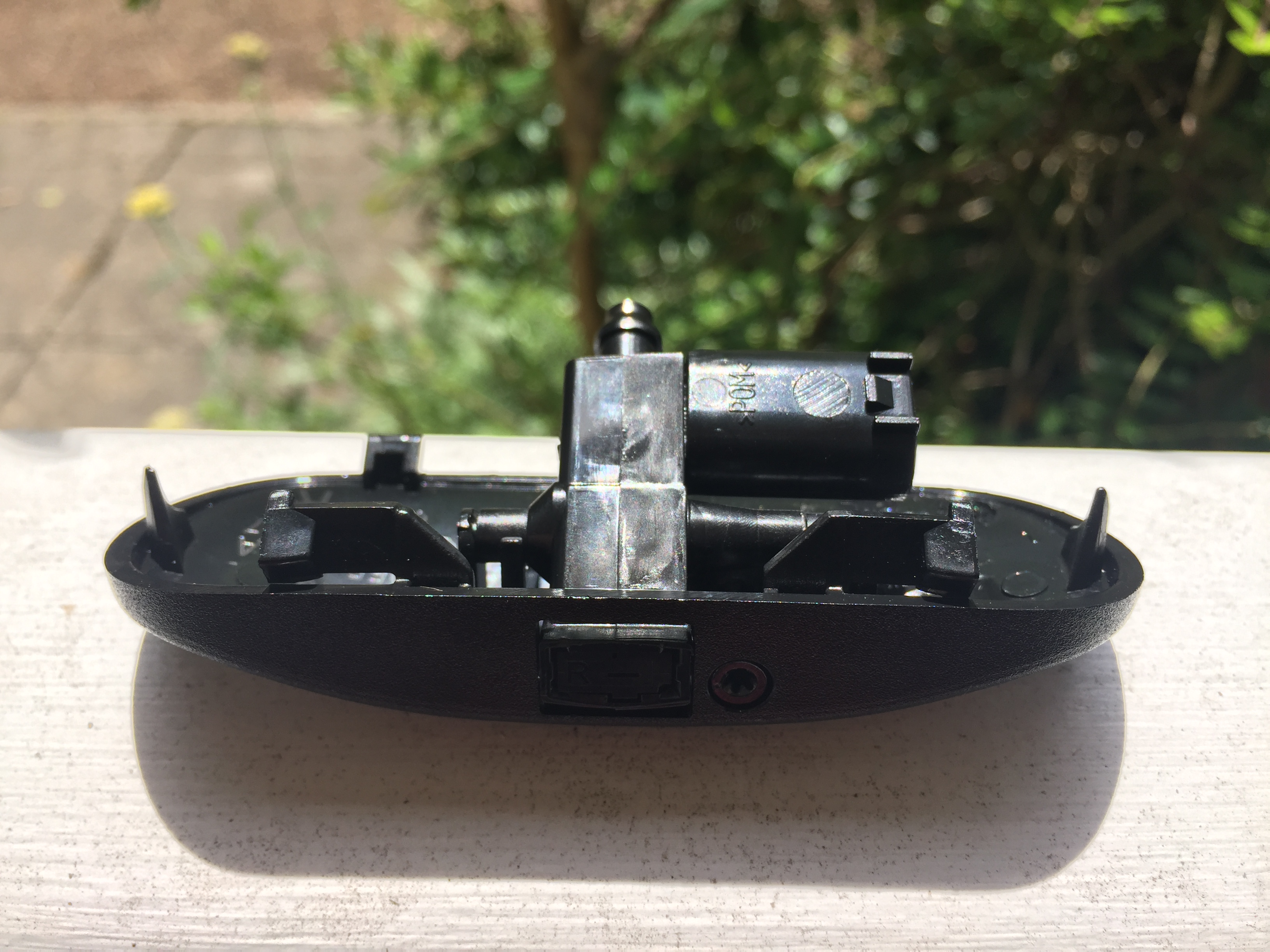

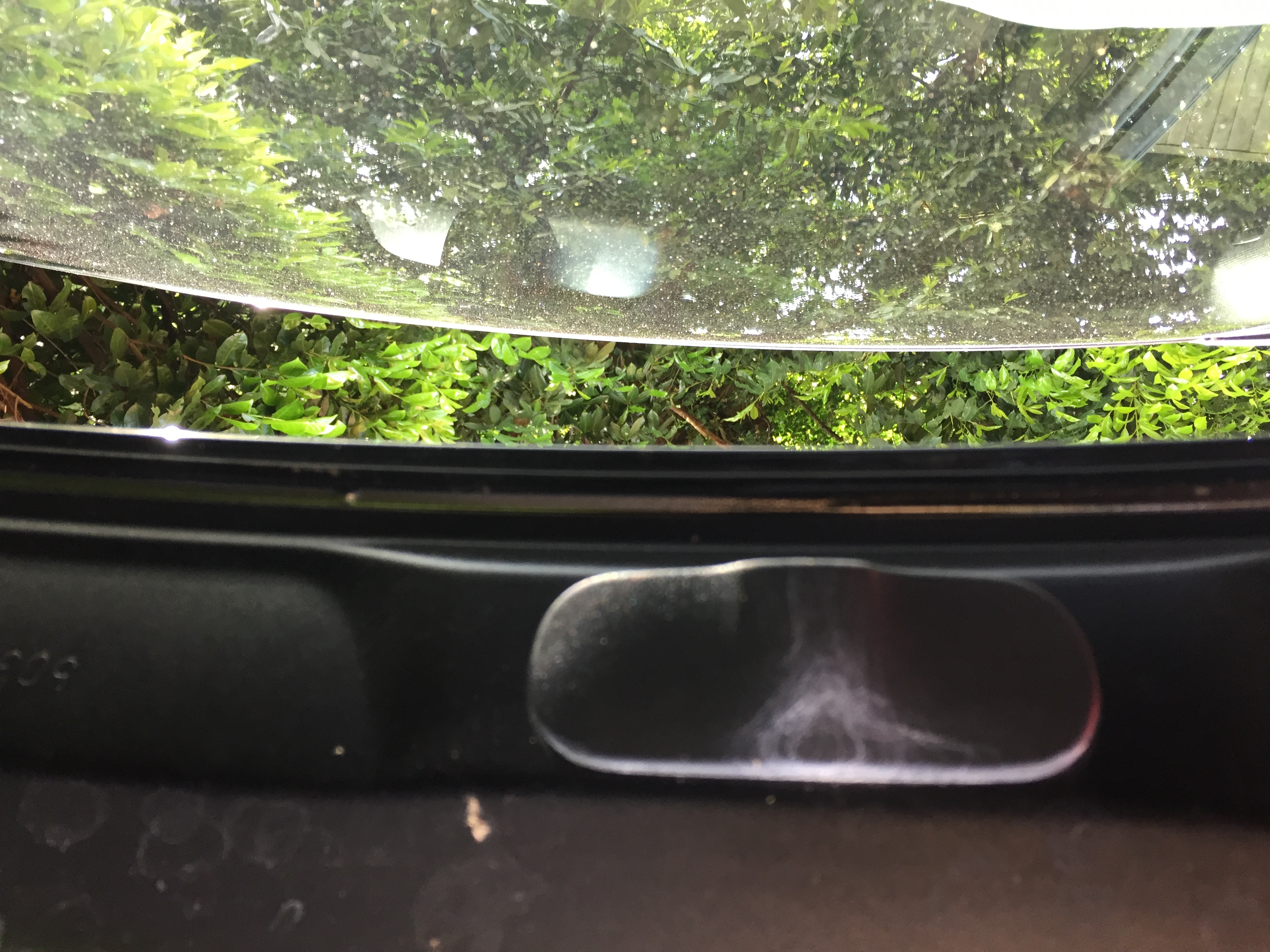

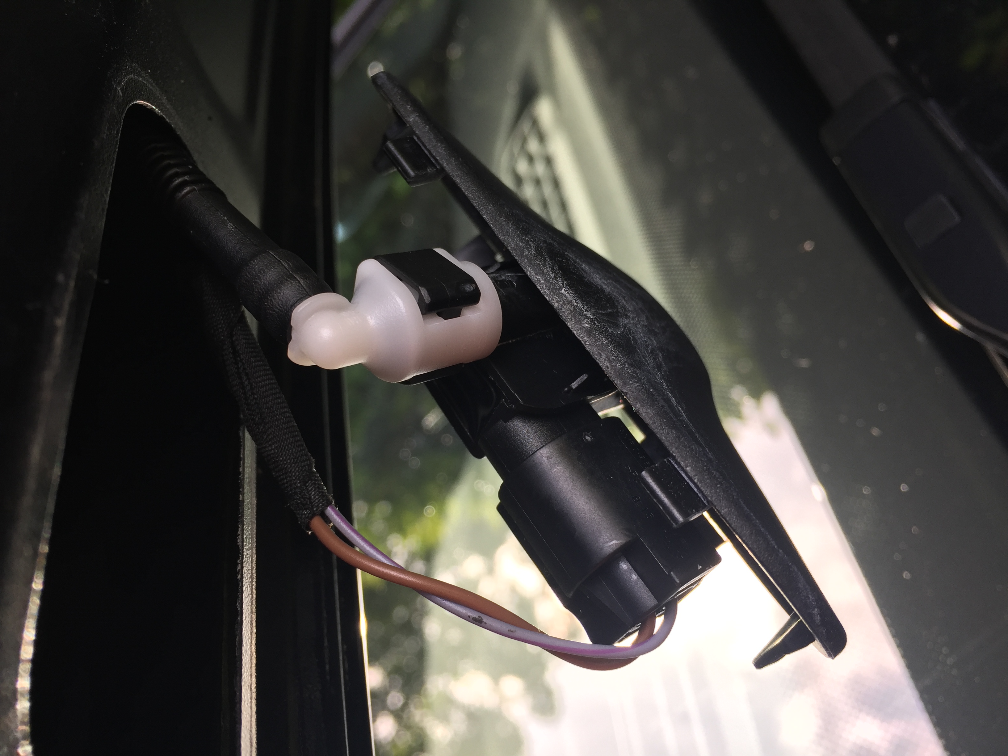

Washer jets arrived today - great service from Cardiff Audi. Total time to fit was 5 minutes (including adjustment). The Jet has three main ‘thrusters’ with a general mist for full screen coverage.
Adjustment is done by the star-key adjust at the front, which draws the jets up or pushes them down (jets are already calibrated for width)
Make sure you do one Jet at a time so you can match up the right orientation (for those that forget...
‘Right’ goes on the drivers side...)
Last point to note, on mine at least, the jets are heated... surely the best feature of the car!
