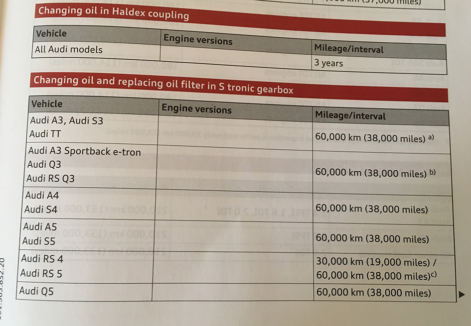

Thought I'd look in the service schedule book.... :audibash:
And the 'c' sub reference refers to 'mechanical part only' (which probably means exchange gearbox lol)

geoffdunk
Posts: 330
Joined: Fri Aug 30, 2013 11:50 am
Location: Norwich, UK
Re: Servicing advice
Post by geoffdunk » Wed Sep 06, 2017 1:34 pm
Correct, 1st 19k then every 38k miles are oil changes and c stands for oil and more to the point filter.

I was told by jack Barclay front diff @ 19, not gearbox

Silver7 wrote:I was told by jack Barclay front diff @ 19, not gearbox
I was told exactly the same, even though I pointed out in the book it specifically states s-tronic oil change at 19k. (As shown in the picture further up)
