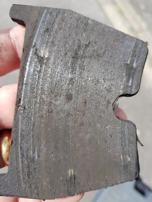

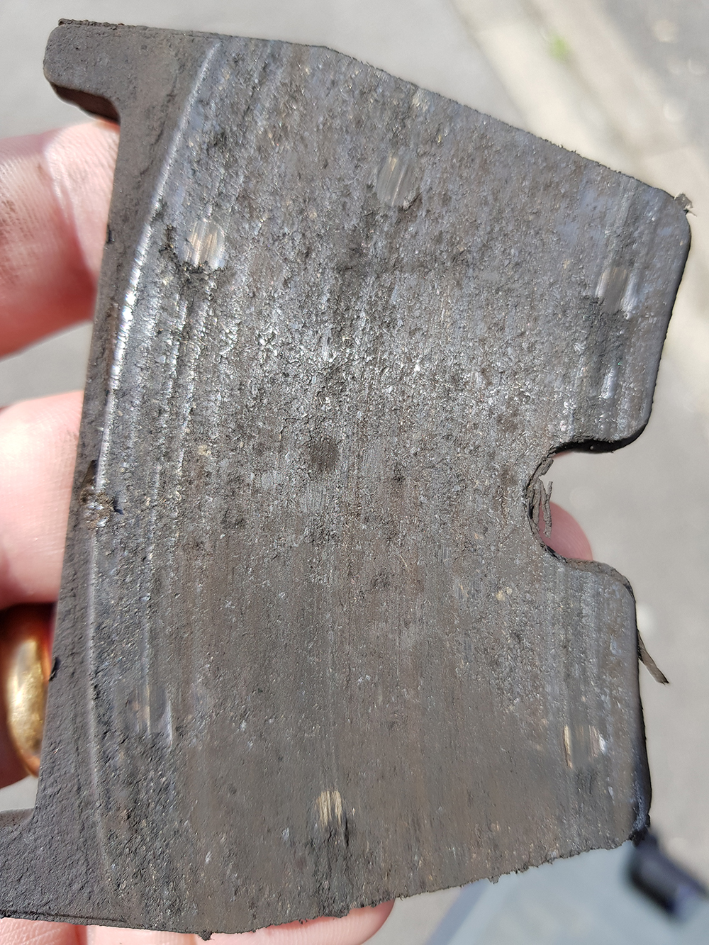

Post by Tweaky » Wed Aug 02, 2017 2:00 pm
I take it all back, this is a picture of one of my pads clearly showing the rivets that hold it all together. This is very bad as they clearly score the discs, and well before the pad warning light comes on. Audi told me my pads and discs were knackered about 3000 to 4000 miles before my pad warning light came on. I will be checking my pads every 5-10k miles from now on i think and replacing them long before they ruin another set of discs. As these pads are by Brembo, it would be interesting to see if Pagid (if you can get them) will suffer the same problem.

Tweaky
Posts: 303
Joined: Wed Mar 24, 2004 5:27 pm
Re: Brakes, please help ?
Post by Tweaky » Thu Aug 03, 2017 9:34 am
Well I've had it from a main dealer at approx. 4k miles so i doubt they tracked it and i haven't, but it does get the occasional spirited run here and there. Admittedly this picture is of the most worn pad as it showed the rivets the most (there was quite a difference in wear levels between the four pads, but even on the least worn they were showing through.
MY18 RS4 Carbon edition in Nardo
Acprc
Posts: 116
Joined: Mon Jul 25, 2016 9:12 pm
Post by Acprc » Thu Aug 03, 2017 10:10 am
I'm just surprised at the wear rate. Mine is driven daily and likewise has a few spirited drives including autobahn's in Germany with stops from 150+. The pads when changed were like chalk and cheese to yours.

Tweaky
Posts: 303
Post by Tweaky » Fri Aug 04, 2017 1:50 pm
The pad wear was uneven across the 4 pads. The worst one is in the picture above and there was still pad left on it. It looks worse than it is in the picture really. The others were not as bad and the inner pads had the least wear on them. There was no brake squeal at all and they worked fine right up to when they were removed.
If you are waiting till the last minute to change them, keep a very close eye on your discs for scoring, as the rivets will come through long before the brake warning light comes on from my experience and you are then in for a much higher repair bill.
