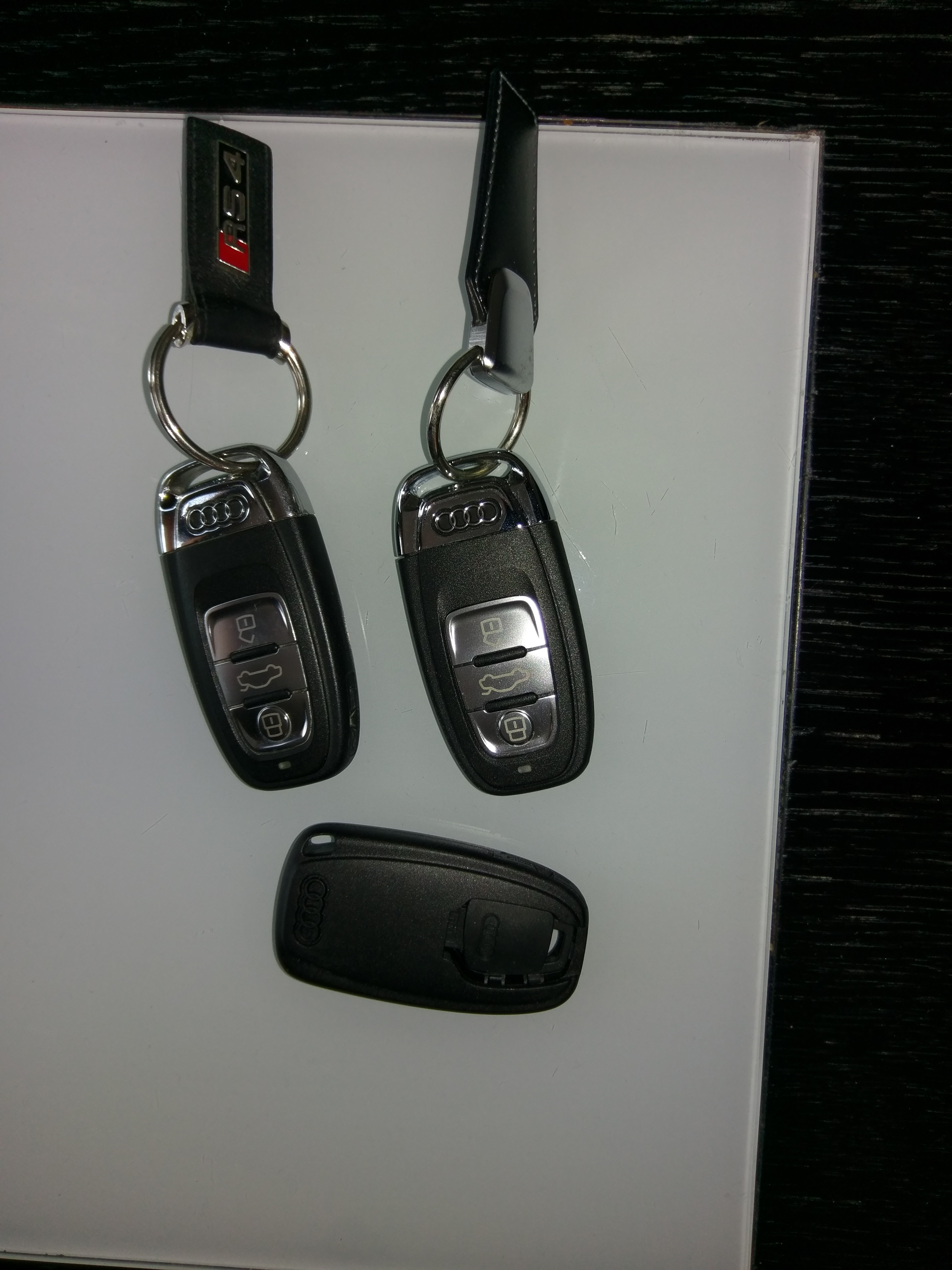

I have 2 remote keys and service key as it came for the factory and 3 show in MMI.
Remove service key body from glove box and put in a safe place, ideally with the plastic key insert, do not leave it in the car.

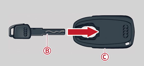

The Emergency key (plastic key) is in 2 parts, the body which sits on the glove box and the blade (plastic) which is with the cars paperwork.

Wrong, only the key part B needs to be kept out of the cat as it has the immobiliser chip.
The other piece is just an adapter to fit the dash.
