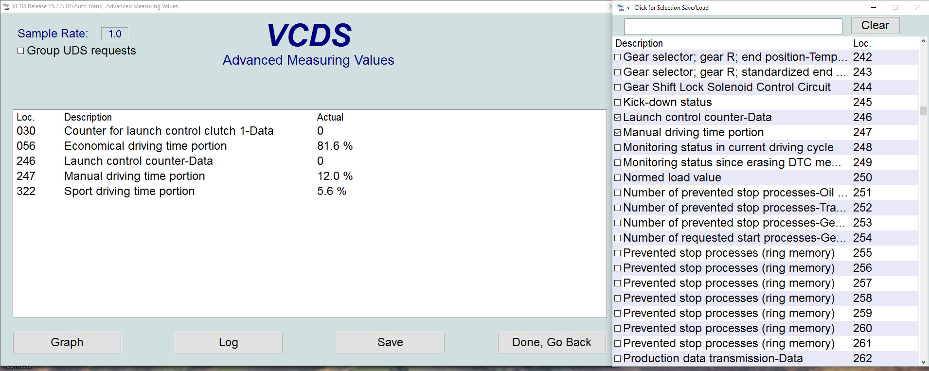

First thing I did when it arrived Gaz, was to check how many launch's it had recorded via VCDS and non have been logged. I thought there may have been one or two in there, but then again, I've not tried out the feature because like you say it's not kind to the car.

What else can you ascertain from the VCDS Sam? I was told by the dealer that nothing like that is recorded. I know Porsche record % time in certain rev ranges etc.
If you can get that info, I'd be very interested in getting hold of the VCDS reader.

Sam - I've not done too much exploring around the modules yet, but this screen shot below is what I found for the Launch Control counter and a few other bits of interest on my own car. I don't really want to pop its cherry to test if the counter works. Perhaps someone else can have a go on their car?

Post by MikeFish » Mon Jun 06, 2016 12:57 pm
Interesting that it logs how much time you spend driving in each mode too. I wonder if Audi would use this to counter a claim for a car with a high percentage of Sport usage.

Post by Surrey Sam » Mon Jun 06, 2016 1:42 pm
A cynic would say so Mike.
I personally think it's more to help product improvement, should there be a trend of component failures. Data is really useful for those scenarios and I imagine that Audi UK/Audi AG will be asking the Dealership for certain data to be pulled from my car; in this case for both diagnosing the fault and to store in their data bank. The VAG Roadside Assistance chap hadn't seen a fault like this in an RS4 before and mentioned the only similar thing he'd seen, was a C7 RS6 which had a thumping gear change from 3rd to 2nd. He made me chuckle though when he first turned up, as he shoved his hand under the arch to feel the tyre tread depth - I smiled and said "it's definitely not a tyre roar noise".
