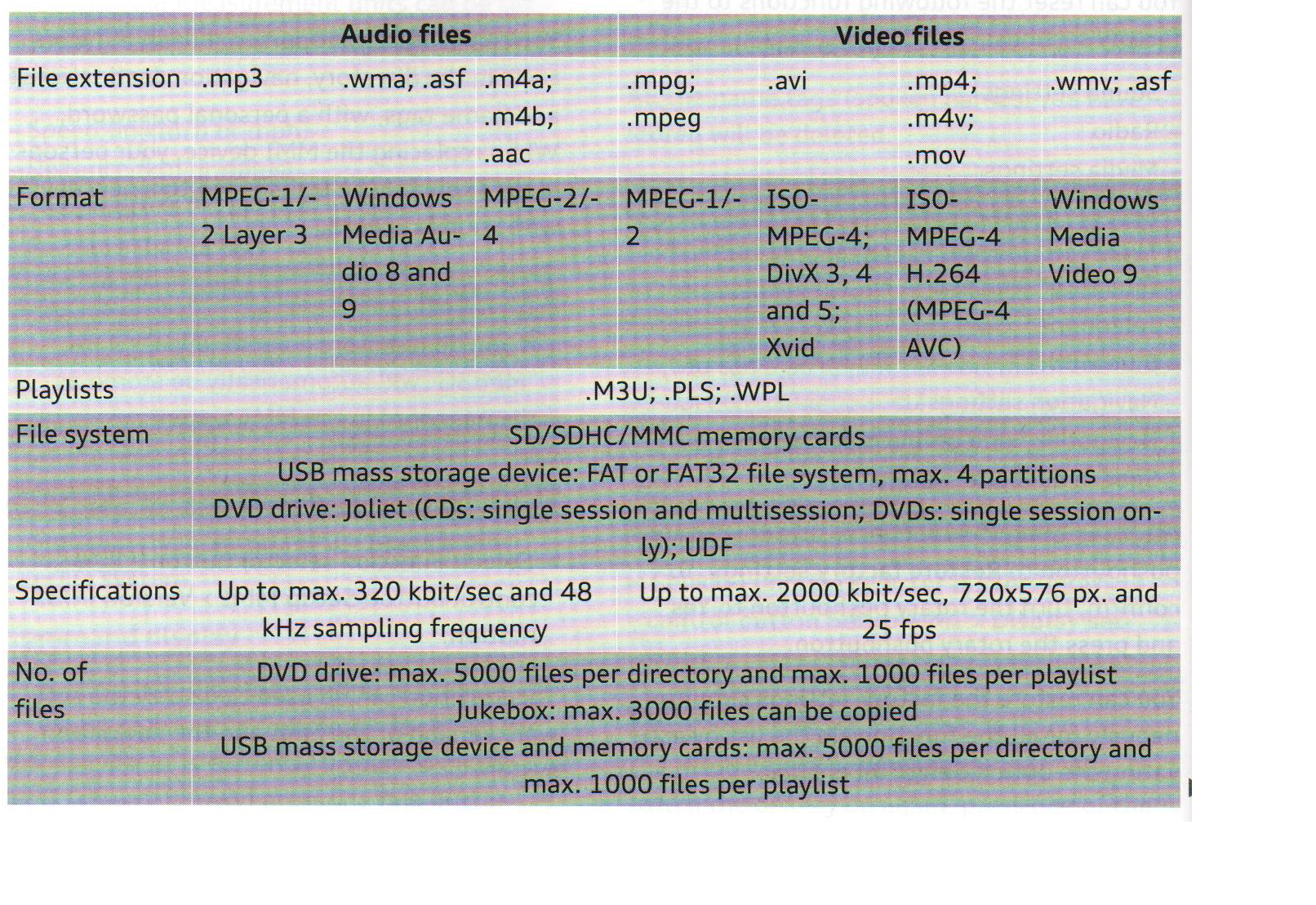

Here is the MMI manual entry for 2015 B8.5 with B&O and all audi and video options included.
Audi AV options

Looks like a no then but worth trying as it's not unheard of to have support for unlisted formats.

Thanks much appreciated, I will try a few formats, the books says the so card much be 32kb max? How odd.

The post above doesn't give a max SD card size, it says SD / SDHC so that will be your limiting size. Not sure how big an SDHC goes up to max, guessing it's 64GB. I can see a couple of 64GB cards on my desk here and they are both SDXC so there might be an overlap at that size.
Further down it says max bitrate for audio files as being 320kbits/sec. Is that what you are talking about?

Apologies, in the car manual it states 32 gb maximum, v odd

SD cards are a maximum of 32Gb.
Bit rate reffers to MP3 files and the like which are not lossless. I rip all my CD's at 320kb/s to eliminate the clipping which makes them sound much better but the files do get bigger obviously.

SD 4GB are not common place any more and harder to get hold of, then again why would you bother if the system can read SDHC 32Gb cards, one for the B7 boys sadly.
SDXC can't be read by the B8.5 3G+ system.
