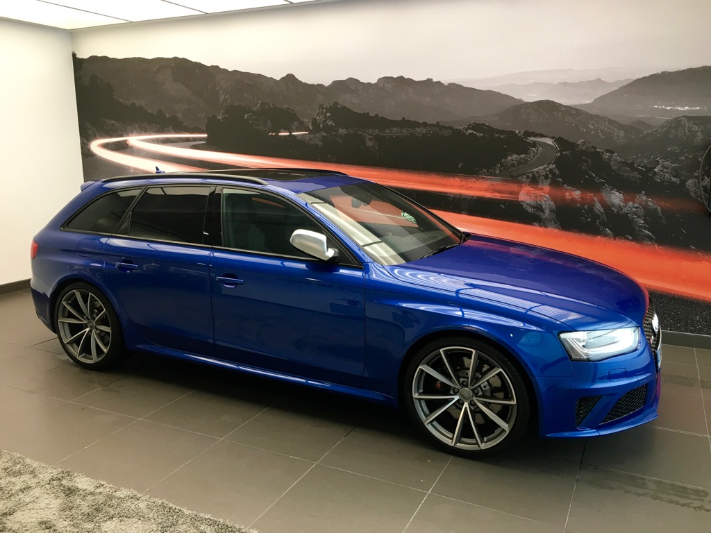

Oh and post a pic of your new toy

Here's a photo I took at the dealer when I picked it up:
