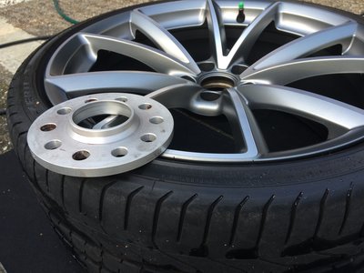

The last day in June I had KW coilovers fitted, they also recommended 10mm H&R hub-centric spacers.

I get the car lifted 10mm and have the 10mm spacers put back on!
I then go to do a 27 mile journey, and here we go it feels crap, the steering becomes less positive and almost lighter ?? So 10 miles into the journey it feels awful and "ding" tyre pressure warning goes off! Obviously have I or haven't I got a puncture......2 miles further (A31 Dorset) this feels bad, I bet the n/s/r, I stop to look .....nothing, I carry on stop again, nothing now I head back towards home to the tyre centre, get there, they check it nothing!
So, yesterday I take the spacers OFF!
Only a local drive and yes, it's back to feeling good!

The purpose of the post is to enquire on anyone else's experience with fitting spacers in particular on a B8 RS4 please. Although I have had a similar opinion/experience from someone that had 8mm spacers fitted to an S5 and didn't like the way it made the car feel.
I did meet a chap at aitp7 that had fitted 10mm spacers but had to change to 5 mm on one axel, we never discussed handling I was ok with it at that time.
Before I bin/sell these spacers any thoughts, I like the look but now I can make the comparison I can't sacrifice handling.

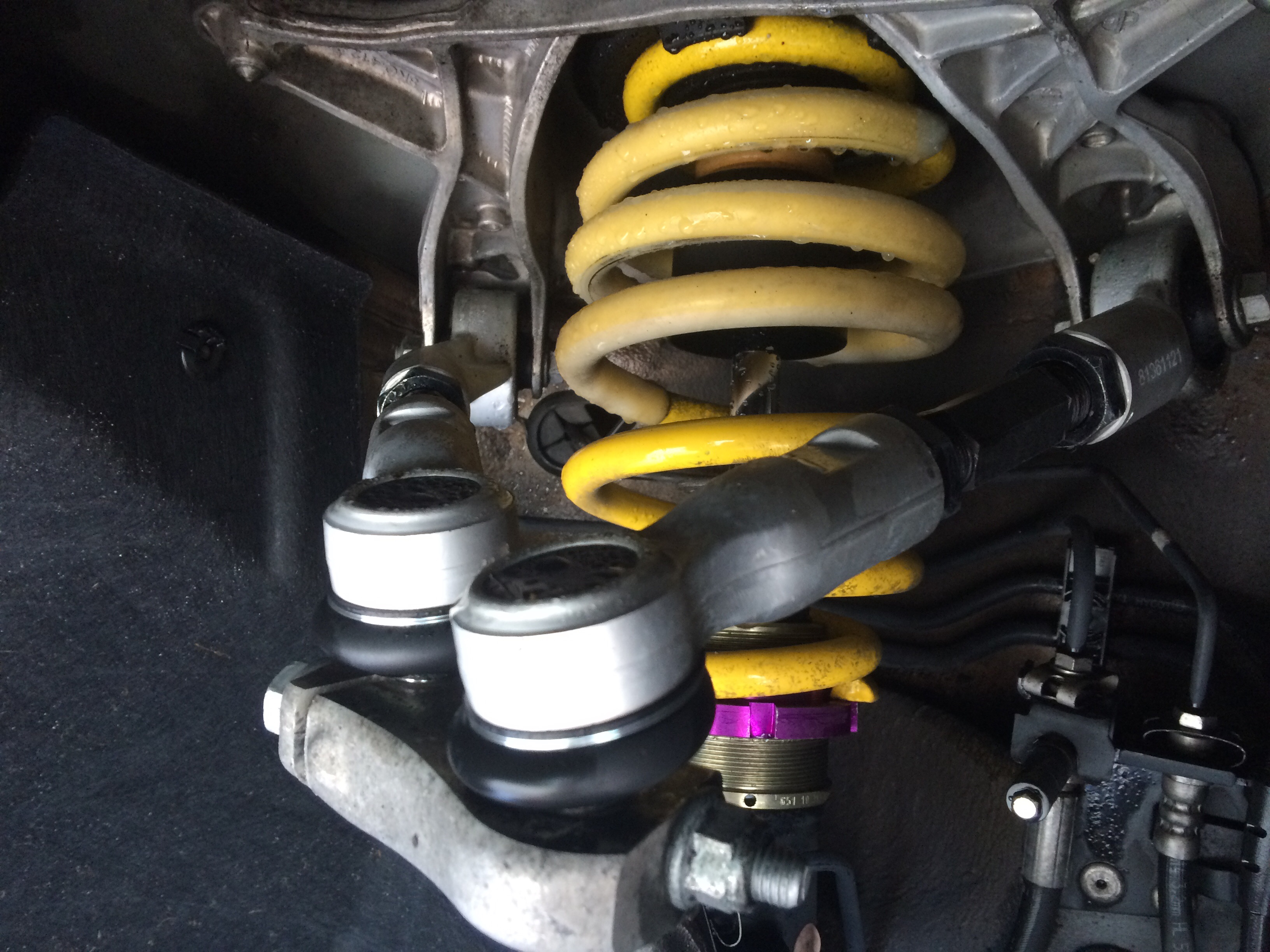

I also have KW coilovers and 034 adjustable control arms, it sounds like you've had some poor advice along the way.

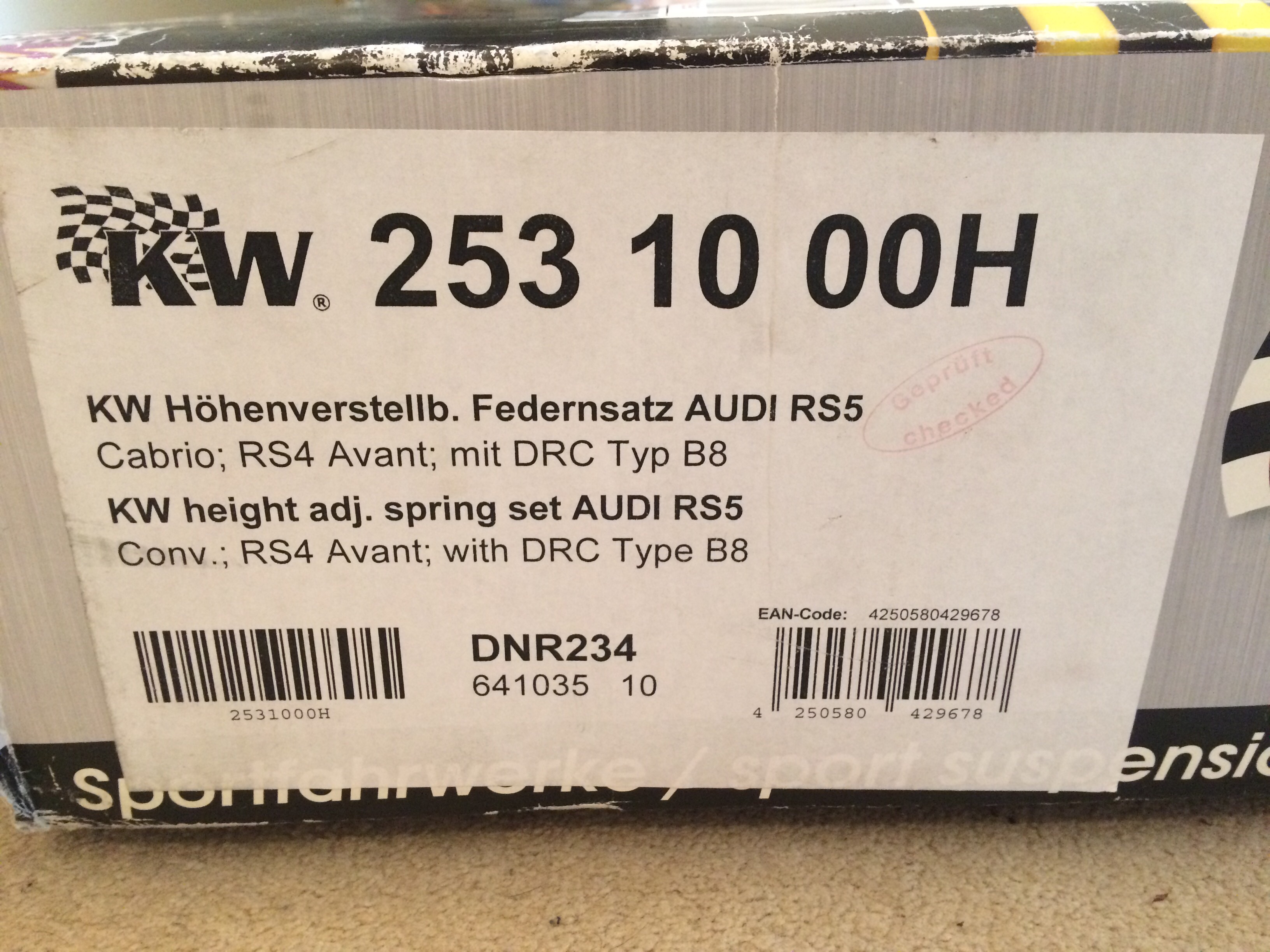

Which KW's did you go for as they seem to have the old style adjustable spring seat on them?

Re: RS4 B8 with KW coilovers and 10mm spacer issues!
This one.
KW have checked that's it's current and correct, 3-4 weeks ago.
Are you running a B8 platform?
Ah...they are the adjustable springs you have not coilovers. I was running those on my B8 S5 with 20mm and 15mm spacers again no issues.Daytona Greg wrote:This one.
Not sure I get that ?
They are termed adjustable "coilover" springs by KW to retain electronic dampner adjustment?
