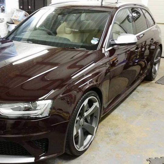

Would love to see how Aston cherry red looks if you can get a pic up ?

Thanks guys really good feedback.. Will try speaking to MRC. I have 1 x photo on me that was just as the car was detailed. It's a strange colour as sometimes it looks very black, some brown and when the sun hits it it's really quite red. It's certainly different, although now seeing the Norgaro blue edition has made me think again. That is my all time fav Audi colour.

That looks lovely. Was that bought through a dealer, who's names escapes me, that always specs/buys RS audi's in that colour ?N7BSE wrote:Thanks guys really good feedback.. Will try speaking to MRC. I have 1 x photo on me that was just as the car was detailed. It's a strange colour as sometimes it looks very black, some brown and when the sun hits it it's really quite red. It's certainly different, although now seeing the Norgaro blue edition has made me think again. That is my all time fav Audi colour.
Sorry, I know that's not much help, but I can't for the life of me remember their name - normally trade a lot of ferraris and bentleys too
How does the Akrapovic sound ? It's a serious consideration for me when my next b8 arrives in sept ?

And looks like a cream exclusive interior .... Very nice ... Would have loved to tick that box but the $ just didn't make sense
The colour is, in traditional Aston terms "Dubonnet Rosso"
I never could quite get excited by it on DB6's etc etc but mainly as in those days as a colour in Australia it didn't endure well. Looks good on yours though

Yes it was from Bramley ( they have 1 client) who seems to order all his cars in that colour/spec, was 1 year old with 2200 miles. The spec was amazing so I was really happy with it. They are currently selling his RS6 in the same colour. The Akropovic sounds amazing I was always a bit put off with the costs of them over some of the competition but now would say it's the best exhaust I have ever owned. The noise is brilliant!

Bramley ! That's it. I'm sure at 38 I'm losing my marbles alreadyN7BSE wrote:Yes it was from Bramley ( they have 1 client) who seems to order all his cars in that colour/spec, was 1 year old with 2200 miles. The spec was amazing so I was really happy with it. They are currently selling his RS6 in the same colour. The Akropovic sounds amazing I was always a bit put off with the costs of them over some of the competition but now would say it's the best exhaust I have ever owned. The noise is brilliant!
I looked lovingly at that car on their website when it first came up, beautiful colour and spec
Can't have been far off 78-80k for that spec. Pretty much every box ticked
Re the Akrapovic, how easy is it to live with day to day when the valves are closed ?
I'm so tempted having heard akra systems on other cars with great results. Love the carbon exhaust trims too

There was an RS3 as well. Newbury supplied them all.
Combo doesn't float my boat, I really have a thing about beige (sand in Audi speak) interiors!
It's the second time they've had the RS6 up for sale, sat on their books for months last time.
