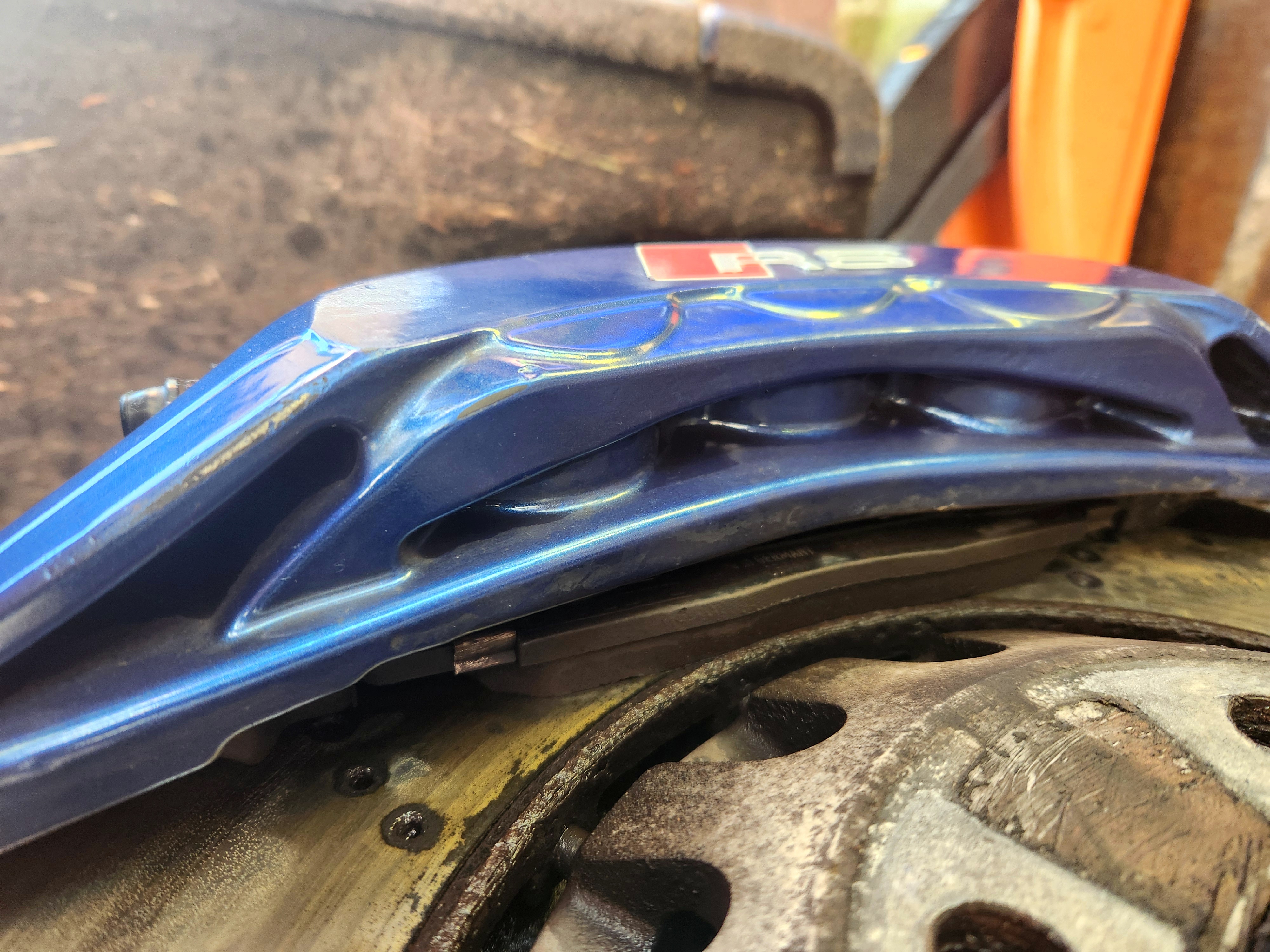

What he said!matthew.lewis2 wrote: ↑Mon Apr 19, 2021 3:02 pm4 pads per caliper for the front, 2pads per caliper at the rear.

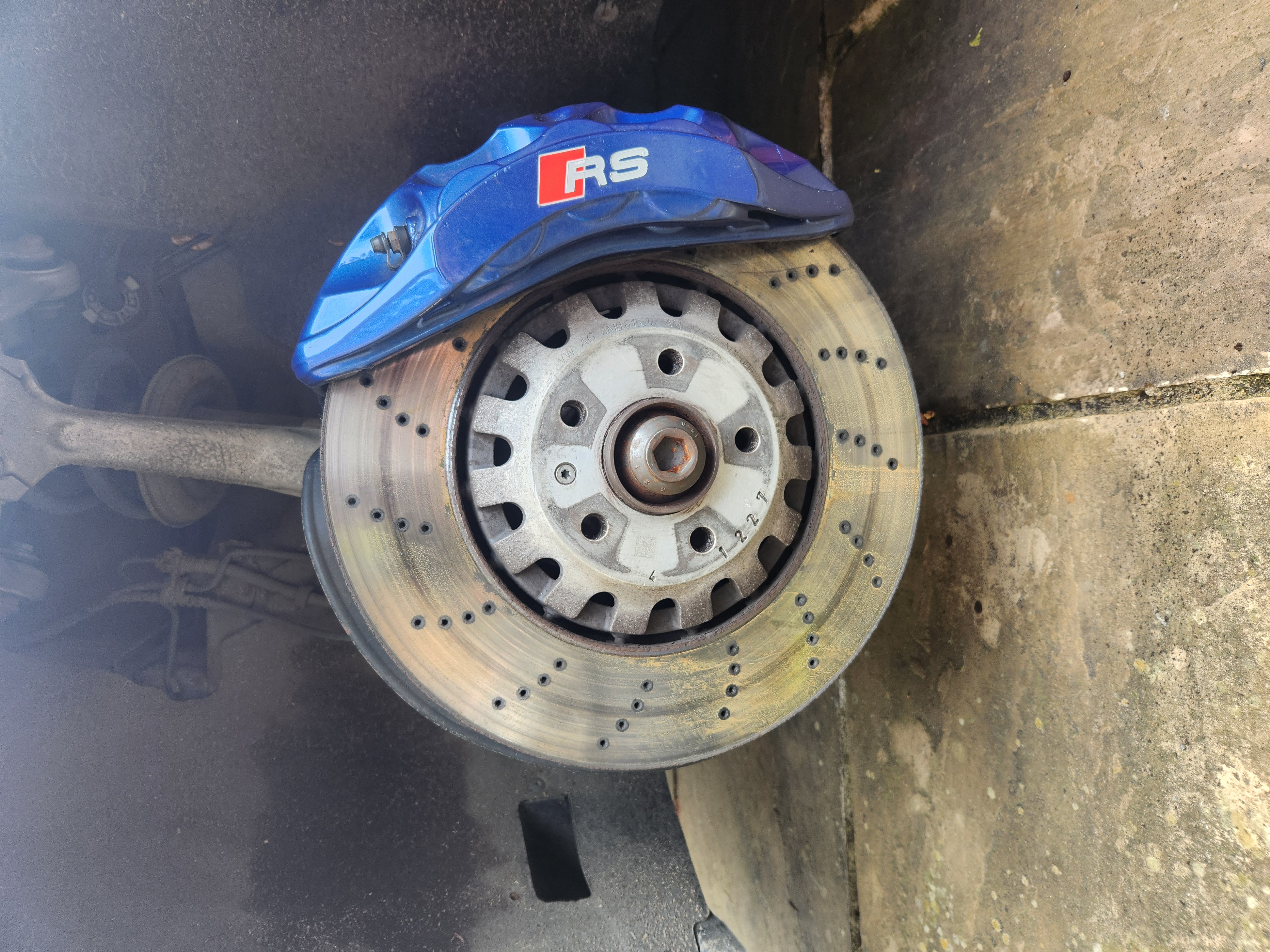

Just a question to bring up an old thread as well.
Going from the standard brake disc size (365) I believe to a bigger 380 set up. Is there anything else needed for the upgrade or do the discs just fit straight on?

Re: B8 RS4 - Brake disc, pads and hoses - Available parts listed in this thread
The dust shields at the front might need removing/modification/changing to the dust shields used in the ceramic braked option (I may be wrong there and it might be due to me stretching to 385mm discs).
The callipers will also need spacers.

Brilliant thank you.
The spacers you mentioned, are you referring to normal wheel spacers or a specific type of spacer for the brake callipers? If you could show an image so I’m clear.
The supplier of the upgraded brake kit should also be supplying spacers so that the caliper is moved an equal distance away, otherwise when the new larger disk is fitted the caliper will be too far away from the holes it needs to be bolted into.
I have the Reyland kit and they are a superb supplier.

Afternoon all
Having read through these posts about discs/pads etc it sounds like a personnal prefernce to all. My front discs aren't the wavy ones, think Zimmerman but cant be sure. Question is, is there a massive difference between the two brands? Also with the Reyland discs, how do they fit with the dust sheilds on?
But, have also read in this thread that the front caliper has 4 pads per caliper?!! Is this correct? Only checked mine the other week as put a ceramic coating on wheels, 2 pads per caliper!! Which is correct?
Many thanks
