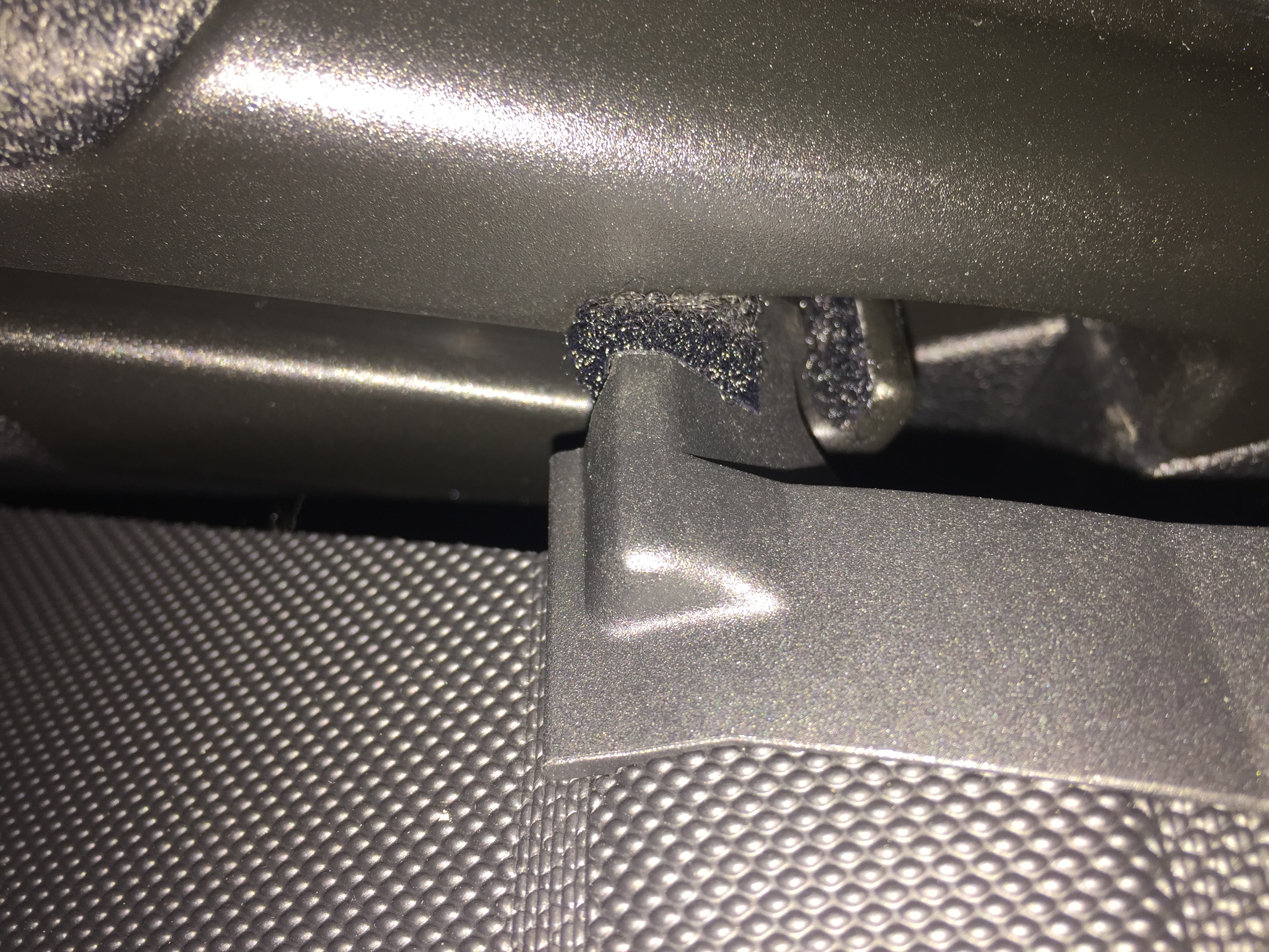

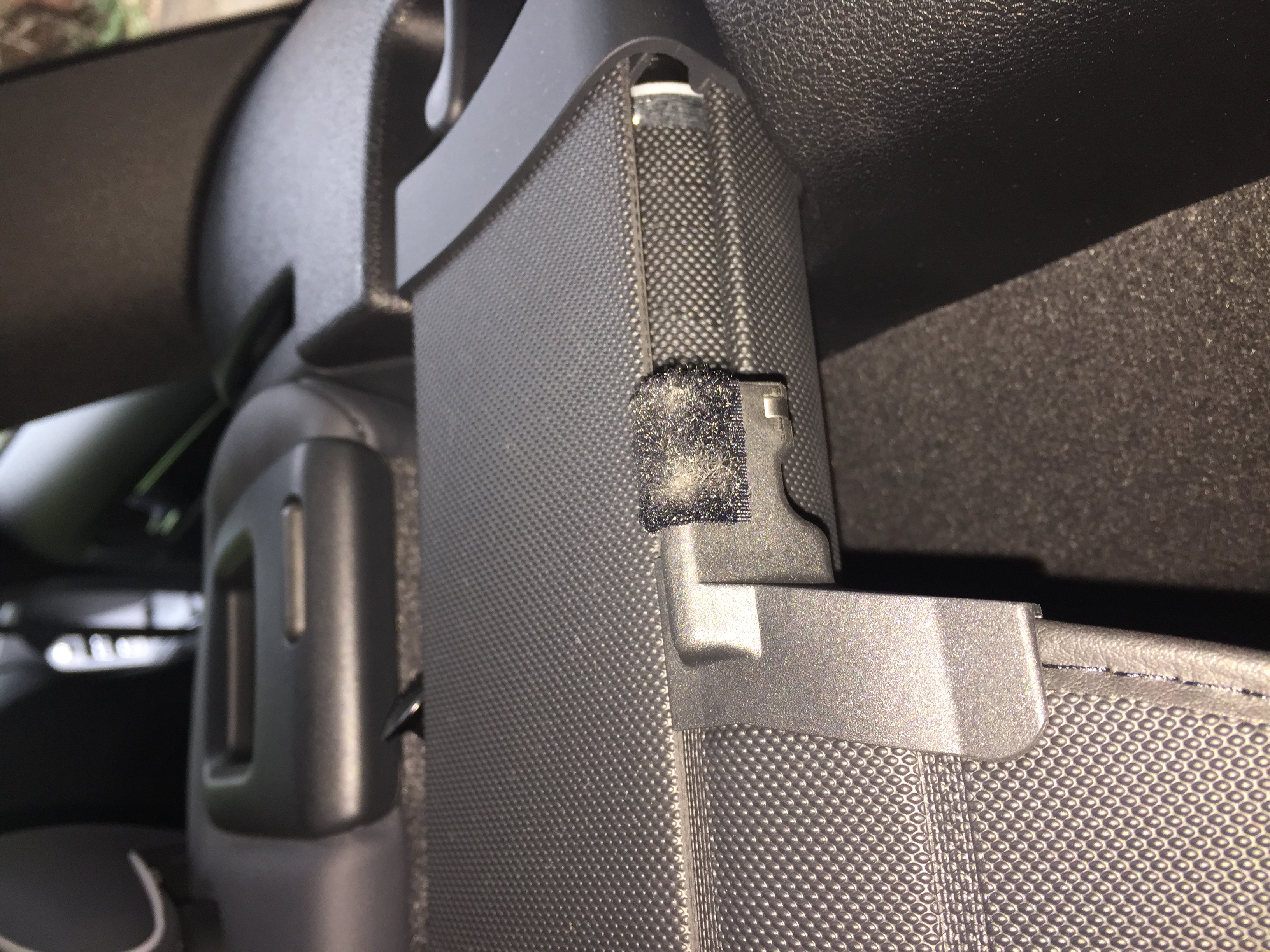

Latest fix done... boot cover rattle
Bought some cheap velcro online and affixed the loop side to both the cover and also a small strip to the indent.
Has worked perfectly
N.B. Haven’t yet decided on whether it needs trimming yet, I left it wide to cover the full width when at the top of the run. Which obviously you can see and very unlikely to drive with it in that position, so probably will....

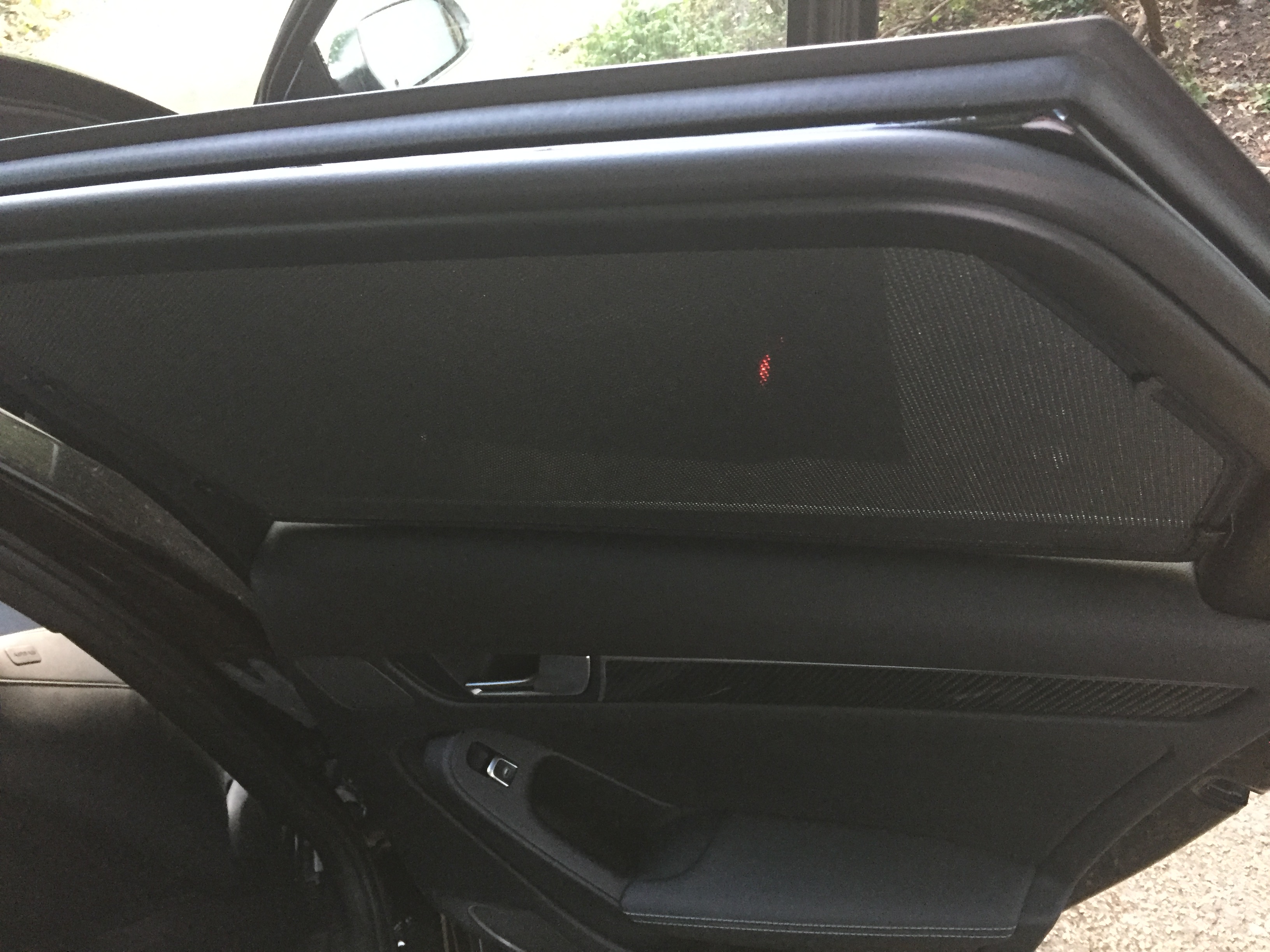

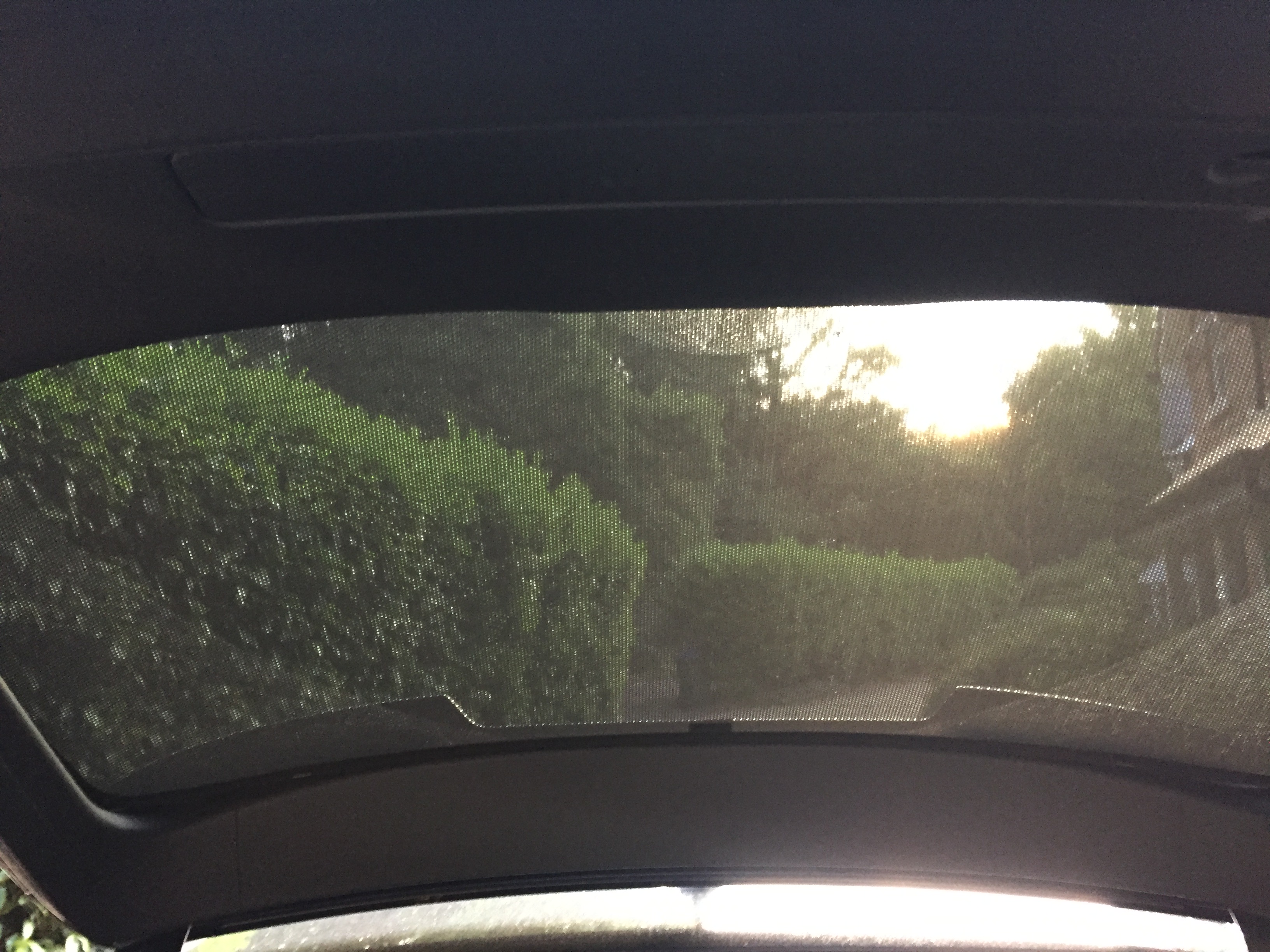

With all this hot weather and my two year old regularly getting sweaty in her car seat (despite having the tinted windows and a/c on full blast - might need a regas) I decided to keep an eye out for the retrofit Audi sunblinds.
Low and behold a full Kit turned up last week and £80 later I have just installed them. Looks smart and has kept quite a bit of heat out already and just 1/2 day so far
My only criticism are the clips on the rear windows are unsightly when the blinds aren’t in so I might see if I can order a bag in from Audi so I can remove them for the next decade of cold weather once this unusual hot weather subsides!
Will get some pictures up later.

Couple of pictures of the sun blinds. Been an absolute godsend the last few days - car much cooler even though it’s parked up in the sun at the station car park...

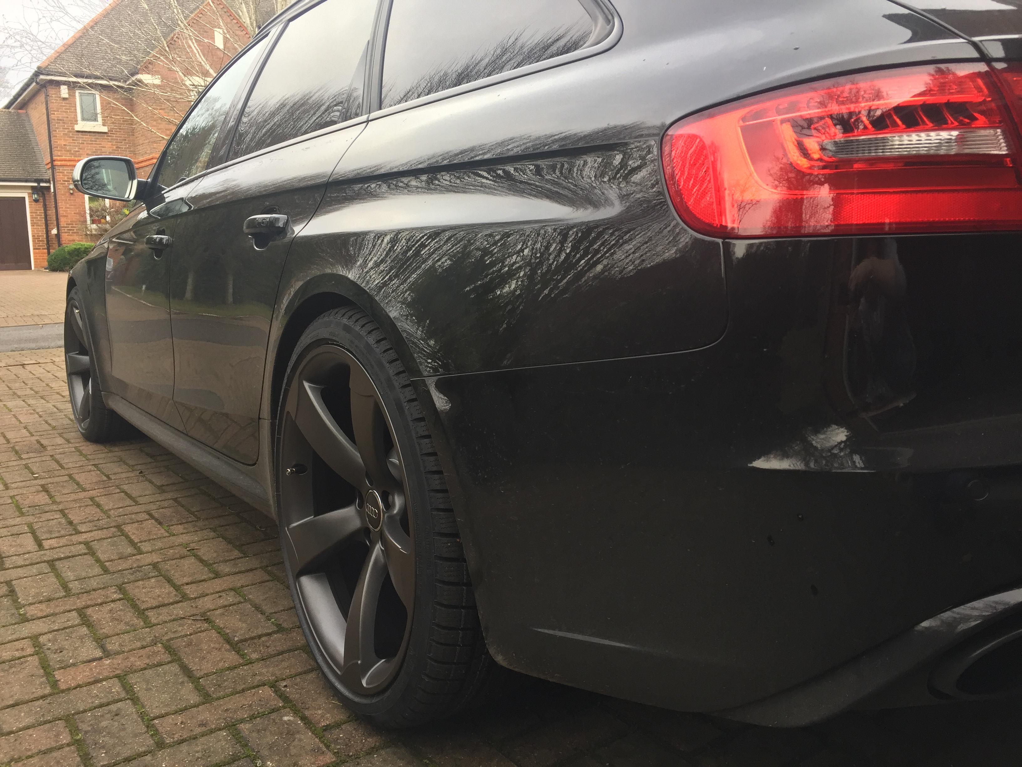

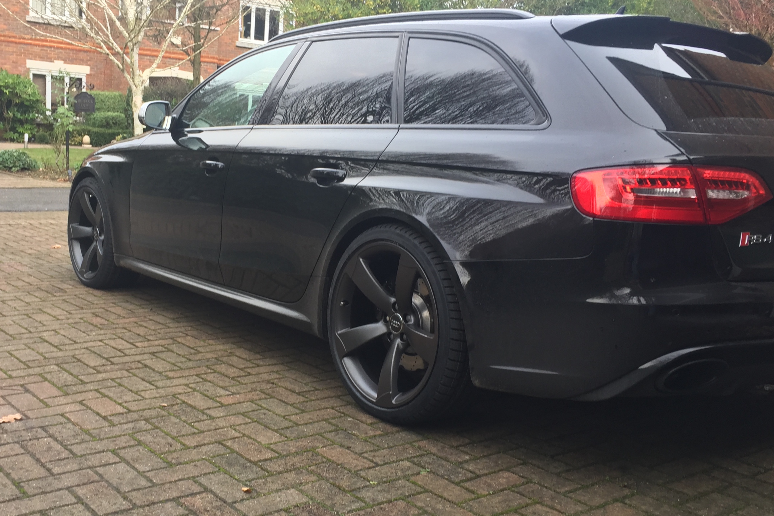

Finally made a decision on winter wheels and tyres.... 20” Rotors and Continental WinterContacts. 10mm spacers on. Just need to buy a different set of wheel locks as these are not compatible with the bolt caps....
V-Spokes off to be stripped and repaired - going for L8AU on those with no diamond edge for now.
Next up is black rings front and back...

Looks far better for having 20"s over winter time, 19"s look lost in the arches.Sammyb349 wrote: ↑Tue Dec 18, 2018 4:45 pmFinally made a decision on winter wheels and tyres.... 20” Rotors and Continental WinterContacts. 10mm spacers on. Just need to buy a different set of wheel locks as these are not compatible with the bolt caps....
To resolve the locking wheel bolt cap issue. I cut some small strips of Velcro and packed out the inside of the cap with both hook and loop sections. I did leave the paper on the side which touch's the bolt, this made them snug and removable. Been spot on for a year
