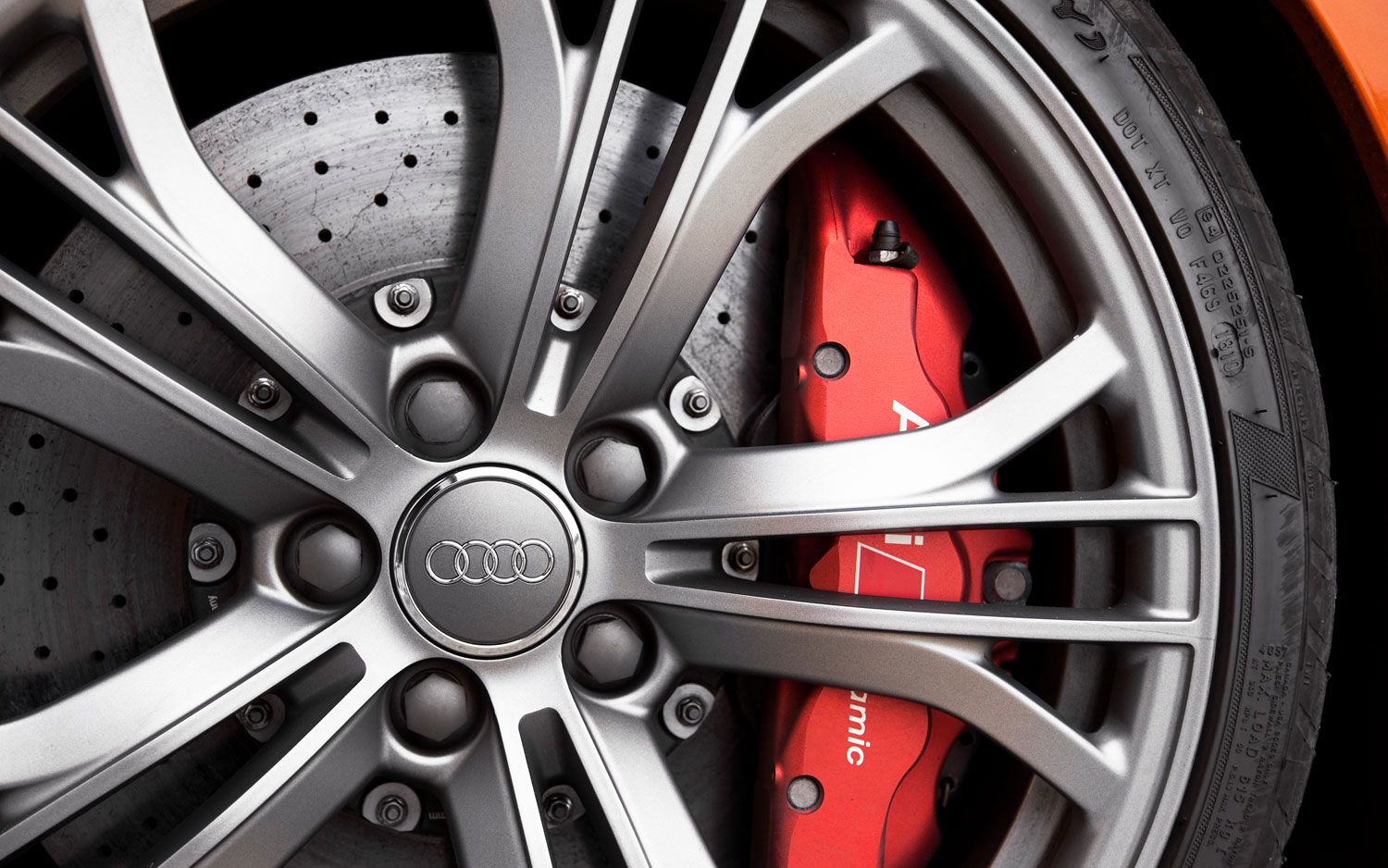

i'd love a set with those anodised red callipers they put on the r8....
