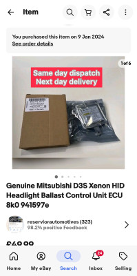

johnnydog
Posts: 488
Joined: Sat Jun 11, 2011 8:24 pm
Re: Headlight removal
Post by johnnydog » Wed Jan 17, 2024 8:18 pm
I've just changed my offside ballast after swapping the bulbs from side to side to confirm it wasn't a defective bulb.
I trawled through all those available - the vast majority if new ones seem to be of Chinese origin, although some claim to have a 5 year warranty. There are several used which are sold as good.
I bought one that appeared to be and was listed as a geninue Mitsubishi unit (as the original) for £50. It came in a authentic VW box with the label, and although it appears we'll made, I really could question whether it is a genuine part or not ( the company have a few negative feedback re copy items sold as genuine).
But it works OK, and for a fraction of the price of one from Audi, and hopefully will continue to do so.
Worth noting that the original VW Group ballasts have a number 4 printed on the top of the aluminium cover plate, above the label. It appears copies (whilst claiming they are genuine) don't.
Also worth checking the suffix on the part no - there are B, C, E and F available. Mine was an E suffix.
