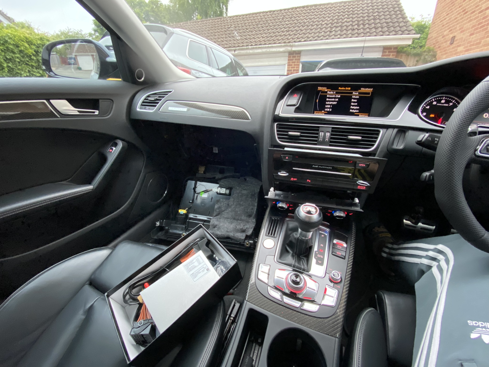

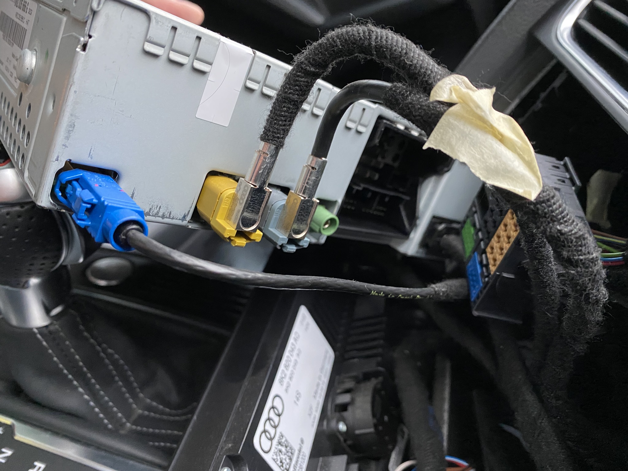

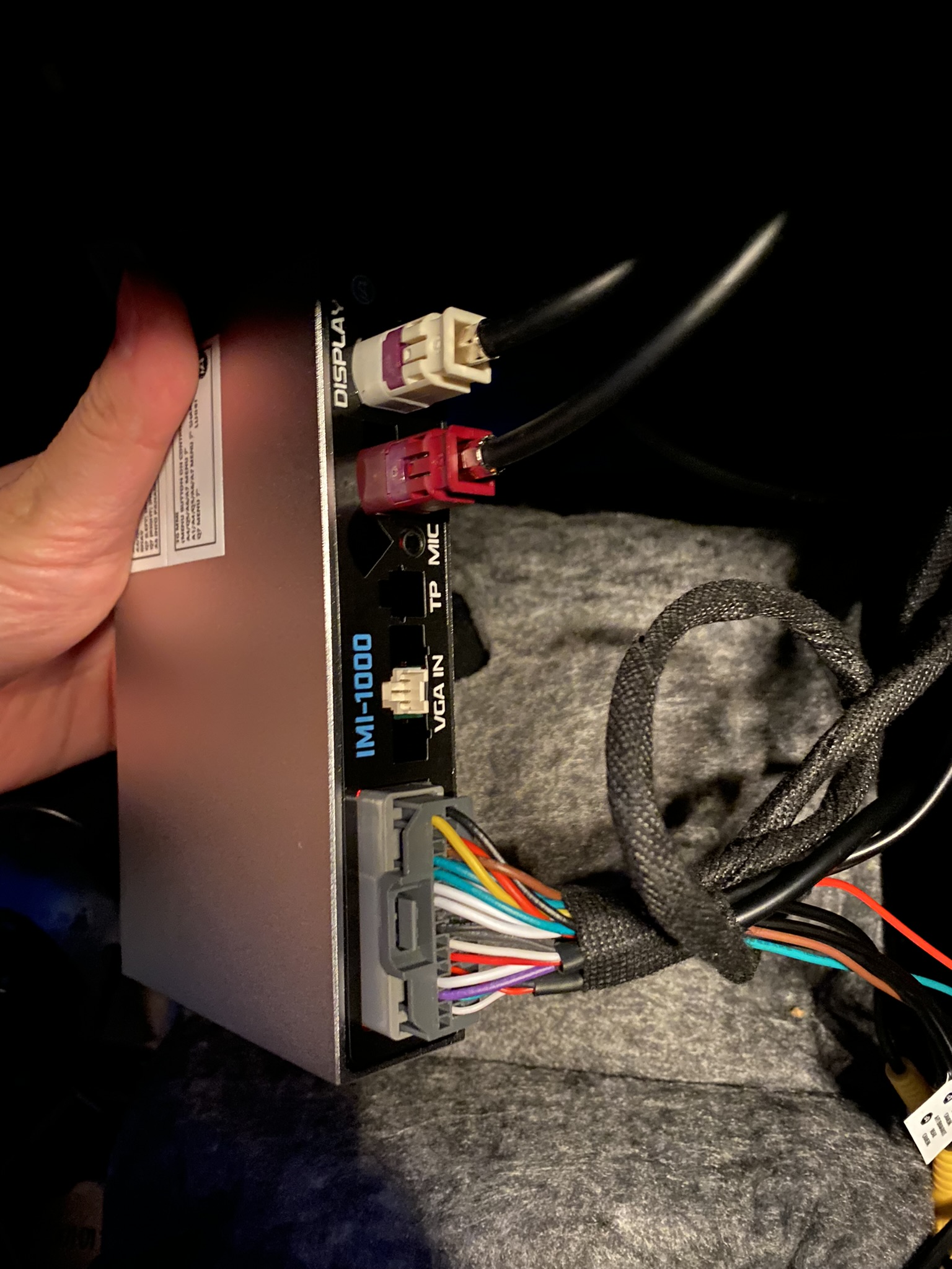

Interim update and a few initial observations:
I fitted it yesterday on a Sunday night in the dark with a head-torch and a normal torch - wouldn't recommend this, you obviously need decent light when doing something like this but it was the only available opportunity and I couldn't wait any longer...
Whatever you do, do not buy cheap MMI / stereo removal keys. It took me 45-60 mins to remove them from the MMI unit once I'd removed it from the dash which as you can imagine was excruciating. After watching multiple YouTube videos and reading various forums it became apparent as to why the keys were a nightmare. You could opt for the cheap keys but you'd need to round off the square edge of the keys where the pin inside the MMI unit mates with the key before inserting otherwise you have to attack the MMI PIN release buttons/mechanism on each side of the unit. Can tell you how if you're caught but it's not worth it. Use Erwin / Etka to obtain part numbers or reach out to somebody for the OEM keys, much easier.
The Installation instructions are at best, minimal. It does not come with an installation manual or an operating manual. The online installation tutorial video and installation web page provide a high level idea of what's required but are not up to my expected standard for a box that costs £400+ and is actually pretty advanced in terms of granularity of available settings. The wire diagram / signal flow diagram show you what needs to be connected and where but best practices in terms of cable routing and positioning of the box etc aren't provided nor are any meaningful information on the various available settings, at a basic level the installation page / video show you what you need to do but I would expect more from a product at this price point that has advanced features as this does. As a comparison, I had a Dension box for an old A3 and the instructions and product support were far more mature and exemplary.
This is by no means a cheap Chinese box though, the assembly of the unit and wiring harness is on point with cable lengths and positioning of terminals absolutely well designed and manufactured. It is a well manufactured, assembled and presented kit.
I had to re-route cables and find a position for the unit, there is adequate space below the MMI unit and cable routing is easy once you untangle the existing car loom to provide proper routing of the cable loom between the various termination points. I can go into more detail if anyone is interested, it's common sense though in a lot of ways.
Initial connection to my Android Pixel 5 was pretty seamless to enable Android Auto wirelessly but again the instructions are non-existent and as I'm pretty technical, I found it fairly intuitive *after* quite a bit of trial and error of the various options and understanding how Android Auto performs it's handshake etc but still would be made a lot easier with a decent operating manual.
It now seems to work pretty seamlessly but I've only spent an hour or two actually living with it since I haven't driven much. I do have a few questions on the applicability of Bluetooth, WiFi and the various connection methods and profiles between the box, the car and my phone. I also have some questions on audio routing, audio gain structure / signal flow and how these interact with my existing Bluetooth and B&O system - I reckon I've worked out most of the options and can provide quite a few tips and tricks on how to get the best out of the box and ensure it's integration is as OEM-esque as it should be but again, if the menu options were defined in a manual then it would be much easier for the general market. Couple of gripes with how it's setup out of the box with things like an audio EQ profile being set that isn't flat and therefore needs to be returned to flat to ensure my B&O DSP has an initial full input signal to then manipulate as per standard Audi B&O DSP offering - but I work in the tech / audio visual industry so know how this stuff works. I do feel that the audio profile isn't as high quality as it normally is from just connecting my phone to the existing car BT media connection but there are a number of options to tweak and I haven't had long enough with it yet so don't let this put you off (I also have a an ear for hi-fi). I do want to find out the exact spec of the box and how the codecs are handled to identify if there is an audible loss but this is me being a geek - for most people, probably wouldn't notice,. The fact that the unit is set to a customised profile out of the box and some other settings such as mic and volume levels are not at full gain, were incorrect when integrating - my thoughts anyway.
The display on the MMI screen needed to reduce the overscan to ensure the top few lines of pixels were reduced so that the top of the display icons weren't cut-off. The menu option for this is available and works perfectly but is named incorrectly i.e. not called overscan, again not a major thing and isn't intuitive but works perfectly.
The integration with the existing MMI / car buttons seems to work OK but once again, through trial and error you have to figure out what each button does. The unit seems reliable and stable, I'm sure it will become second nature over time. I just need more time with it to really find any shortcomings, bugs or idiosyncrasies.
All of this could be mitigated with a really verbose and comprehensive manual, I'm following up with them on a couple of initial questions and will revert back.
Either way, it's much much better than the standard MMI system I have in terms of finally having Google Maps, Spotify and Google Assistant etc. And if it annoys me, I can revert to the standard system with a quick button press.

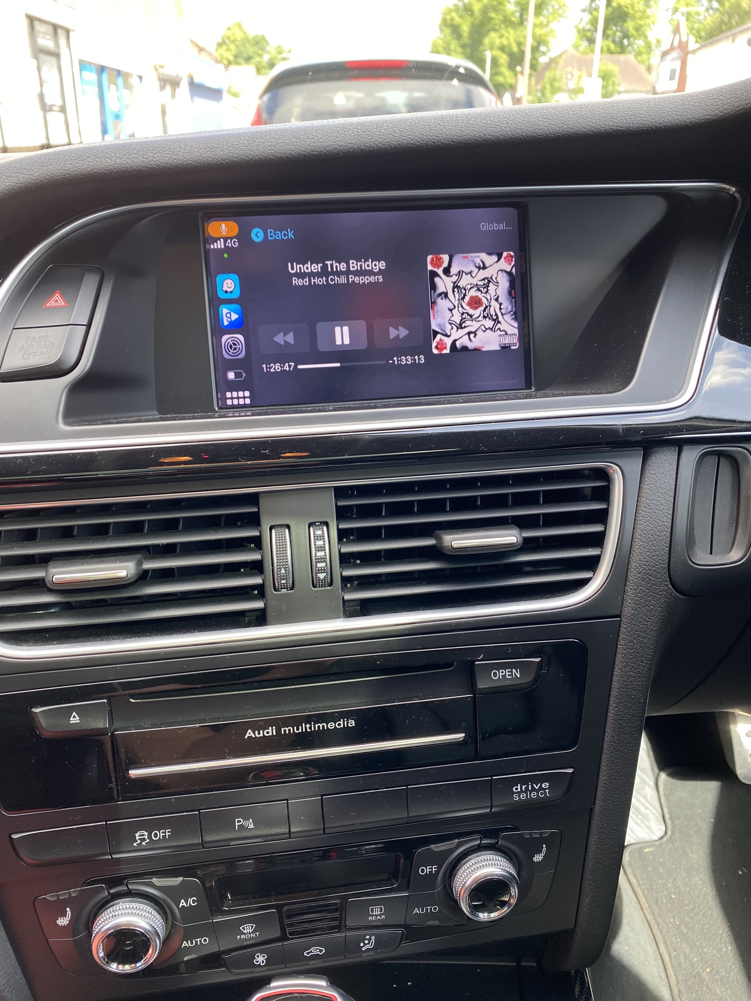

Hi All,
Thought I would post my experience, as I also struggled with the amount of choice available. I ended up going with the plug and play system from Integrated Automotive (https://integratedautomotive.co.uk/prod ... -auto-kit/), as I had read good reviews and installed the unit myself. I am by no means an expert, but I am a reasonably practical with these type of things. After having the unit installed for the best part of 6months/2000miles, below is a list of pros and cons that I have found:
Pros:
- Relatively easy to install (if you're not afraid to unplug a few connectors). The unit sits on top of the glove box (behind the dash) and connects to the harness on the rear of the MMI unit, as well as a couple of other connectors.
- Customer service is excellent. I had a few installation questions, which were emailed back to me within the hour (even at close to midnight).
- Carplay (exactly how I wanted) - Spotify, Global Player, Waze, etc.
- No interference with menus "behind the Carplay screen". I had read other reviews where people using the MMI controls were unknowingly changing settings, etc in the background as the MMI operated as normal behind the Carplay screen
- All controls operate as normal, MMI knob to navigate, volume, skip track, etc. You can use the steering wheel control, but this upsets the binnacle menu.
- Binnacle screen appears as standard. It just has an "Aux" name at the top. Speed, on board computer, etc are all still present.
- Gives the interior a "newer" look
- Wireless connectivity
- You can still operate the Carplay for navigation and use the OEM AMI/DAB for music. However, the sound from the Carplay is not connected, so no spoken instructions will play through the speakers if using this configuration.
- No more map updates!
Cons:
- Instructions could be better for the install. Understandable, these are generic for most Audis, but you can eventually work it out.
- No touch screen, but easily navigated with the existing MMI controls. I personally wasn't too fussed by this, as would have meant taking even more of my dash apart and dreaded finger prints
- Unable to to use built in microphone for phone calls. The unit comes supplied with a microphone that needs routing through the dash (I've still yet to do this, as I was trying to work with the OEM system).
- Occasional drop out/loss of signal when streaming stations, especially if on a drive through rural locations. This is more likely to be down to my iPhone 11 / O2 Network signal drop out, but be under no illusions that this is not as effective as traditional DAB. I'm not sure if this is the same experience with OEM Carplay systems?!
- Occasional failure to connect or system losing signal. Usually a reset phone and/or car sorts this
- I'm not sure if it is related, but occasionally my DAB signal drops out (if I am using the OEM system), but could also be a black out area or just that the DAB is not as functional in the B8 RS4. I had an S3 8V previously and did not notice this as much with the OEM DAB.
- The system is obviously setup for touch screen interfaces, so inevitably there is an amount of scrolling involved. Especially if you want to enter an address in Waze or Google Maps. There are of course ways around this, such as entering the address prior to your journey and just clicking on the last address, etc. once you are in the car.
- Significantly drains my phone battery, but I assume this is the case with OEM Carplay systems. Note that the AMI port is replaced with an Aux plug in cable (the cable is not used, it just fools the car into using the Carplay). If you need to used the AMI to charge your phone, you can still swap these around but the sound quality is not as good.
Overall I am really pleased with the system. 90% of the time it works faultlessly and the other 10% I just switch back to the standard DAB/Sat Nav, if I am unable to reset it on the go.
I'm aware I probably could have got the same unit cheaper elsewhere, but I paid the extra for a UK distributor and any potential help along the way.
Would I recommend it / do it again? 100%!

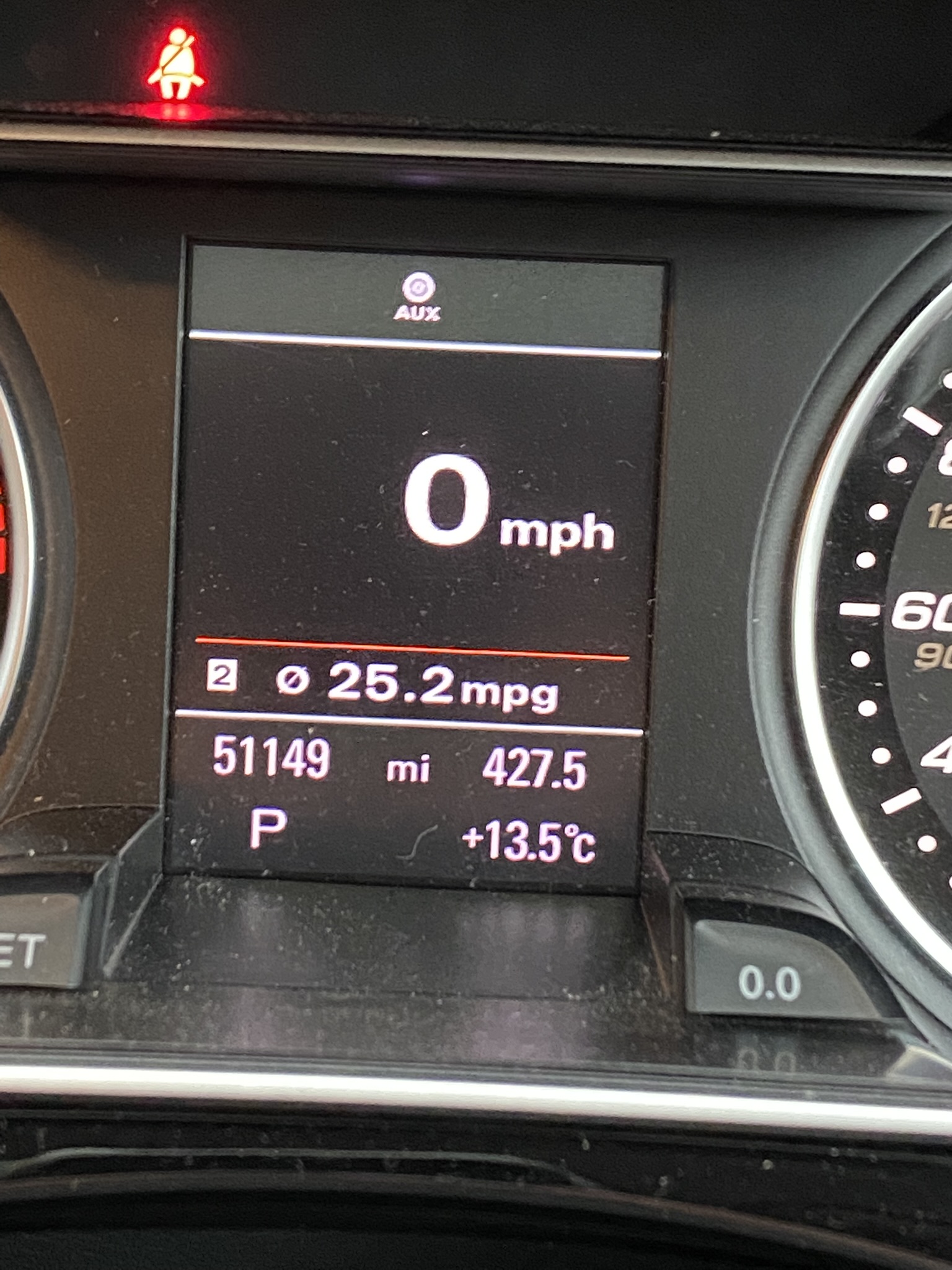

25.2 mpg? How?
