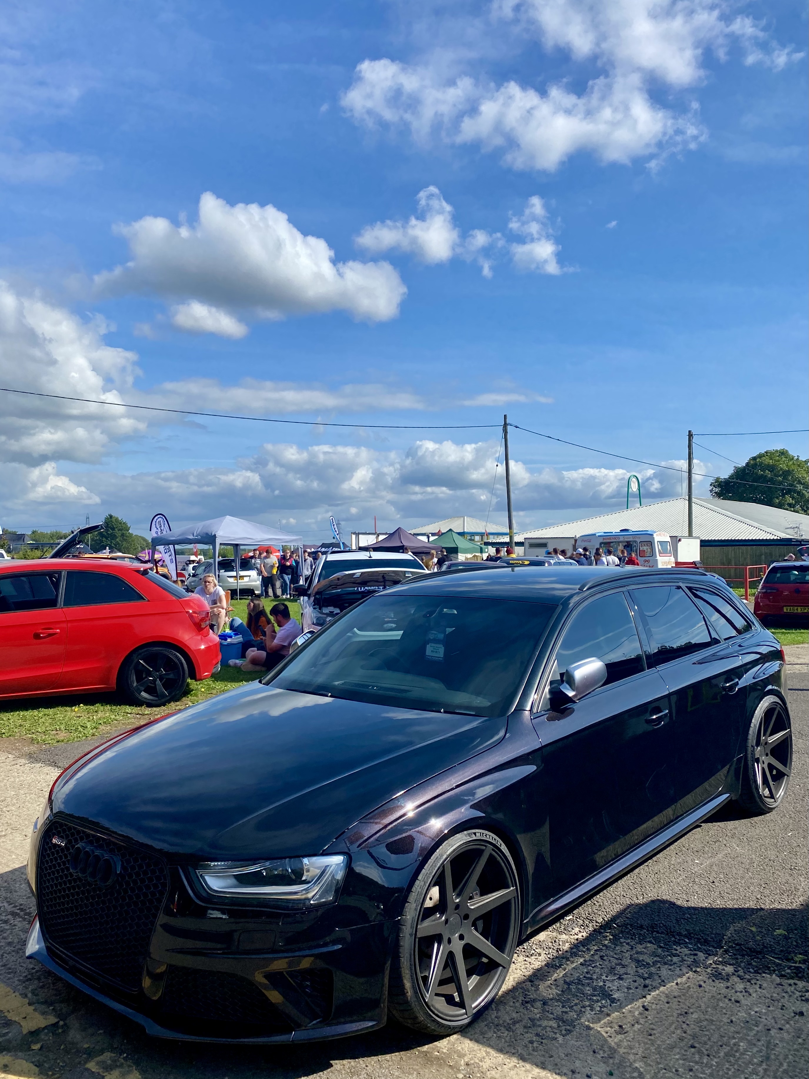

Whilst I didn’t receive any response to my original post, I’m back with an update having opted for the CRS Koni kit.
I made the trip up to CRS performance at the end of August, where Steve fitted the new shocks for me. The H&R springs I have currently are the lower option, so I do have choices for a higher ride height if I ever want to.
Fitting all went well and after a few hours I was on my way. Bearing in mind my only experience of DRC was a faulty system, so it could be amazing and I don’t know what I’m missing, the Koni kit is great. I’ve done a few thousand miles now and the cars still doing everything I need it to. I’m not pushing it to the absolute limit, but for day to day driving it’s spot on.
It’s a very wallet friendly solution to DRC worries, and I can’t see I’d have gained anything from coilovers except the option to go even lower which really isn’t necessary for me. All in all it’s a thumbs up from me!

Love the wheels what are they ? Rotiforms ?
- Neutral
- Posts: 4
- Joined: Wed Aug 04, 2021 8:49 pm
Re: RS4 DRC / Coilovers / Koni CRS performance?
Cheers! they weren’t my choice, they came with the car, but they’re pretty smart.
Rohana RC7, 20x10”. I fitted the Michelin PS4S to keep things grippy!
