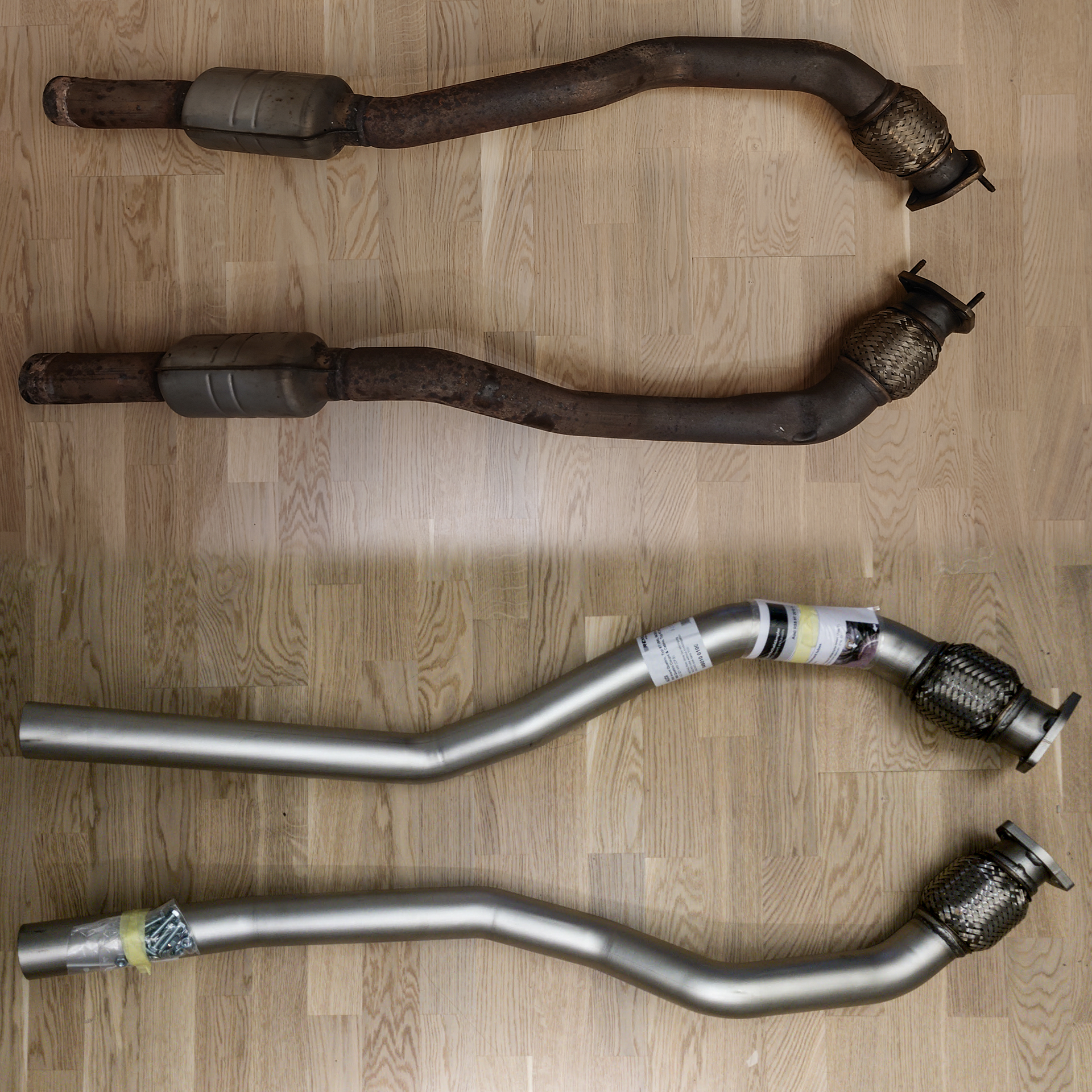

Ok, just got my REMUS mounted. I can here a small different, not at all like when i did my c63 or M4. Will probably remove the middel resonater to an x pipe...

Post by Rs4b8AA » Tue Nov 03, 2020 8:31 pm
here are som photos
