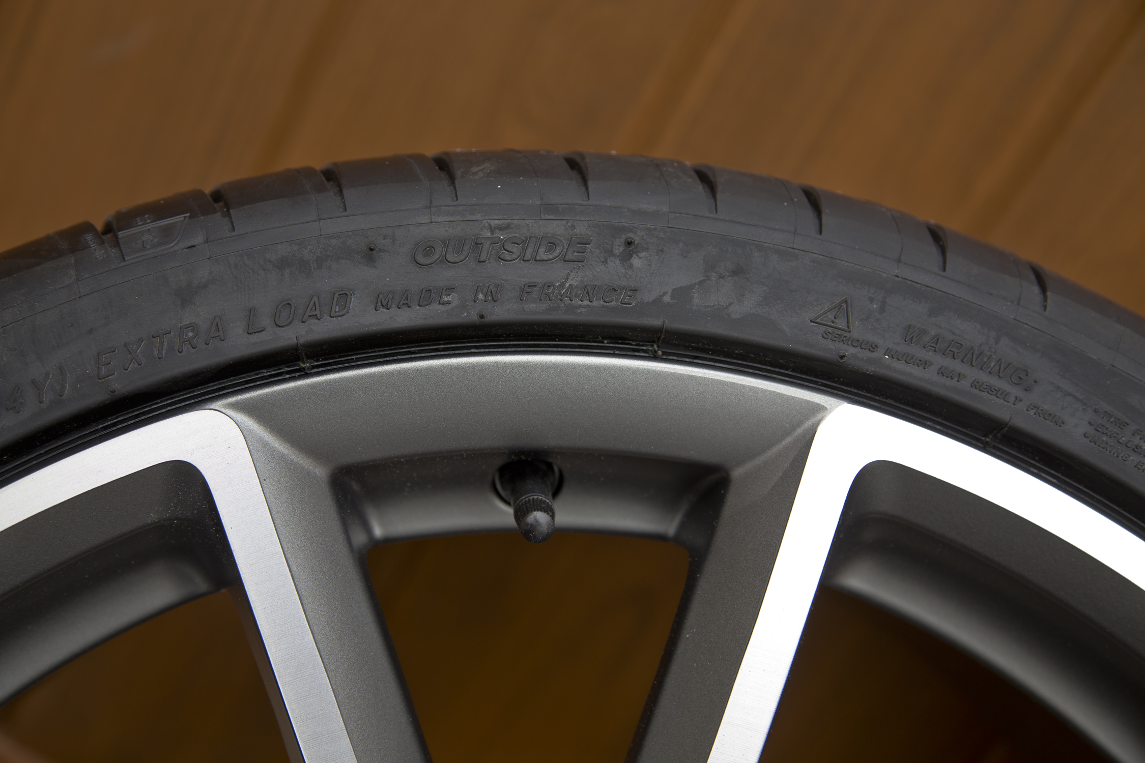

Got the photos and itemised service invoice from pre-sales preparation. 4 rushed powder coated refurbishments. And it's shocking. I'm currently going through a complaint with Audi UK for several things including this. So I've got a case you think? The brakes I'm going to fight for mind you. Not hijacking the thread. Just that rerurbs can fail.
Can see the obvious but also the coating in the tyre wall. Didn't even let it dry properly. The coating inside the wheel only covers the faces too. Not the whole wheel. So it was always gonna come away regardless of the shocking job on the faces.

Re: Strange noise coming from front of car
Factory titanium are the diamond cut ones.
They can only be safely refurbished once, after that. Those will then get painted 100% titanium, silver or any other colour, as there's no longer the material left to paint titanium and then diamond cut the design.
See this image below, the diamond cut process has run out of material for the wheel design, leaving the refurbishing company trying to cover it up.
click image to enlarge:

Hmmmm.Surrey Sam wrote:Factory titanium are the diamond cut ones.
I feel a bit duped. I think I understand why the real deal is so pricey now. Like yours for example.

I did say when you bought the car that they had been painted as that wasn't a factory option.Thundercliffe81 wrote:Ahhhh.Surrey Sam wrote:Yes, standard 'trade' practice unfortunately. V-Spokes were never available in hyper silver from factory, only Rotors but you/anyone would never know that.
I thought these were the 'polished' V spokes? Not the Titanium finish ones obviously. Either way, all 3 branches in the north I've had issues with have been CC'd into the complaint. Ugh. Ya just shouldn't have to fight should ya? I won't go back to Audi. Exotic specialists now. They had the spec I wanted but will be even MORE patient next time.
By the looks of things very badly!
Zooming into your picture I can see why they have been painted as there is no metal left to cut.
As Sam said above and shows in his picture.
