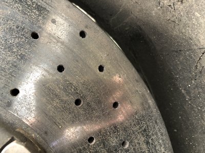

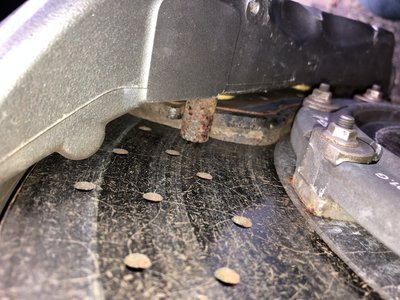

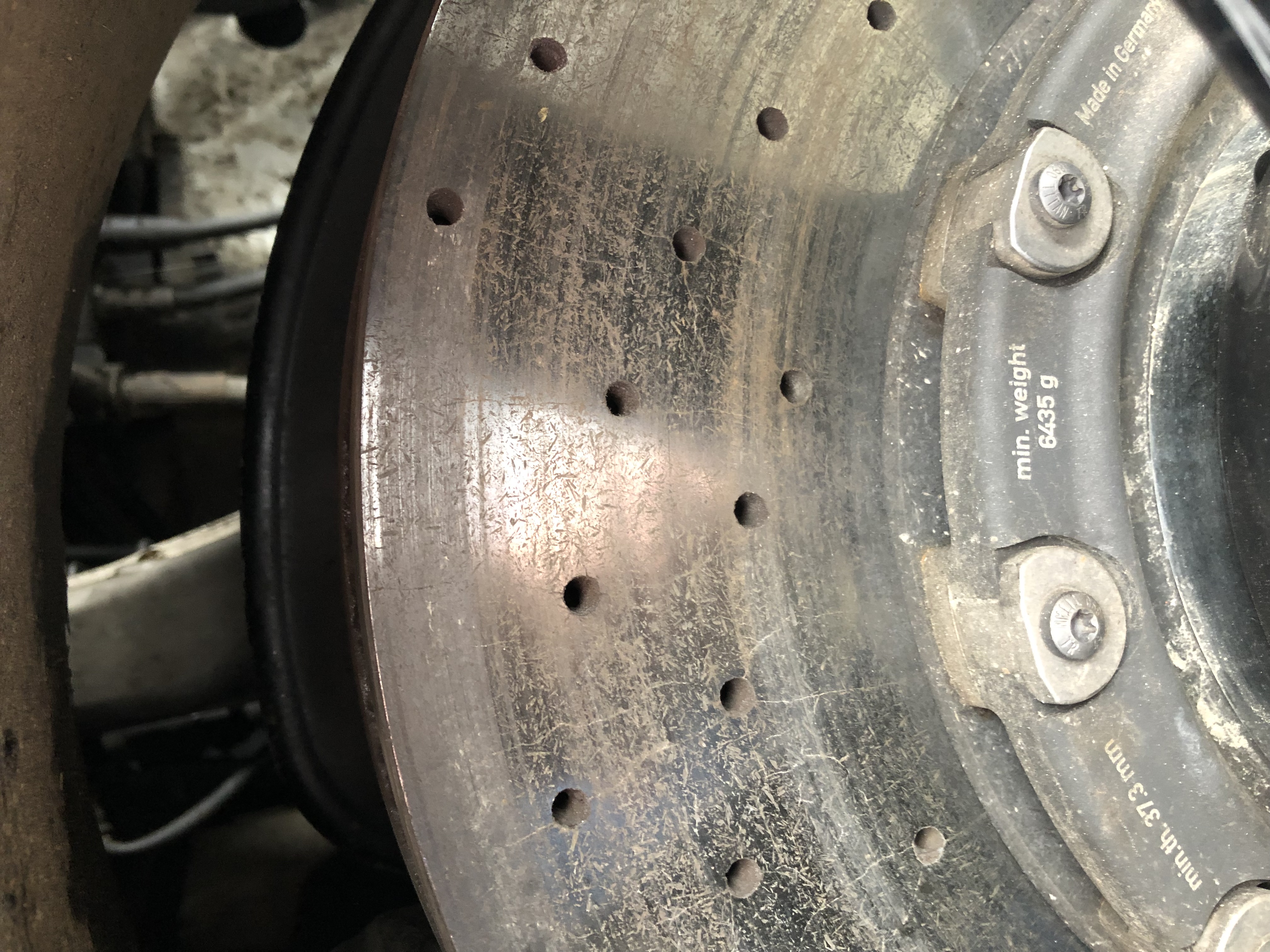

Discs look a bit crazed. Seem like there is loads of life in the disc just not sure I’ve heard the ceramic discs have this effect? Anyone running them and theirs look similar? Post some images of you could.

More images of the discs. They look okay don’t they???

Re: Audi Ceramic
Post by Outtlaw » Thu Jan 17, 2019 11:49 am
Yep they look the same as mine

Re: Audi Ceramic
Post by noddy » Thu Jan 17, 2019 12:08 pm
You can clearly see the ‘wear’ dot, they need to be weighed to check how much content (life) is left in the disc.

Re: Audi Ceramic
Post by Surrey Sam » Fri Jan 18, 2019 1:37 am
Wear rate looks fine. I think some harsh chemicals have been used a fair bit on them though, from looking at the rusty pad carrier and disc bobbins. I'd try to avoid spraying any wheel cleaners/fallout removers/strong APC solutions on to any disc and calliper for this reason alone.
