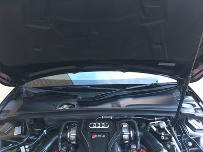

Somebody can take a picture in the morning of the wipers parked position with the bonnet up? I have had the screen replaced and I think the right hand arm is fitted wrong. Thanks.

Here you go

Thanks very much, I will compare with mine. I think the right hand arm is too high as you can see it from the drivers seat in the wipers parked position. I don't remember being able to see it. Tried to adjust myself but just can't get the arm off!

There are two parked positions. When driving and use the wipers they go back to an upper parked position ready for use again, if they are not used they drop back under the bonnet edge. Are they just not going back to the final position automatically. Did the fitter remove the arms when replacing the screen?

Sorted now. lower position on left hand blade was too high. They were removed and have now been sorted. Just needed a puller to get them off.
