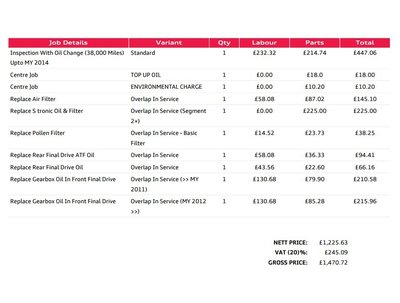

Post by geoffdunk » Mon Dec 05, 2016 6:26 pm
Here is a list of the work, ignore the price, i got mine for a less, this was supplied by another RS4 owner. The front diff oil replacement has also been double up on this list. 2 rear diff oils as one is the diff and the other the sports diff.
The list is for major service at 38k and all the oils changed which is also a 38k job. 38k service does not include spark plugs, that's at 60k.
