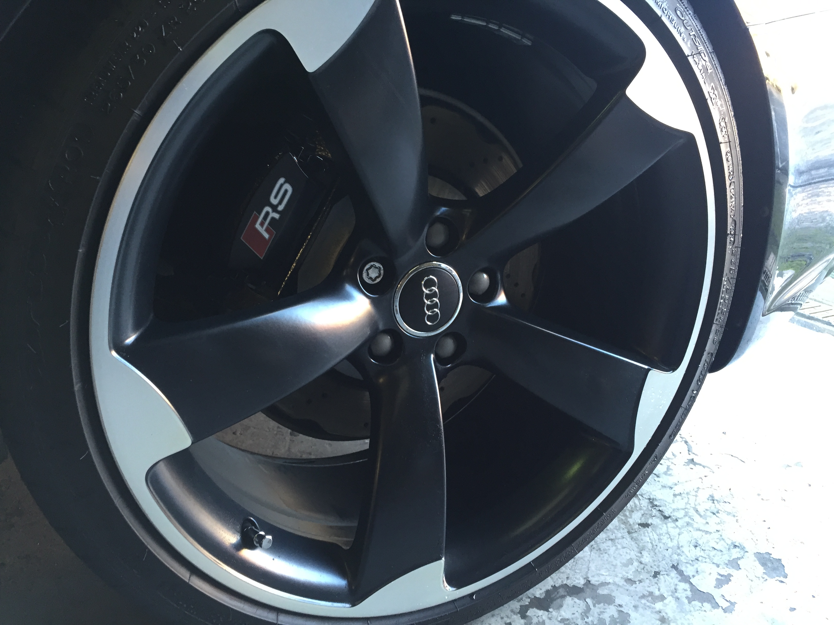

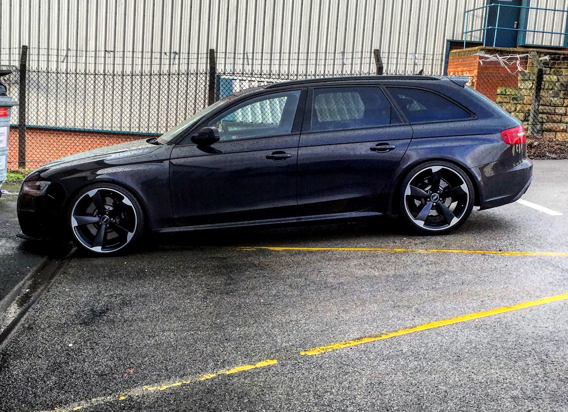

More wheels.
Also fitted the rear caliper RS plates.

Where did you get your rear caliper plates from and do they just clip into place

Stoke Audi
http://www.stokeaudi-parts.co.uk/produc ... 8221A.html
And no, you need to drill into the caliper. Simple to do though.
