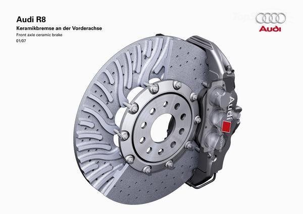

Ceramics have much larger internal vents, so shouldn't retain much water, although you'll always get a bit in the horizontal vanes and some of the funnier shape ones. You could probably get the water out by driving 6 foot slowly down your drive after washing I appreciate this is an out of date R8 disc, but the technology's the same
