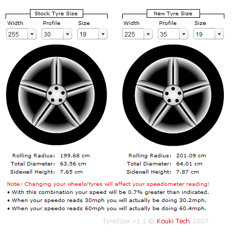

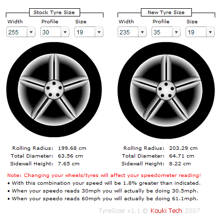

so after an eagle eye viewer spotted the deliberate mistake here are
255 v 235 large front v stock front
255 v 225 large front v stock rear
235 v 225 stock front v stock rear
