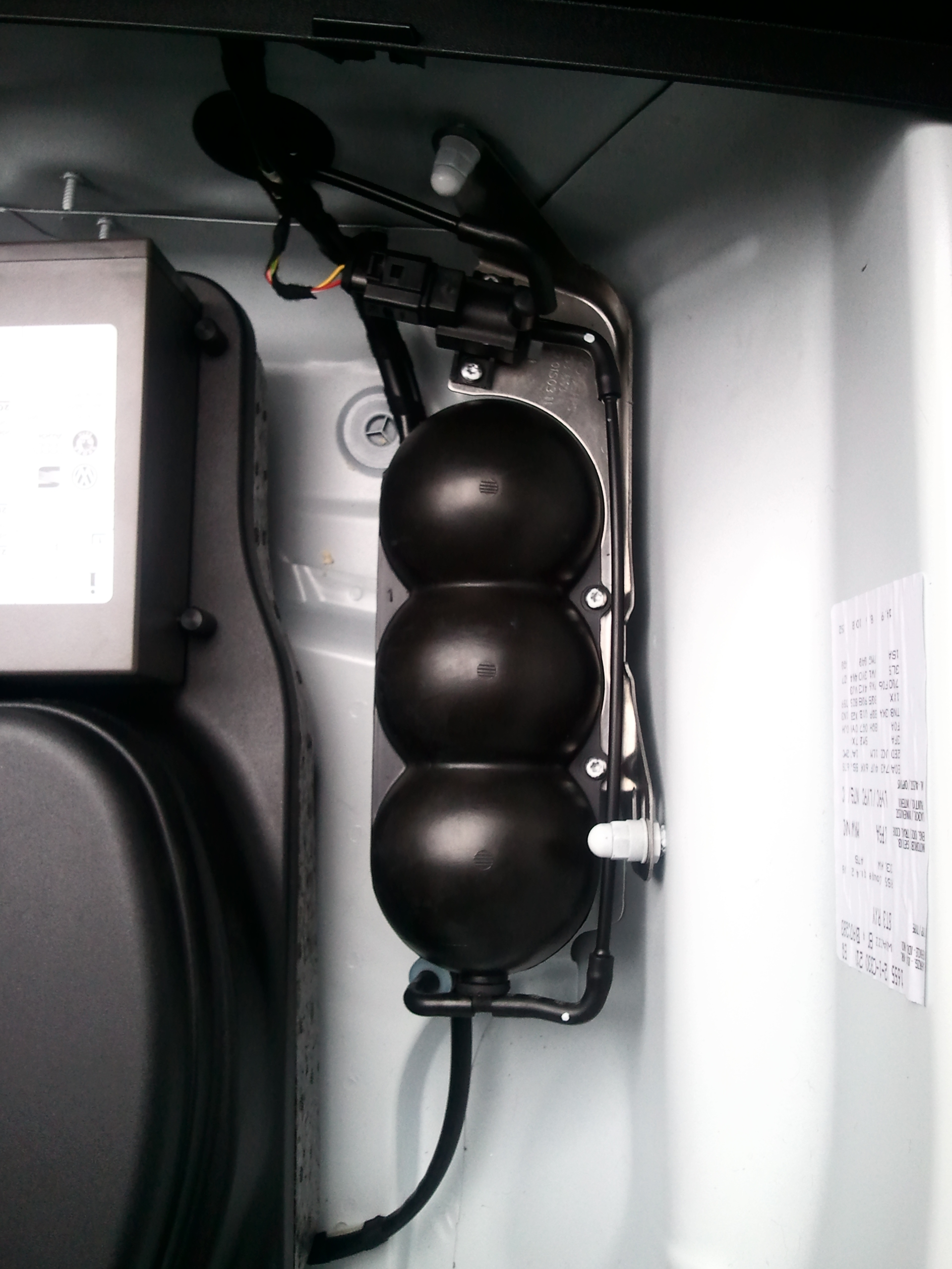

I have driven the car for a week now with this mod done and I can see no detrimental effect to the running of the car. The exhaust sounds great at all times and a little bit of drone in the range 40-50 in 7th gear. I am not suggesting that this mod is carried out but just giving the heads up on whats possible.
If anyone wishes to carry this out lift the mat in the boot and you will find what I think is a vacuum tank at the left side. You will see a small black rubber pipe that enters through the rear metal panel. This pipe leads to both of the flaps. Simply remove the pipe from the connector on the tank and place a blanking plug on to the connector as shown in the picture. I guess anyone ( I mean those with MMI) can also carry out this mod so that the flaps are open at all times.It is my understanding from reading various threads in the B7 RS4 forum that, even in sport mode, the flaps open and close within certain rev ranges.

Thanks SAPG. I got refrred to this forum from A5OC becuase I'm asking the same questions as you! I'm also trying to find out how to do exactly the same thing only by tapping into the electronic control to achieve it ( since it's already there ) I've got the full sat Nav with MMI but still cant set it the way I want it. Anyway thanks for the heads up on how to achieve it mechanically too.
Re: How to tweak sports exhaust??
After further thought. I think the black device with the red and yellow wires, is probably an electronically controlled valve that links ( pneumatically ) the resevoir to the flap contols. Therefore if we can measure what happens ( electrically ) on those wires, when the switch is set to dynamic. ( In one of the two states it's almost certian to provide +12v on one wire and gnd on the other ) we could then emulate that with a neat switch on the dash. (That's assuming some people may want to turn it off ! )

Thanks and you are correct; it could be that this controls th evacuum to the flaps.The black tube that I have taken off (seen in the above picture just above the red/green wire runs right through to the actuator on the silencer and to the flaps. If I reconnect this pipe with the engine running at tick over the flaps close. When I thne remove it I can hear the hiss of the vacuum pump. From what I can glean on the RS4 forum th eflaps open and close and various times throughtout the rev range and this is how it could be achieved. For me I loke them open at all times hence vacuum pipe removal!!

Just done this on mine, how friggin simple?seventeenAPG wrote:I have driven the car for a week now with this mod done and I can see no detrimental effect to the running of the car. The exhaust sounds great at all times and a little bit of drone in the range 40-50 in 7th gear. I am not suggesting that this mod is carried out but just giving the heads up on whats possible.
Just pushed on a cap from a presta bike innertube over one side, then push a bolt into the other and hey presto....mean sound all the time regardless of mode. Will take it out later to see if there are any issues or if I notice the drone. In theory if it's the same as when in dynamic, ie: valve open then the drone should have been there before? If not, then maybe the valve opens and closes during the revs even in Dynamic mode?
