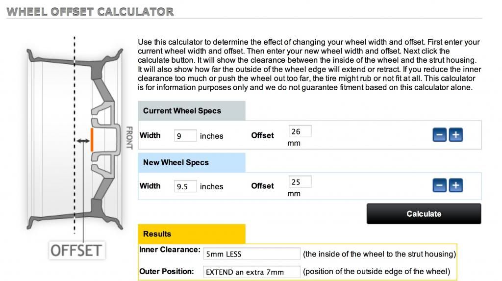

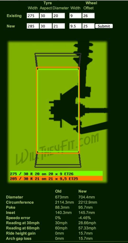

I searched this forum for answers on this specific wheel but found nothing.
Based on the results below, what problems do you guys forsee fitting this wheel to a completley stock rs5 coupe?

You'll prob be alright upsizing the wheels like that altho you may need spacers to push the wheels out. Interesting how the arch gap closes with that combo too.
