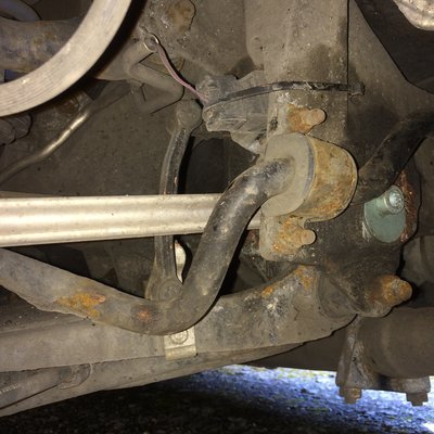

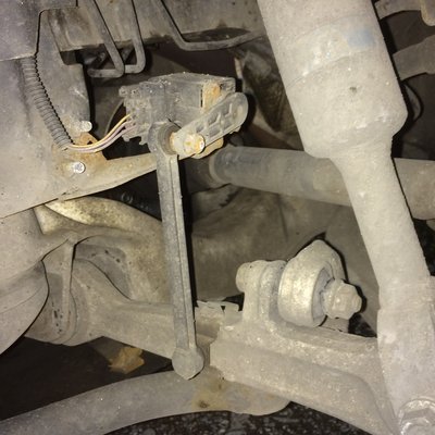

My 2000 C5 S6 is having issues with the auto-levelling xenons after a suspension change (slight lowering). The light is on the dash and despite my best efforts I haven't been able to resolve the issue.
I’ve hooked up VAGCOM lite and tried to clear the error code - this causes the lights to adjust, but then the error code comes straight back. Therefore motors/lights ok.
I’ve checked both wheel arches for sensor arm alignment and they both look ok (see photos) - but maybe I’ve missed something

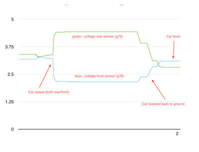

I’ve reviewed the voltage readings from both sensors (both working) via VAGCOM while shifting the car up and down to see how the sensors are behaving. This is where I’m not sure if this is correct - as the car is raised, the front voltage increases while the rear sensor decreases. Before running the test, I assumed they’d both go up, or both go down as the car was raised/lowered.
Lastly, while raised (and within what others have said are the ‘ok’ voltages) I tried to clear the error code again, but once again, it flicked the lights, but error code instantly re-occurs - argh!
Has anyone else had similar issues, or knows whether or not my voltage reports are iffy please get in touch.

Front sensor
Rear sensor

Have you tried the basics mate. ie. Clean the electrical contact and ensure the arms move freely and have greased joints.
