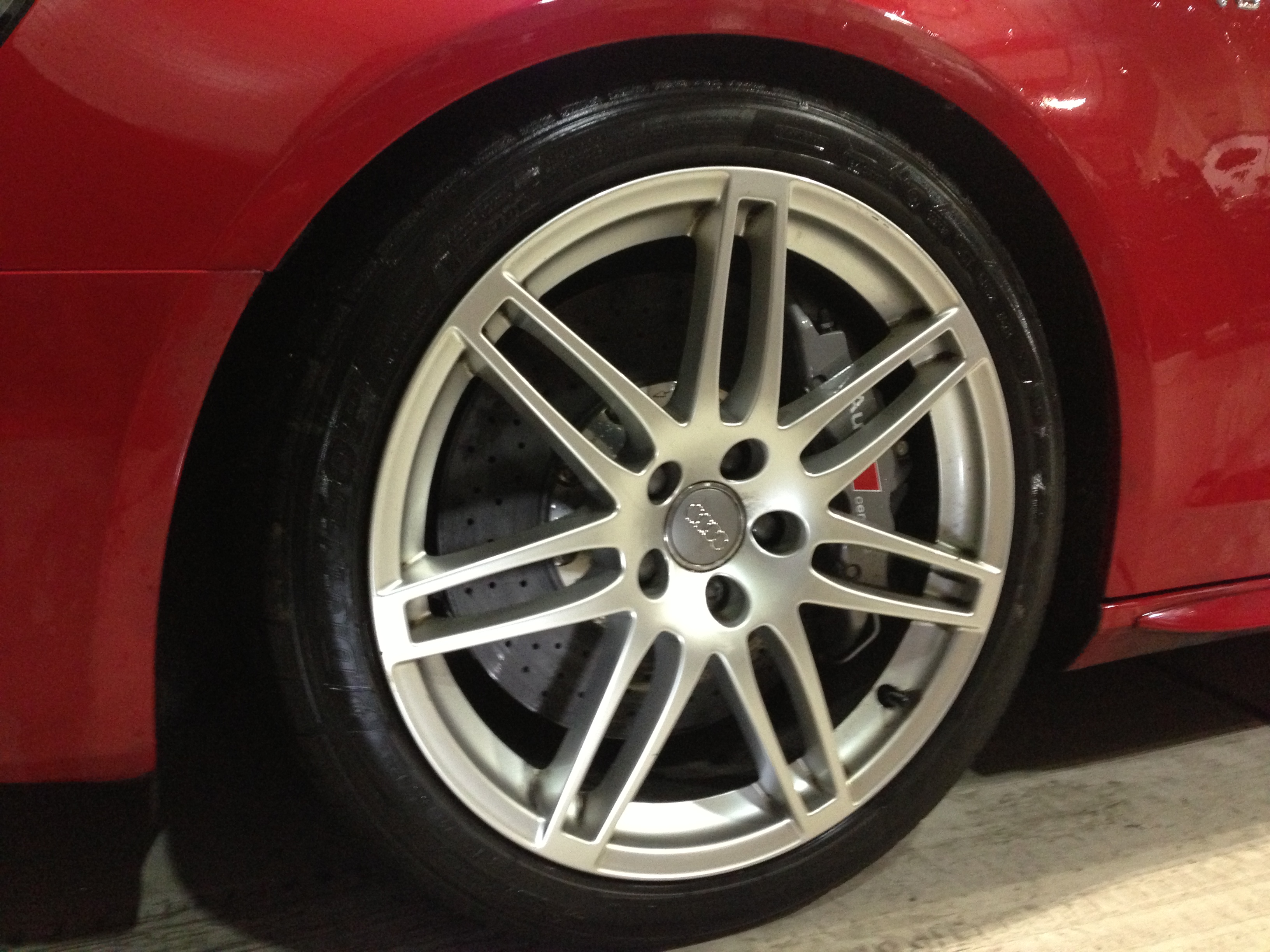

Post by Doug_S2 » Fri Feb 01, 2013 9:14 pm
rs5 will go straight on
rs6C6 setup has custom brackets. prices have proabbly changed as audi are upping brake caliper prices all the time
We have s6 ceramic discs and rs4 ceramic calipers on our S4 now
